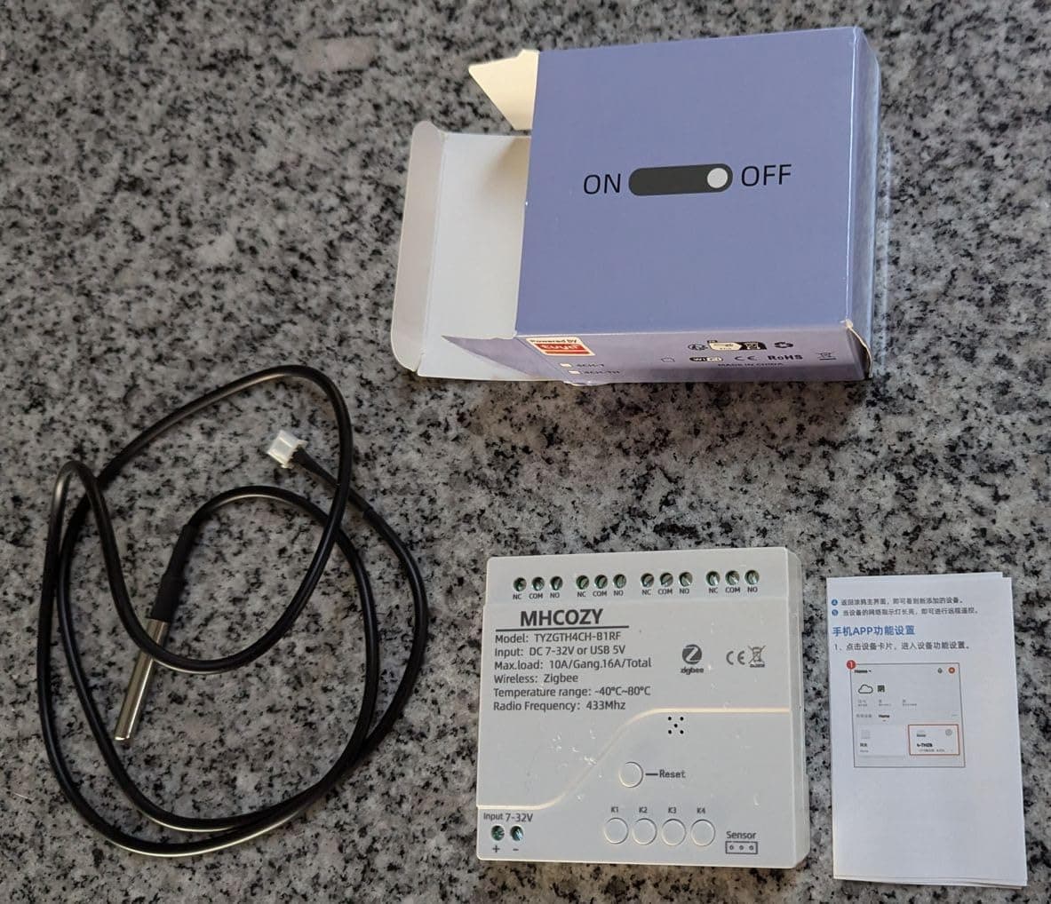

Has any one got this device to work on there System
it just pairs as device.
It works with the Generic Zigbee Multi-Endpoint Switch. It will not do anything with the temp probe, however.
there is a driver from Kkossev, but I don't think he coded the switch part yet.

I got two of these just for the Temp probe's to Mon. my pond air temp and water temp.
Thankyou for your input.
Thank you, this seems to work. It gave me Temp. and one relay to work with.
I'll have to jump through a few hoop's to achieve my goal. but durable.

I believe that you are stuck with Temp and one Switch, or having all four relays work with the multi-endpoint driver. You have to use the multi-endpoint driver to get all four relays to appear as child devices of the parent device. If you don't need more than one switch, you are good.

I really needed the the relay's to work with the temp. probe. See I have a small shed that keep's
my filtration system that keeps running all year round for my fish pond, inside i have a parking
heater that keep's every thing from freezing during the winter. the relay part needs to control the heater on and off witch norm. run's all the time from high to low.
