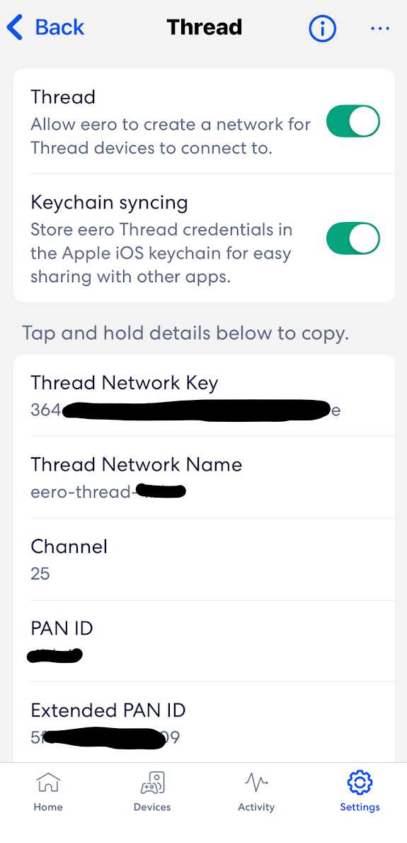

All of my eeros are Pro 6E. I think all but the earliest (perhaps pre-Amazon) eeros have Thread and can serve as Thread Border Routers. I enabled Thread on the eero system ..
and used the Discovery app to see the now four Thread Border Routers and verified that the three eero devices were all advertising the same Extended PAN ID, Network Name, Partition ID, and Thread Version. All good.
I then realized that the eero app has no UI other than shown above related to Thread. Devices have to be commissioned in the Alexa app. My attempt to add an IKEA MYGGSPRAY was unsuccessful. Same for the IKEA GRILLPLATS. At one point, I unplugged the Apple TV as it seemed to be seizing the new devices, but I might have been imagining that. Still no joy with either IKEA device.
