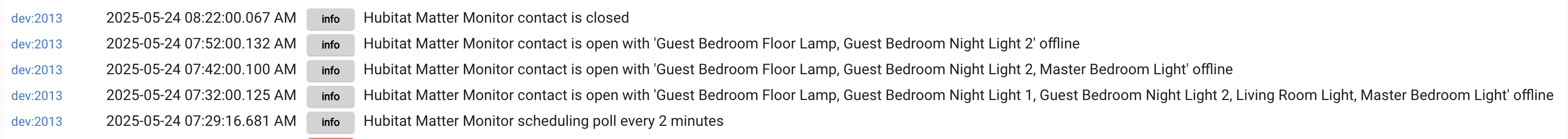

I built a quick driver to monitor matter and alert me of stuff...

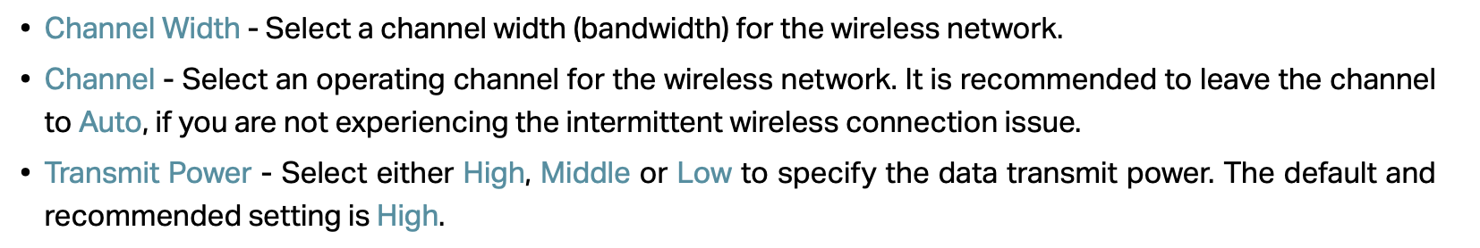

@user4117 - here's a screenshot of the relevant portion of the AX 6000 manual, along with some suggested changes:
  1. I recommend setting the 2.4 GHz channel width to be 20 MHz, and 5 GHz channel width to be 40 MHz. Do not set the 2.4 GHz channel width to be 40 MHz.
  2. Do not leave the 2.4 GHz channel selection at Auto. Choose a wireless channel that will not interfere with Zigbee and Thread. Please read this article on WiFi, Zigbee, and Thread coexistence from Silicon Labs.
  3. Set the transmit power to be "Middle" or "Low". On my Unifi mesh, I set the 2.4 GHz transmit power to be low.
