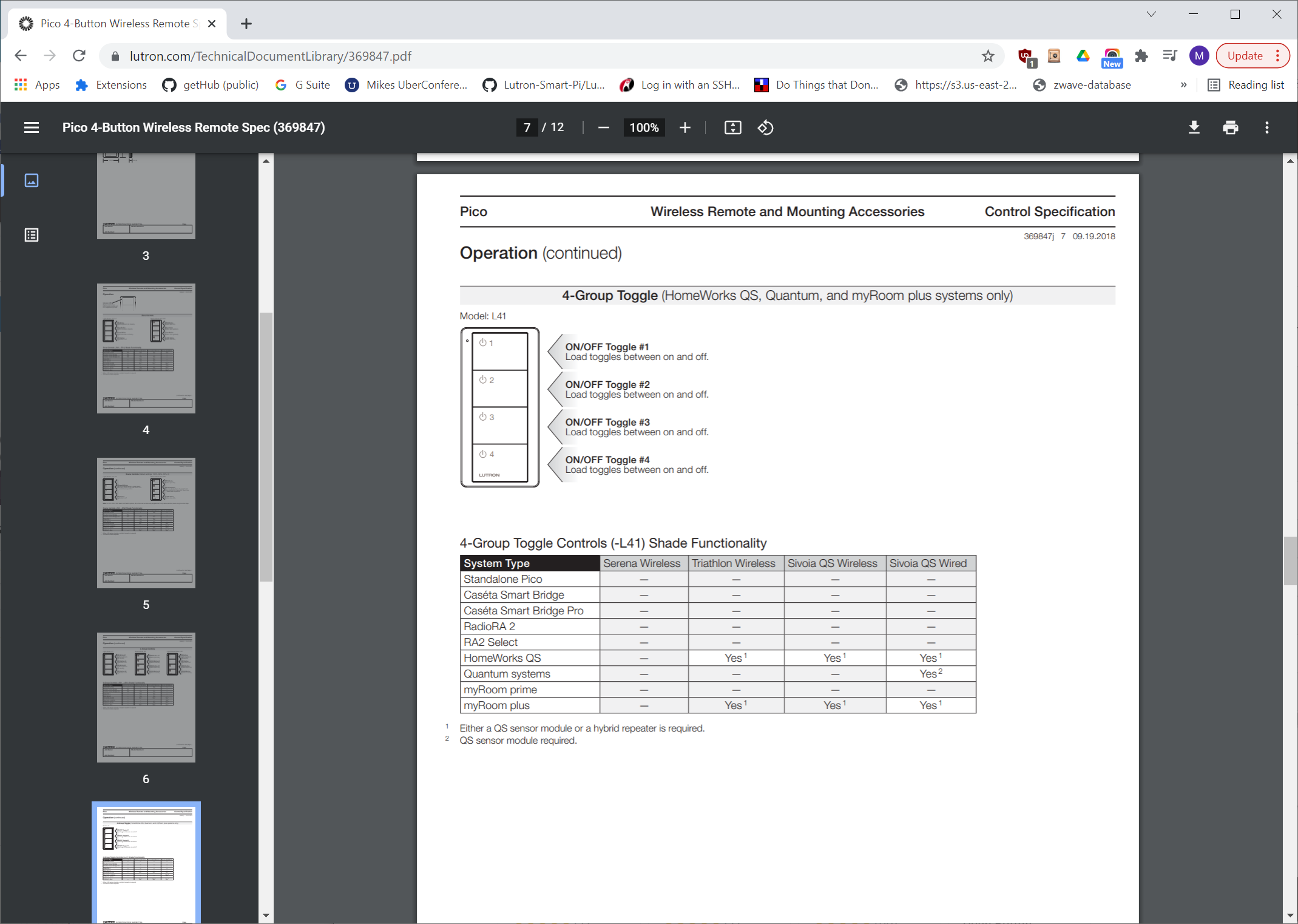

I've found a few different Pico product numbering guides, like the one shown here https://www.electricbargainstores.com/v/vspfiles/PDF_spec/Lutron/pico/pj2-4b-spec.pdf. Beginning on page 4, there is a table in the center of each page that shows system compatibility. The first column in these tables contains "Caseta Smart Bridge Pro". And on page 7, for example, this table appears to say that these Picos are not compatible with the Smart Bridge Pro. Page 7 is actually the button configuration that I want, and I have found a few for sale, but I'm not sure they'll be compatible with my HE and Smart Bridge Pro2 setup. So my question is: "Are there some Picos that are not compatible with my Smart Bridge Pro2? Specifically, can someone confirm that the PJ2-4B-GBL-L41 Pico will work with HE and the Pro2?
I think I've found an answer to my own question in this discussion: Lutron PJ2-4B-GWH-P02 Pico Setup(Lutron Keypad or Pico?). The last 6 digits of my desired Pico are irrelevant. The referenced discussion shows that PJ2-4B Picos work.

Did you ever find out if the L41 Pico (4-button toggle) pairs with the Pro bridge and HE?

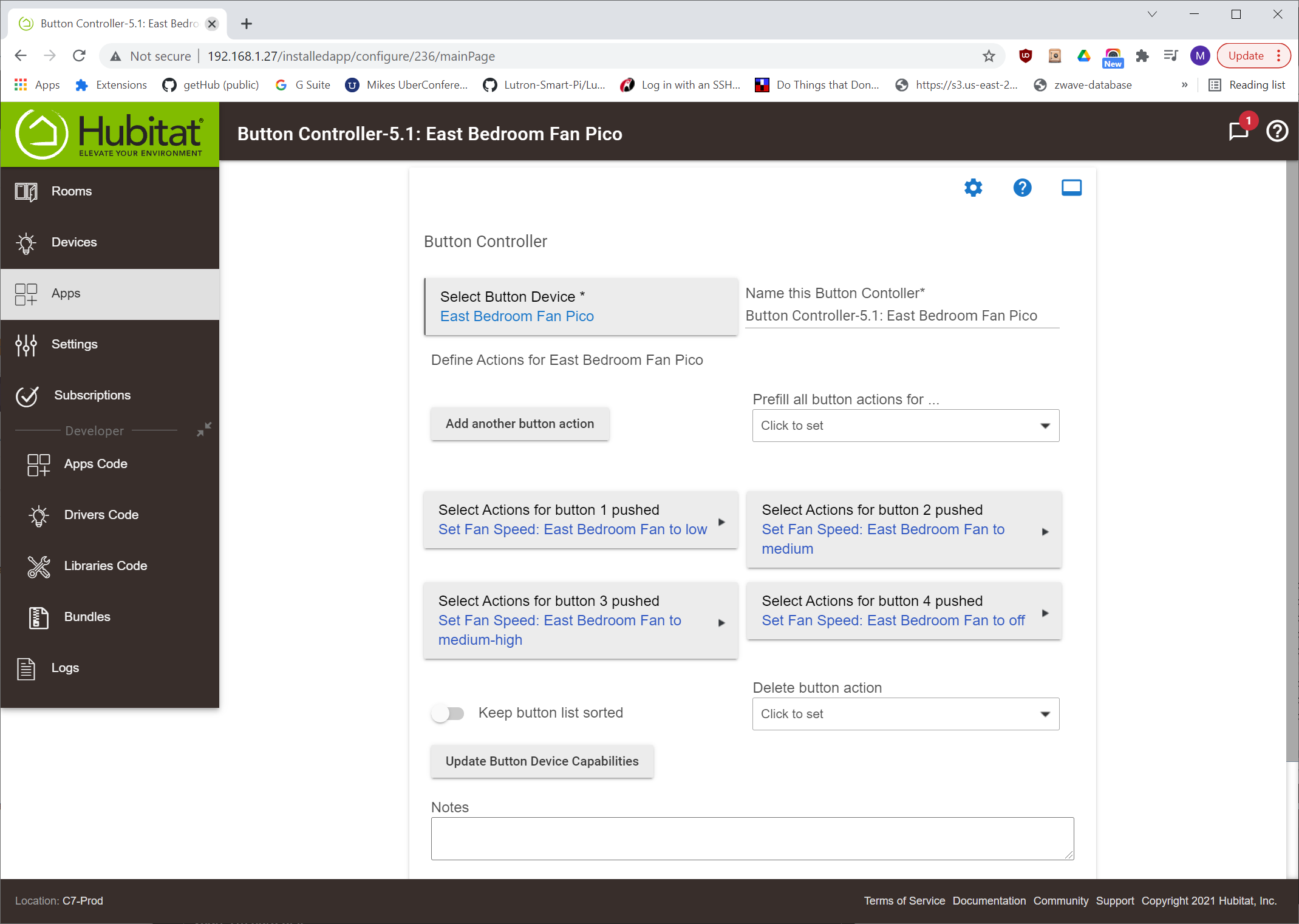

I can't imagine it wouldn't work, I have several 4 button Picos that I use with Hubitat.
Now I can't say what if any functions that Caseta will support directly, meaning I don't know if you can configure this pico to control devices in the Lutron App or not, but I do know that the 4 button Picos can be included to the Pro Bridge and that these are available for programming in Hubitat after being added to the Lutron Integration and the button count updated in the device driver (default is 5 buttons).
but specifically the PJ2-4B-GBL-L41, the model that Lutrol warns is not compatible with Caseta Pro or RA (only homeworks)?
yeah, i'm sure of it...
these don't work with Caseta either...
and yet I'm using it here
If i attempt to configure it in the caseta app, it thinks its a standard 4 button non favorite dimmer pico
This is the model I am looking to use, thanks for confirming it!
I’m not sure what Lutron support is like but it’s really a matter of the pico being compatible with the bridge pro 2. I would think that if it’s compatible there it should be compatible on HE as the function is from bridge to pico not HE to pico. They must have a supported devices list somewhere.
A quick Google search of the Pico part number listed a few posts above, PJ2-4B-GBL-L41, shows the following on Lutron’s site…
https://www.lutron.com/TechnicalDocumentLibrary/369847.pdf
