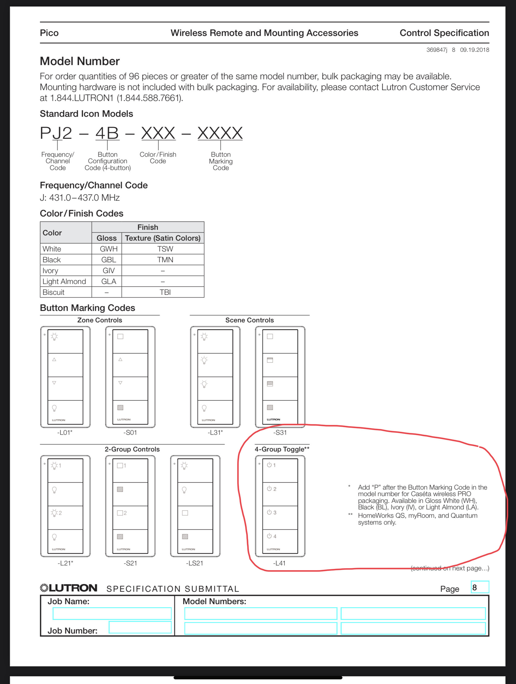

Thanks, but the model you are posting the spec sheet for is the PJ2-4B-GWH-L01.
I see what you mean…but I’d bet it’ll still work. Do you already own this particular Pico? If not, why not just buy a different model?
I would like to use it in a room that has 4 different already installed lights (lamps, ceiling light, reading lamp) and have a single wall mounted control that can toggle each one on and off individually. above, mike.maxwell confirmed that it does work.
