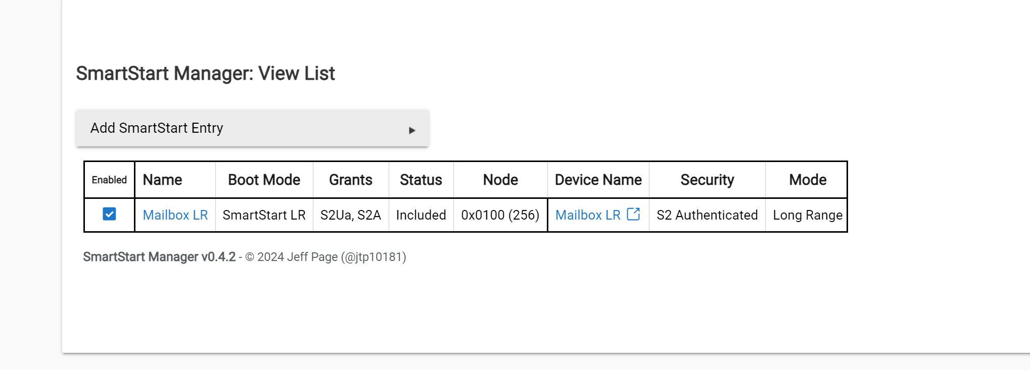

@kahn-hubitat Just remember, in order to pair as LR you need to use smart start or it will just pair as normal z-wave. Also remember that LR devices don't participate in the z-wave mesh so they are not repeaters.
what a buzz kill. zooz zse41 paired pretty easily with smart start.. but doesnt work even half way to mailbox, let alone inside the metal mailbox where the samsung multisensor v4 zigbee works fine!
so much for 1.2 mile range for LR devices..
i opened a ticked with zooz. they need to know the specs are bs on this .. i cannot use this sensor.. see if i can get a refund
Did it for certain pair as LR?
yep checked that before testing ie

interesting in response to my own question apparently it DOES matter where you pair a LR device.. zooz got back to me and i had hope.. see below.
however it would not pair at the location or even exclude even after a full reset of the device...
and as far as i am concerned when the device doesnt get a response it should automatically switch modes anyway.. i just think these devices firmware is not up to snuff.
Thank you for those details!
Long Range in the US currently has two power levels for ZWLR: matching the RF transmit power to the typical power supply of the intended application. +14dBm is often utilized in battery-powered devices, where even the 41mA current can strain low-cost batteries. On the other hand, the +20dBm is better suited for mains-powered devices, maximizing the range potential. ZWLR employs dynamic RF power, meaning that for nodes situated close enough to the hub, only sufficient RF power is utilized to reliably communicate with the controller. Would you be able to exclude the sensor and re-include it from the target location, to ensure the correct RF transmit power is utilized?
