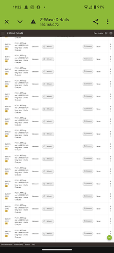

I got this app [APP] SmartStart Manager for Z-Wave (Long Range support) adding tons of ghost entries for the zwave LR device. How do I stop this? I followed all the instructions.
  • How many LR devices have you actually tried to set up using SmartStart in the mobile app?
  • Do you have any entries in your Z-Wave Details page for your LR device(s) that aren't ghost entries?

@hypnosis4u2nv Also power down the device you are trying to add, so it will stop trying to pair, it is not working obviously. You could also disable it in the Smart Start List view so the hub will not try to pair it again until you enable it. Once that is done shut down and unplug for 30 seconds then boot back up, that may clear all of those nodes out of there.

Rebooting the hub isn't the same as shutting it down and pulling power from the hub...the Z-Wave and Zigbee radios only clear if you shut down and pull the USB power connection for a bit as noted above. I think you understood that, but just wanted to make sure.

Would be much better if you could get screenshots from a wider screen, tablet or PC/Laptop.
Looks like though you have two LR devices paired but only one is showing on the details page? I would shut down, unplug and reboot again see if that clears it up.
I see 0x0101 is matching up. But the other one my app is showing 0x014F, but that's not in your details. Also the security is blank in my app, which I would guess means that node was not in the z-wave details endpoint I am querying.
Clearly some lingering bugs in the Z-Wave details screen with this LR update.
