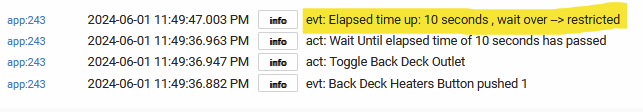

Hello, I am trying to make a simple rule where a button is pressed, an outlet is activated, then after X elapsed time the outlet turns off:
When I run the rule, the outlet does get activated, but then does not turn off after elapsed time. The logs seem to understand what should happen, but when it comes time to turn off the outlet, it says that it is restricted:
I don't have any restrictions, nor any other rules attached to this outlet:
Any idea what "wait over --> restricted" means? Why it would be restricted? And how to unrestrict it?

app:72024-06-05 10:20:17.396 AMinfoevt: Wait time is up: 30 minutes , wait over --> restricted
app:72024-06-05 09:50:17.360 AMinfoact: Wait 30 minutes
app:72024-06-05 09:50:17.298 AMinfoevt: Toilet Room Fan switch on
app:72024-06-04 01:02:17.362 PMinfoevt: Wait time is up: 30 minutes , wait over --> restricted
