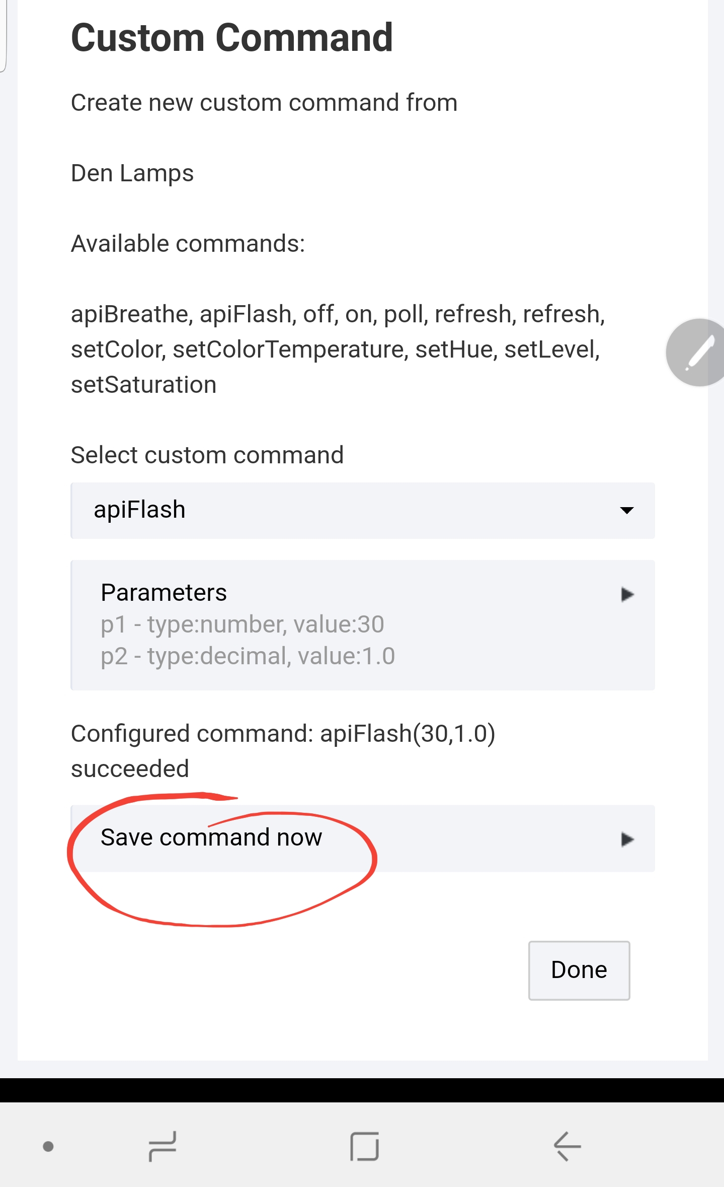

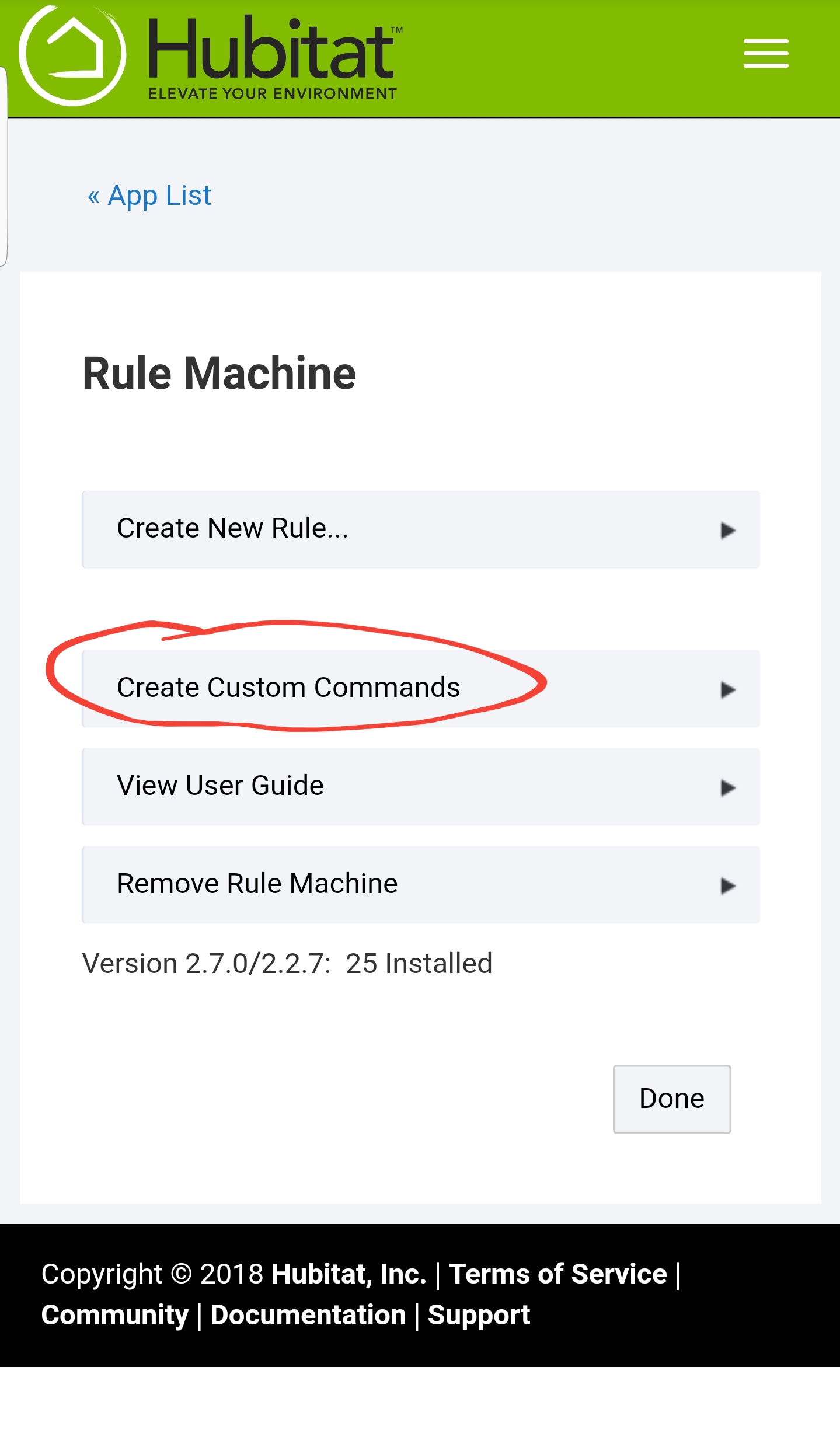

Well in case you change your mind...I created a custom command in the RM app.
apiflash(60,1.0)
The first parameter is an integer that represents the number of cycles.
The second parameter is a decimal that represents the total time of the cycle.
So the above would flash 60 times with each flash taking 1 second to complete...flashes for 1 minute.
Increase parameter 1 for more flashes. Increasing parameter 2 would have the light flash slower and decreasing would make the light flashes faster.
You can also do an apibreathe() with similar parameters to make the lights fade on and off (breathe) instead.
@stephack Hey I appreciated what you are doing can you explain how you did that or did you change the app? Thanks
I didn't make any changes to the Lifx driver. The apiFlash command is already part of it. In Rule Machine there is an option to Create a Custom Command. This let's you use commands that are part of third party drivers in Rule Machine. Give it a shot and let me know if you have any specific questions.
