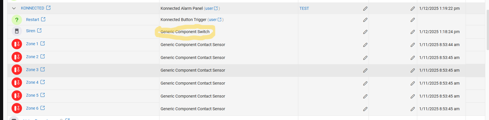

  1. I have successfully completed the firmware for all the inputs and outputs using the Konnected mobile app and am using an Auxillary Output to use for a Door Chime:
  1. I can test the Door Chime Piezo buzzer by pressing the PUSH button within Hubitat on the Commands tab, so I know it is working correctly:

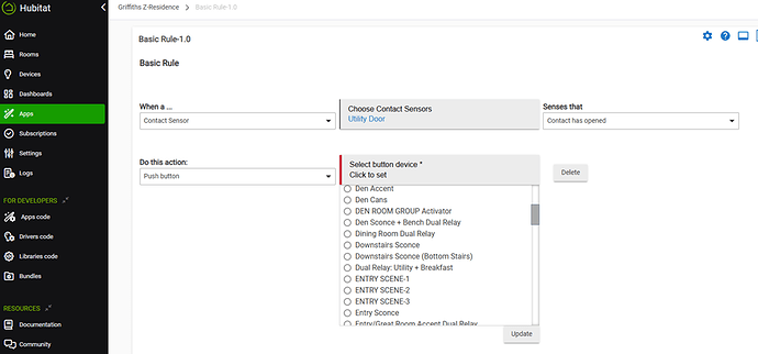

  1. I want the Door Chime to work when the Utility Door Input is seen as “open”. The problem lies when I try to create a rule within Hubitat where I cannot find the “Door Chime output” listed within Hubitat. I have tried creating this rule as both a “Basic rule” as well as with “Rule Machine” with the same results, i.e. neither shows me the Door Chime Output as an option, even though it is clearly there in the list of devices:
In making changes to the device type in the Konnected firmware, I have discovered that the only device that shows up as an available device in Hubitat as an ACTION item tha can be used in a rule is a Switch On/Off:
Any outputs on the Konnected board that are set up with any other type of output, e.g. momentary, that use a Konnected Button Trigger type do not show up in the list of ACTION devices where they are be used in a rule:

However, it is not the "trigger" that is the issue (I can see all the Konnected INPUT devices (in the screenshots above I am using the Utility Door contact sensor as the trigger device. The issue is the Output device (ACTION), i.e. the only output devices listed in Hubitat are those that are On/Off Switches - it is not showing any of the momentary output devices - even though they are listed in the device list:

When I create a new action for Control Switches, Push Buttons -> Push Button, I get a dialogue box with "Push a Button", not "Switches to turn on. "
Something is funky with why it is asking for a switch when "Push button" was selected. So maybe an issue with Rule Machine?
Of course, I'm assuming "Push button" was in fact selected since it is not in the screenshot.
Correct. I'm trying to get our Momentary button device to show up in the list of Push a Button.
Not wanting to get off track but since we have your attention here @nate could you tell me what these konnected log warnings mean and do they require attention.
My question was why Rule Machine is asking for a switch and not a button in the screenshot, IF you chose Push button. I'm not seeing that. It just looks like switch is chosen in the right side menu that we cannot see.
This shows I can select a button when choosing Push Button.
This shows when I selected "Turn switches on/off"
When what is posted in this thread is this, not asking for a button, because it looks like switch is chosen in the menu I can't see, unless it is an RM issue that I am not having.

  1. When you set up your devices in the Konnected App you get to choose what device "type" of device you are wanting to use for the output, i.e. a Momentary Device, Switch On/Off, etc.
  2. I set up several of each "type" in the Konnected App firmware when I discovered the problem with the screenshots I posted at the beginning of this thread.
  3. When you go to RM to create a rule (in my case I want the Door Chime output to work when the Utility Door is opened) you only get to see the option to select ACTION devices that are set up in the Konnected firmware as Switches On/Off - the devies set up as momentary devices are not populated in the list even though they are there in the list of devices. In this case the Door Chime Output in Image #1 was set up as a "Konnected Button Trigger" momentary device. Image #2 shows the device is there in the list of devices and I can turn the Door Chime on manually by sending a PUSH command to the device. However, as shown in Image #3 - this device does not show up as a ACTION button device when I am trying to create a rule.
  4. If I set up the device as a Generic Component Switch in the Konnected firmware as shown in Image#4 (Door Chime #2) - then the device is available as a switch to turn on as shown in Image#4 which reflects Door Chime #2 is an available switch to turn on.
  5. Image #5 shows Door Buzzer #3 that was set up in the Konnected firmware as a momentary button - which yields the same results as Image #3 where the device is not available in the list of devices in RM.

I understand all that, but can you explain the screenshot I was referring to in my post? It looks like you selected switches instead of a button, and then you are saying none of my buttons are showing up in this list of switches I selected for the action.
I just don't get why you show a of screenshot the switch list when you are looking for a button.
I thought I had explained that:
Door Buzzer #2 and Door Chime #2 (in the image you reposted) are both set up in the Konnected firmware as "Switches to turn on" - not buttons. They are shown in that screenshot as examples of Konnected output device that do show up in the list of ACTION devices, whereas button devices are not showing up in the list of devices.
I did not just show a screenshot of a switch list when I am looking for a button.
The verbiage associated with the screenshots clearly denotes why a screen shot of each TYPE was posted. If you go back to the very beginning of these threads and look at Image #3 it clearly reflects an example of a Konnected devices that is set up as a button, and also clearly reflects that the Konnected output device Door Chime Output is not populated in the list of button devices you can select from:
Hence the question @nate reiterated in his response that he is trying to figure out:
Why are outputs on the Konnected board that are set up with any type of output aside from a Switch On/Off type (that use a momentary contact (button) using a Konnected Button Trigger type) not showing up in the list of ACTION devices where they are available to be used in a rule.
