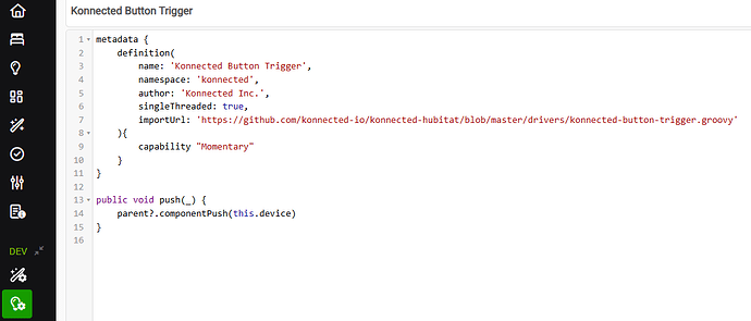

Here is a an updated version of Konnected's driver. Simply replace the one from Konnected with this one, and make sure to click SAVE on the Preferences page. Clicking save will initialize the "numberOfButtons" attribite properly.
Afterwards, you will be able to select this device from any Hubitat App that supports "PushableButton" devices. Be sure to enter button number "1" (no quotes) for the push() command.

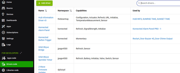

Then I assume I replace the existing driver found under Drivers Codes, Konnected Button Trigger - correct?
In other words in this instance I'd open the Konnected Button Trigger type that reflects it is being used for "Restart, Door Buzzer #3, Door Chime Output" and replace it with what you have furnished. Correct? The existing driver is the following:
That said, I'm not at all familar with the "Restart" device that Konnected automatically created that appears to use the same driver, so not sure if this work-around will impact the features of that button.
Nice fix up! After all that, @user7221 pointed out to me that by just adding the Switch Capability to the driver would have allowed this to work in RM as was, as push() command would be available when the momentary button is just selected as a switch.
Yes, simply copy and paste the code I provided over top of the existing code, and then click SAVE to save the new driver.
Then, open up one of your Devices that uses this driver, select the Preferences tab, and then simply click SAVE as shown below.
You then be able to select this device in RM and use its "Push()" command, passing in a "1" as the button number.

Problem solved using the updated Konnected driver @ogiewon provided. I am very much appreciative of the help from everyone in this regard. It seemed like such as simple initial question and I was really stumped on a solution, so I could not have got this working the way I wanted without all your help. Thank you very much once again.
@nate - this is 100% funtional. I guess you need to decide how you want to move forward for when the next person asks how to do the same thing :slightly_smiling_face:.
Thank you @ogiewon for the tip (also, great to hear from you!).
Adding the Actuator capability by itself didn't do it, at least for the Basic Rules app. Maybe Rule Machine is a bit more flexible but I think @b.griffiths1207 was originally using Basic Rules for his desired automation and I want to make sure it works for the the basic and advanced cases.
You gave me an idea though and I added the PushableButton capability to the device driver and that seems to have made it appear under Push action! The only tricky thing was defaulting it to numberOfButtons = 1 because apparently the PushableButton capability supports multiple buttons on a single device, whereas Konnected treats each device as a singular button/entity.
Here's the updated driver code. Does this look reasonable?
