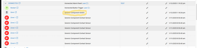

Is it possible to make this switch with an enable auto off option. I really need a momentary switch that will work with this child device. I was told the device that is labeled button trigger will work but it does not.

@chrisbvt It works. Thank you so much. I do not know anything about writing code. Would you mind putting 750 ms in there. Konnected support has been no help. I have a pro board on the legacy drivers that has worked great and was testing a older wifi board before flashing my pro board. I use the momentary for a keyswitch.

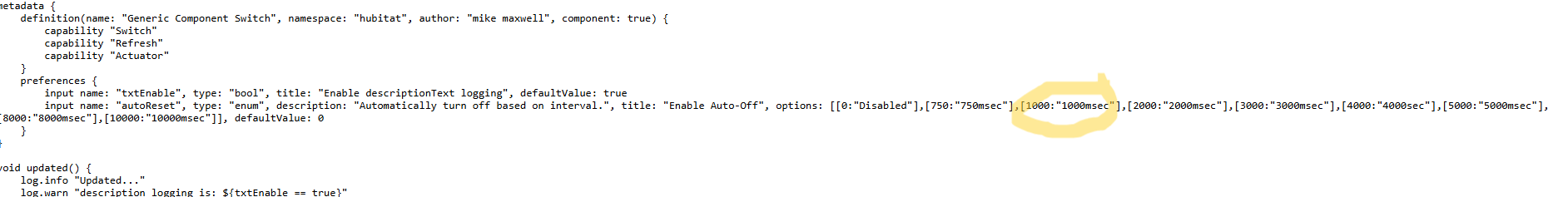

@chrisbvt Thanks, a lot, really appreciate you doing that. It works perfect from what I see so far. If I were to add some other times would I just add them in between what is highlighted?
Yes, it is pretty easy. Just add a new bracket section and a comma to separate it from the next one. You might want to remove times you do not need as well. Whatever you change will just appear in the driver preferences after you save the driver code.
The two things in brackets are the actual number to use, and what to display in the menu, so you can change how you want it displayed as well.
