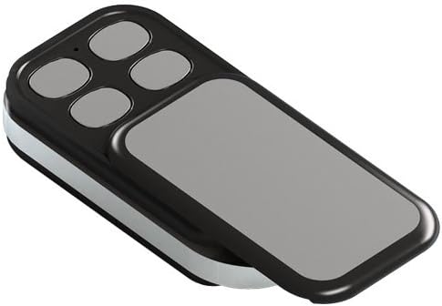

How about this mate?
It’s also in the US I believe. I have one, works very well.
How are you using it with HE ?
Is it fully compatible with hubitat? Does it need additional driver or is it natively supported?
Community driver mate.
My mother in law is using it as we are away.
She arrives (HSM is set to delay for one minute), she presses “home” and scans the tag. Then when she leaves, she hits “away” and scans the tag again. HSM is armed one minute after
I also have the cleaner use it, even if I’m home so it changes to “cleaning in progress” and stops a lot of automations whilst she cleans (like when she cleans my dash tablets, she’d set all sorts off if I didn’t
Yeah community driver.
How are you linking the RFID to HE ?
It’s Z-wave, only the use of the tags is RFID.

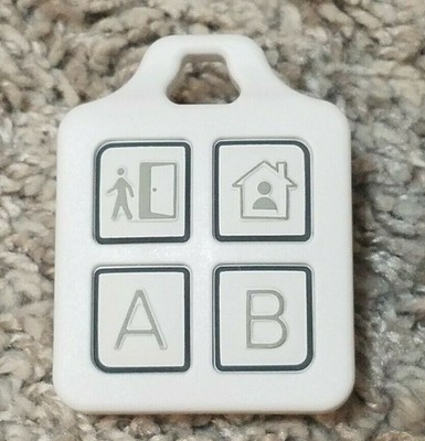

The Iris v2 key fob is fully supported by a built in driver. And available on eBay for only $20. This one is a 4 button controller.
Watch out because eBay has a bunch of gen 2 care pendants but only gen 1 (alertme.com) care pendents are supported by the built in driver.

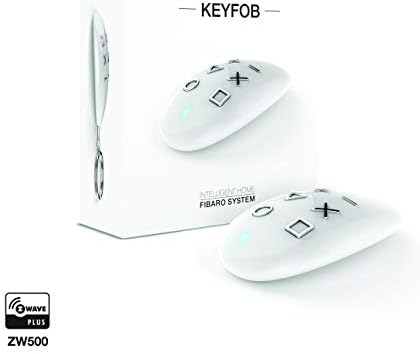

The Fibaro keyfob is z-wave and has a lot more buttons...but it's a lot more expensive. Also supported by built-in drivers. This one is a z-wave button controller.
