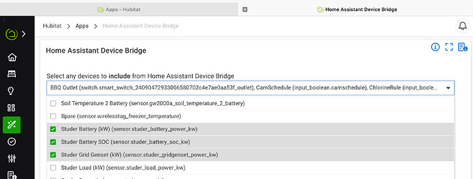

Hi, I have ticked the 3 target devices in HADB (see screenshot) but only Studer Battery (kW) & Studer Grid GenSet (kW) are showing up as HE devices (power meters) The 'SOC' one. (state of charge, in % in HA) is absent.
Has the charging state changed since you clicked on the SOC? Devices will not show up in HE through the HADB until their state changes. If it is possible change the state of charge, close the devices list, and reopen and see if it appears in your device list.
Yes, the value is changing all the time as it's the charge level of my house power batteries.
It is a sensor. All sensors are supported by HADB. If it is not a specific one it comes through as unknown sensor but the value is there and it is usable.

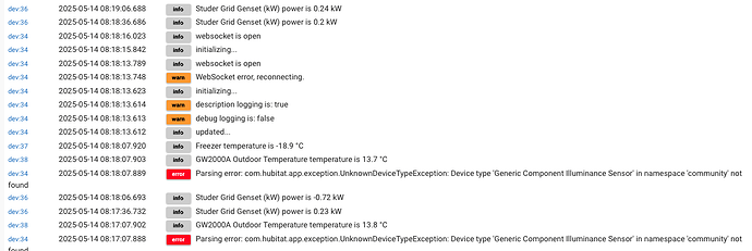

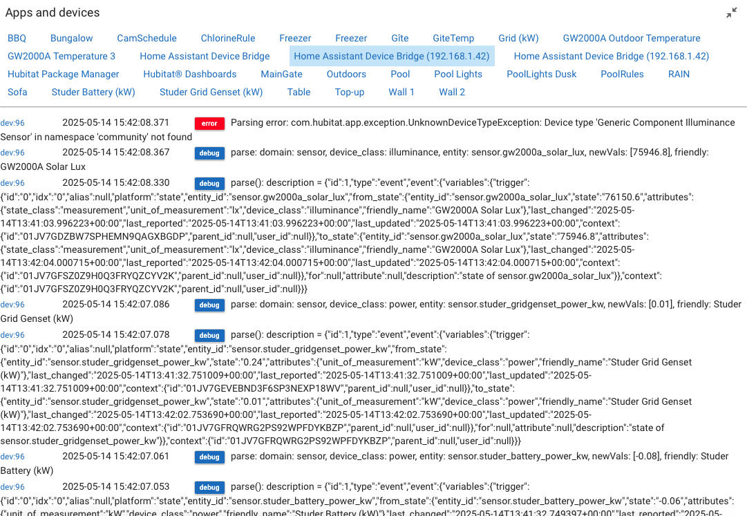

I'm a bit confused here, sorry: it's good that HADB should support all sensors, but aren't also my Ecowitt weather entities sensors? - these are also 'tickable' in the HADB device list but never show up as devices (rainfall, windspeed, etc), and previously it's stated that 'Ecowitt weather sensors are not supported'. I'm not sure where to find the 'HADB parent device debugging log' - I have taken the main log screenshot (and have activated the debug log in the HADB device menu). It seems that I have a repeating parsing error which I guess is the Battery SOC sensor trying to connect.
You are missing a component of HADB. We should first fix your installation. How did you install HADB? Manually or through HPM?
If the HA Ecowitt integration uses sensors instead of wheather entities then HADB support it. From the log snippet you shown, I can see your Ecowitt gateway is reporting outside temperature and illuminance as sensors. It possibly report other stuff but while your HADB installation is defective, those might fail to show also.

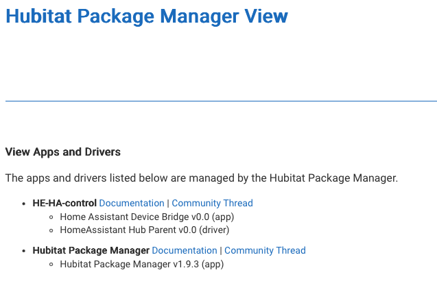

Thanks - I also just found a video on this subject: I now have the HPM installed and also the HA bridge, but now I'm stuck again... I don't see anywhere to add the IP address of my HA Raspberry Pi and set it all up.
Screenshot 2025-05-14 at 14.41.16
It's a common misunderstanding of what HPM does.
When Hubitat adds an App to the hub, it's ON the hub. Community created apps are not. You have to add the code to the hub. Once the code is ON the hub, then the process of using that code is the same, Hubitat created or Community Created.
HPM is a tool to add code to the hub. That's it's primary use.

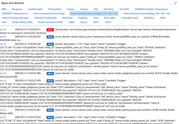

The 'Add User App' didn't come up with the set-up menu for the HA IP address & Token on my Mac, but it has done on my iPad. The result seems to be rather a mess (see the screenshot) - slowly the devices are repopulating as their values/state change, but I still don't see the important ones (%battery SOC and solar lux) and I've ended up with the same devices as I had previously using the manual configuration - but this time I have more log errors.
It is. You have 3 instances of HADB. Remove them then go to "Add user app" as @csteele pointed at to add only one copy off HADB.
