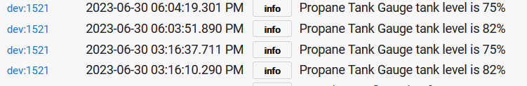

Got a couple of erroneous (82%) readings.

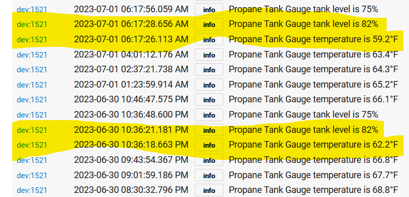

The erroneous readings for level and temp are within seconds apart.
That could be a clue.

Great, it's become a regular thing.

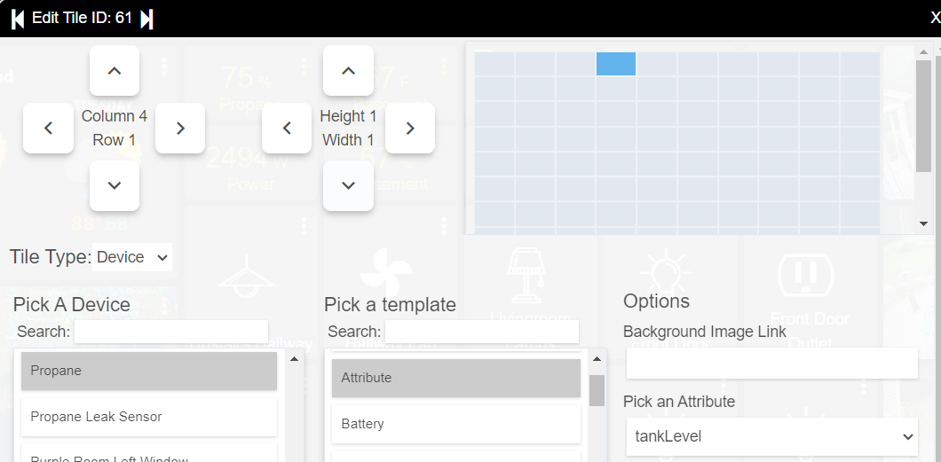

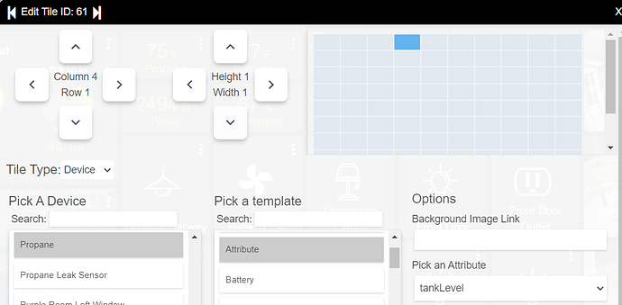

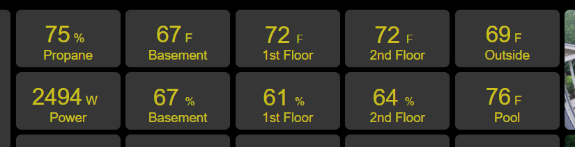

Even though I can't use the device yet, I got the attribute for propane level working well on my dashboard. Had to use some CSS to change the font size of the value to match my other data font sizes, and had to add the percent sign afterwar.
#tile-61 .tile-primary {font-size: 26px !important; }
#tile-61 .tile-primary:after {font-size: 14px; content: ' %' !important; }
Very nice!
I have resisted CSS...until now.
I just cut and paste your stuff, with a font tweak.
Have no idea what "after" means, but I guess I'll have to read.
Would be nice to get the battery % on the same tile, without "investing" in a tile design app, or whatnot.
Also, I think I'll get rid of the "tank gauge" on the device name. I've been getting too wordy for the tiles' dimensions.
Again, totally not knowing what I'm doing:

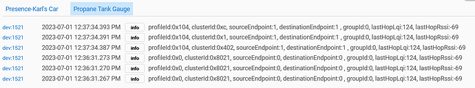

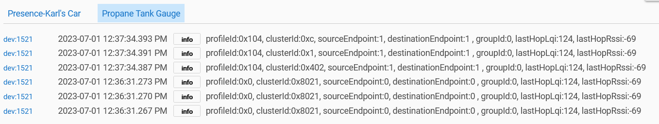

Can you put the device into debug logging, and post the descMap live log when it reports 82%?
If you don't need temp reporting, try turning it off.
I don't know if the interval is hard coded or not.
Sure, but doesn't that usually time out after 20 minutes?

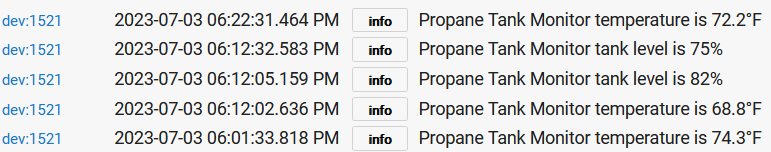

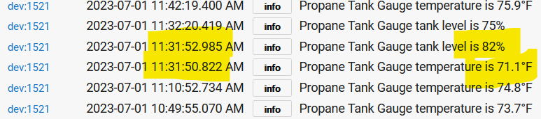

It happened again.
First, it seems the temperature reports an erroneous number, lower than it should be.
Then, three seconds later, tank level is reported to be 82%.
Then, 27 seconds later, tank level is reported to be the correct 75%.
Then, 10 minutes later, the correct temperature number is reported.

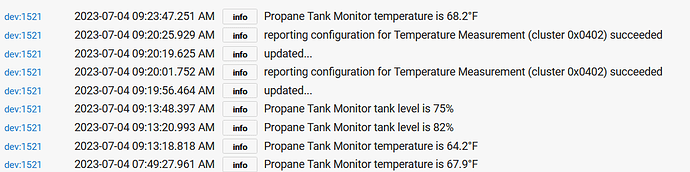

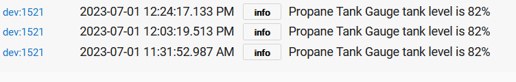

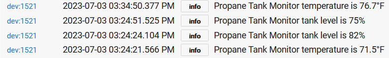

Geez, I just missed turning debug logging on for another one:
Another one.
I have a notification set up now to tell me when it goes to 82%.
Missed it with the debug log.

27 seconds for level self correction.
10 minutes for temperature self correction.
