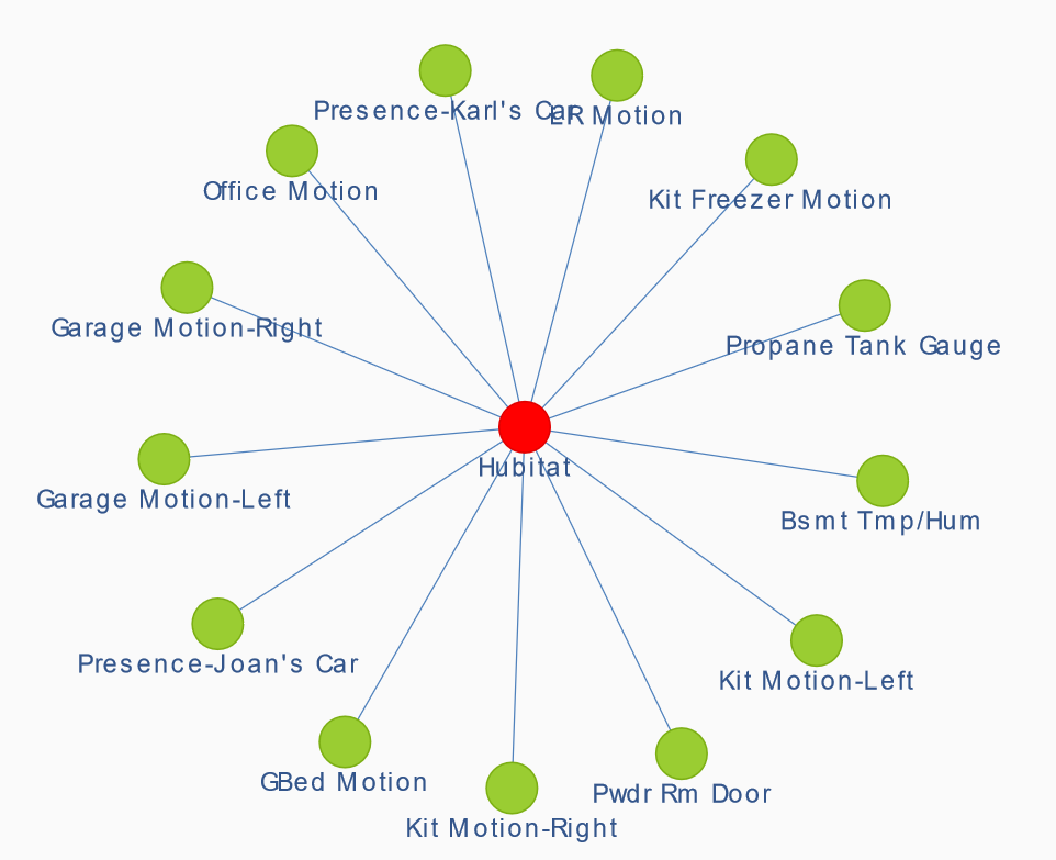

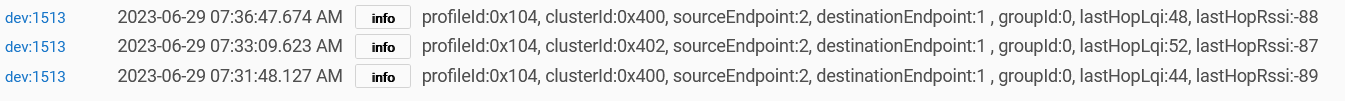

I just stuck (magnetic) a Hue motion sensor from the living room onto the tank fill cover to see if it would reach the hub without a repeater. It does, barely. RSSI is about -88, -89. Perhaps my radial arrangement (no repeaters) will remain intact, lol.
The tank is a 1,000 gal above ground horizontal tank, not close to the house, with garage in between.

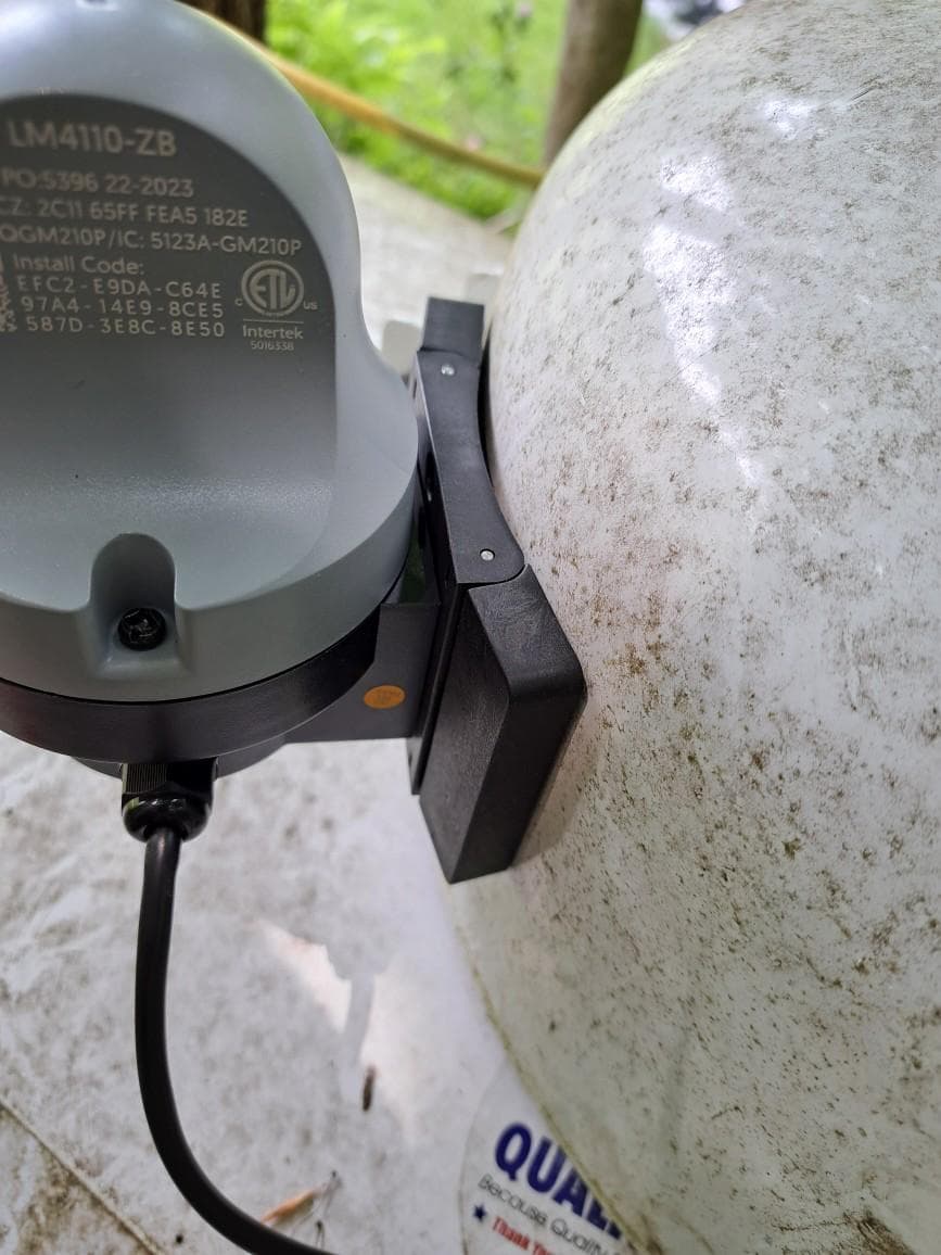

Well, that was easy.

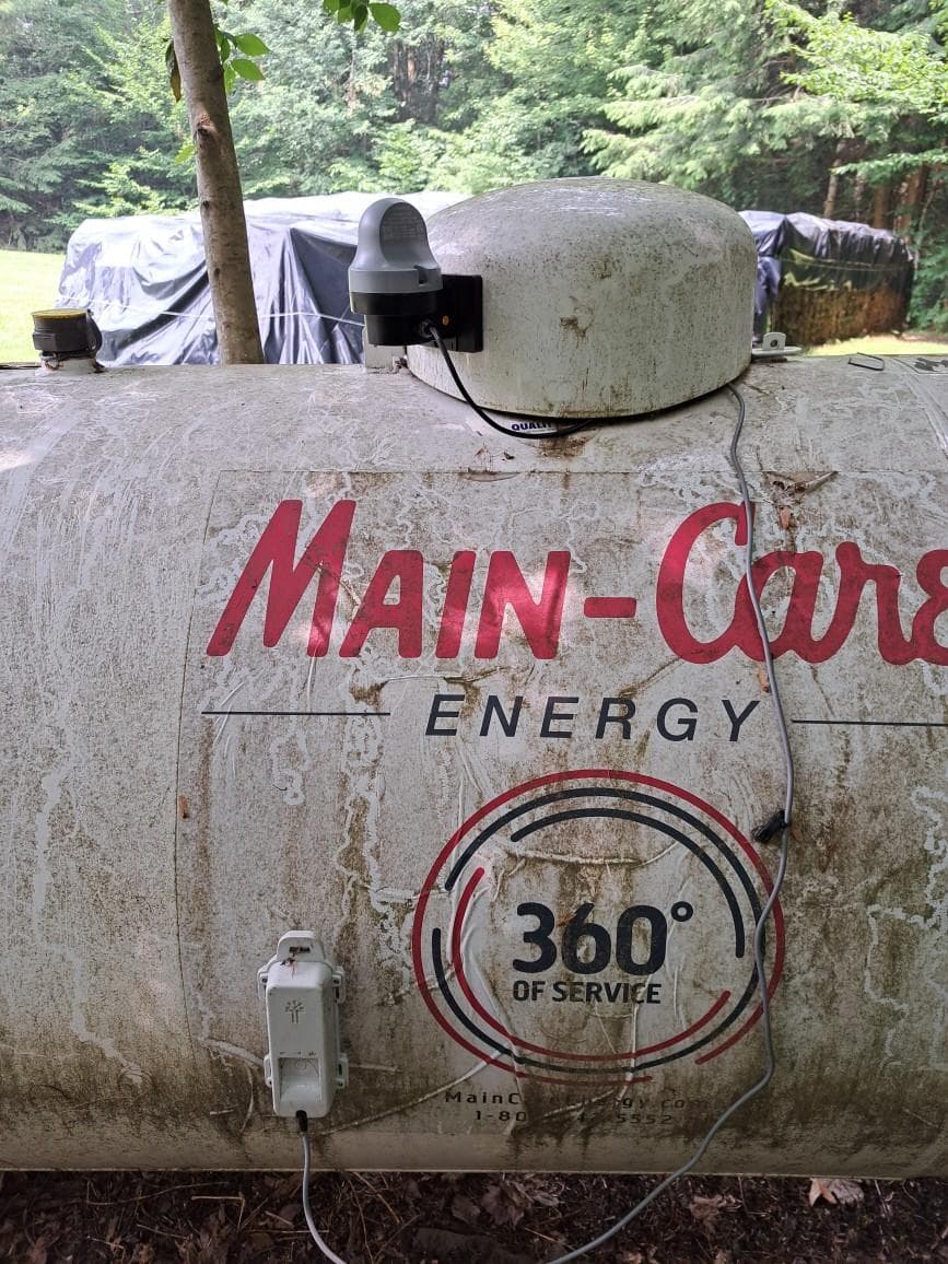

The only complaint I could have is that the sensor lead is a little short.
Not that that's necessarily a bad thing.

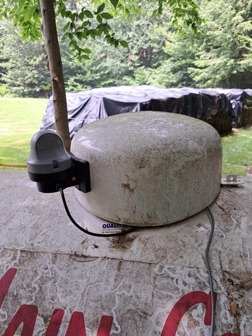

I have it located on the side of the cover, and there's just enough wire so that the cover can be opened without the device hitting the tank.
There's a natural 'drip loop' with the short length and location.
Strong signal strength, considering the location.
Seems accurate enough. edit: 2% lower than Tank Utility, but somehow the tank info got changed. Sinope doesn't ask for tank size, only horizontal, vertical and fuel type.
I like the pivoting magnets; can be adjust from flat to different curves.
And, the magnets are very strong.
They supply 3 Energizer lithium batteries, which is nice.
So far, So good!

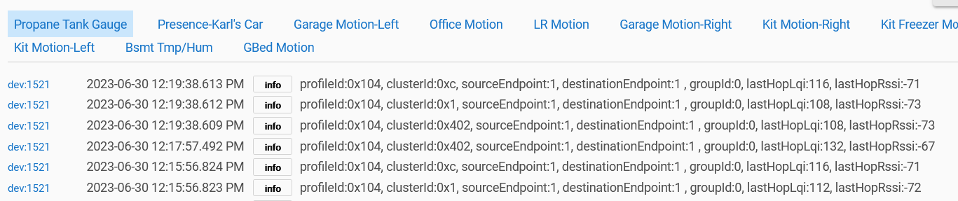

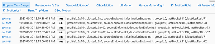

@mike.maxwell , on the driver, the temperature reporting setting seems to work: I set the interval to 5 minutes and it works.
What I'm wondering, when does the device report battery and tank level %? I know I can induce them by Refresh, but I'm wondering what the parameters are? I haven't gotten any log notices yet.
The manual says something about reporting every 10 minutes, but that's not happening, except, I guess, temperature, if the interval is set to 10 minutes.
I'm assuming it's something like a % change, or every 24 hours or something like that, but it'd be nice to know.
