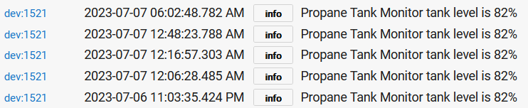

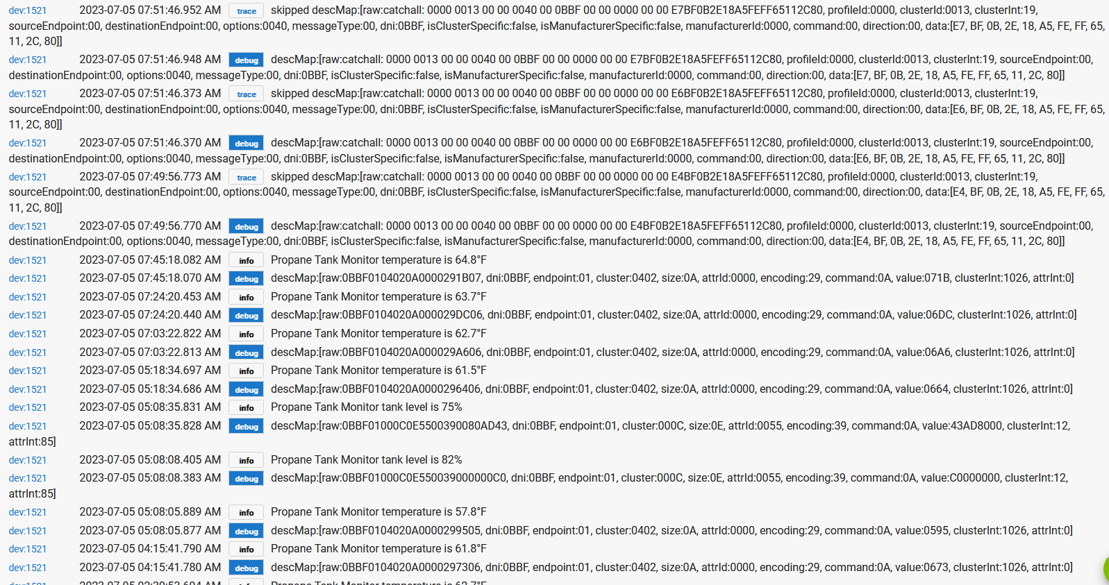

@mike.maxwell , I managed to capture a debug log of the event.
I included some later entries because I thought they looked weird.
The 82% value seems invalid and will be removed in the next platform release.
The temperature value is valid, so I can't do anything about that.
Any idea what all that stuff at the top of the snip means?
its ZDO traffic, normal and can be ignored.

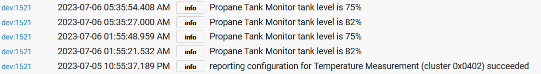

I tried that last night, thinking maybe it could have an effect on the erroneous level readings.
It seems to have stopped reporting temperature, as designed, for 12 hours or so.
Alas, I got two 82% readings as well, so no effect.
I tried 10 minute reporting intervals overnight.
It was worse than turning it off, as far as erroneous readings go.

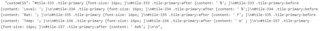

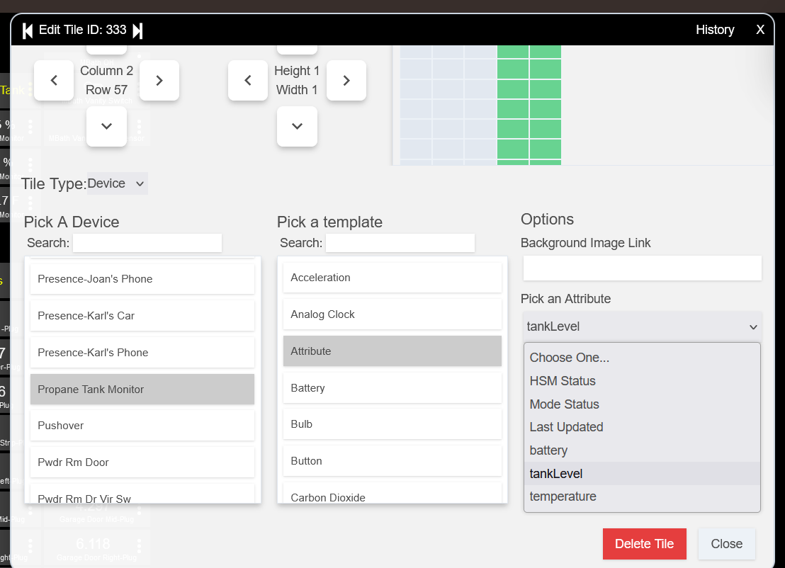

Can you explain to mean in detail how you created the attribute tile for the level sensor?
Does this help?
I just remembered, under the tutelage of @Big_Bruin , I went into Dashboard/Advanced/CSS and put in the following. There's something additional for kwh for another tile, so ignore that. You have to reference your own tile numbers.
