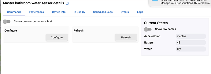

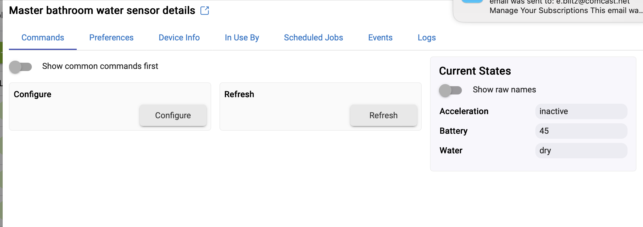

Post a screenshot of the device page. (since you are new to the forum, you will probably need to join the Owners group (Hub owners - Hubitat) to enable image posting).
Thank you for your assistance. Device page shows "dry" as the current state. When I put the sensor into water, the audible alarm on the sensor sounds but the device page still shows "dry".

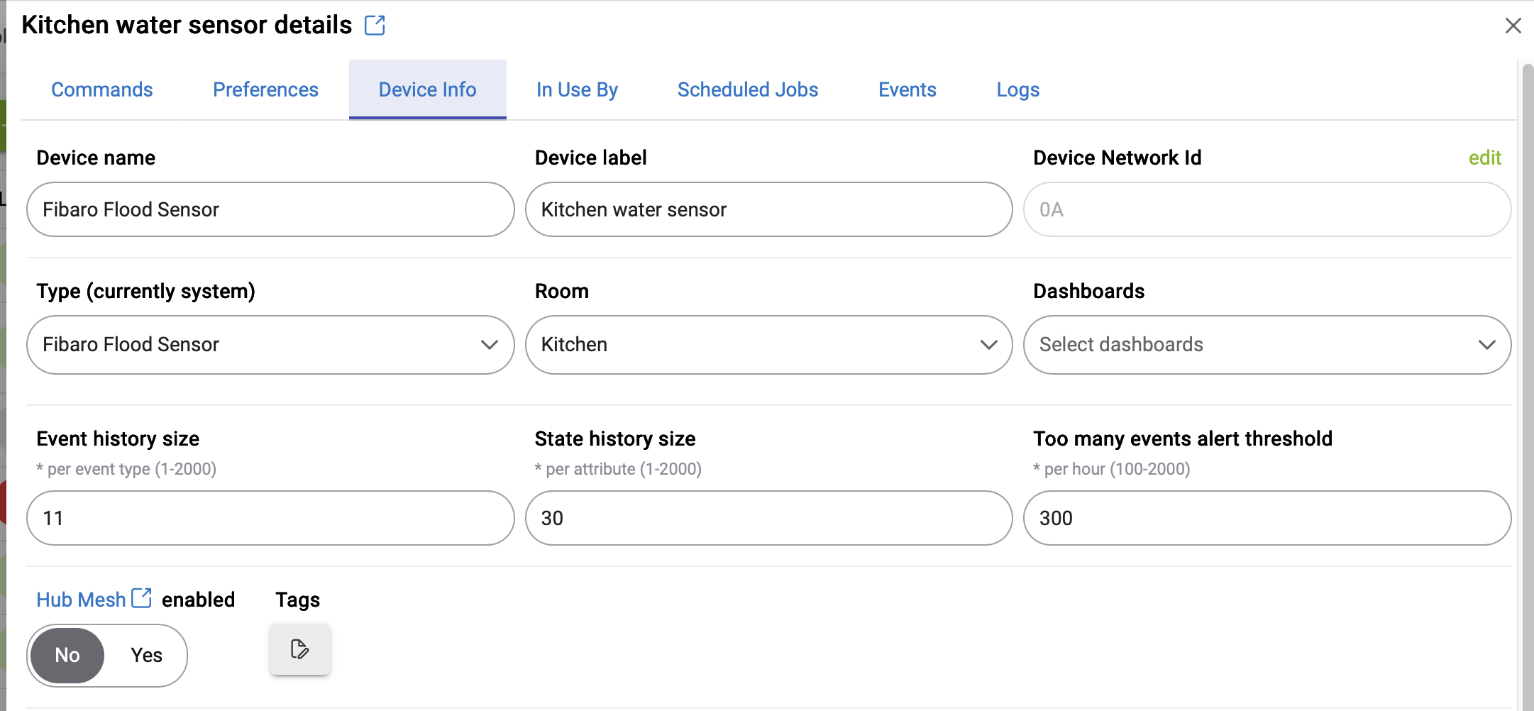

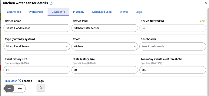

On device info tab, what is the type? That's the driver it's currently using.
It's a Fibaro Flood Sensor...
Well that looks right. I do not use this sensor but I have several leak sensors in my system.

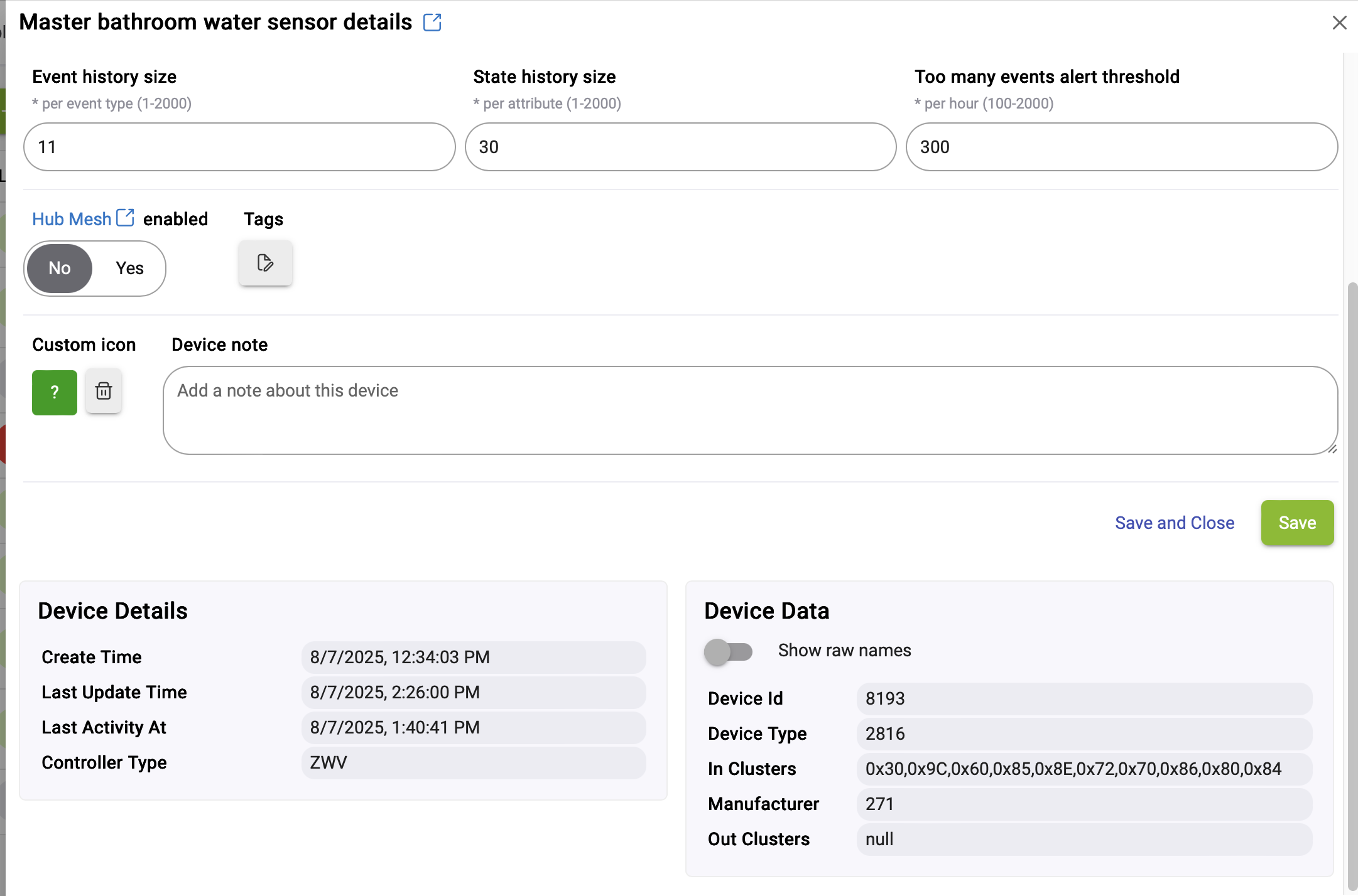

Also can you post the Device Details and Device Data sections from your Device Info page (scroll to the bottom).
That's correct.... all 6 sensors when wet do not change from "dry" to "wet". As mentioned, they all worked prior to removing them from the veraplus controller. I did excluded them and then installed on the Habitat.
Here's a screen shot of one of the sensors.....
I think the lack of a 0x5E in cluster means you have a non-plus device. :thinking:
Depending on the version of Hubitat hub you have that may be a problem.
I'm not sure what "the lack of a 0x5E cluster" means but I'm sure the sensor is a non-plus device since the date on the box is 2016.

Just that it should be listed as an In Cluster.
As to what it means... that's above my pay grade. :wink:
