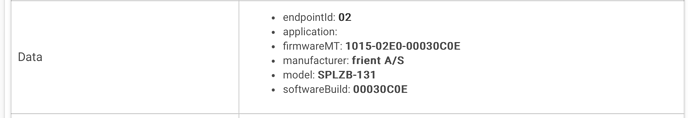

Well, actually the plug identifies as a tuya metering plug, but contains a lot of features, so perhaps nothing is really needed for the plug, except an "officially named" driver with the same features.
One thing I do miss in most internal drivers is a refresh button. Every once in a while it seems like something I would like to press
No to get the fingerprint open logs in a window then switch to the device. Change the device driver to DEVICE then click save then click CONFIGURE. Then check the live log window you have open and you will see a bunch of data. Screen shot it and post it here. Then switch the driver back to what it was, click save, then click configure.
the correct Hubitat driver for this device is the Generic Zigbee Outlet
The fingerprint you provided would match this driver, however any user driver containing a matching fingerprint will always be selected first.

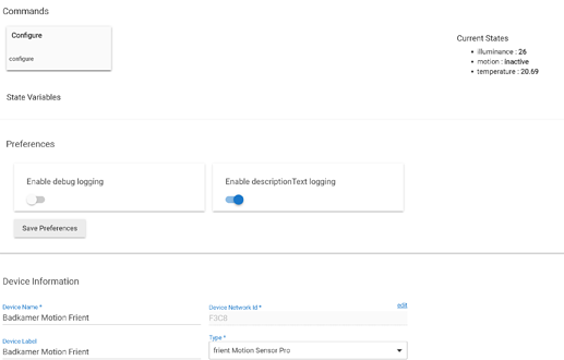

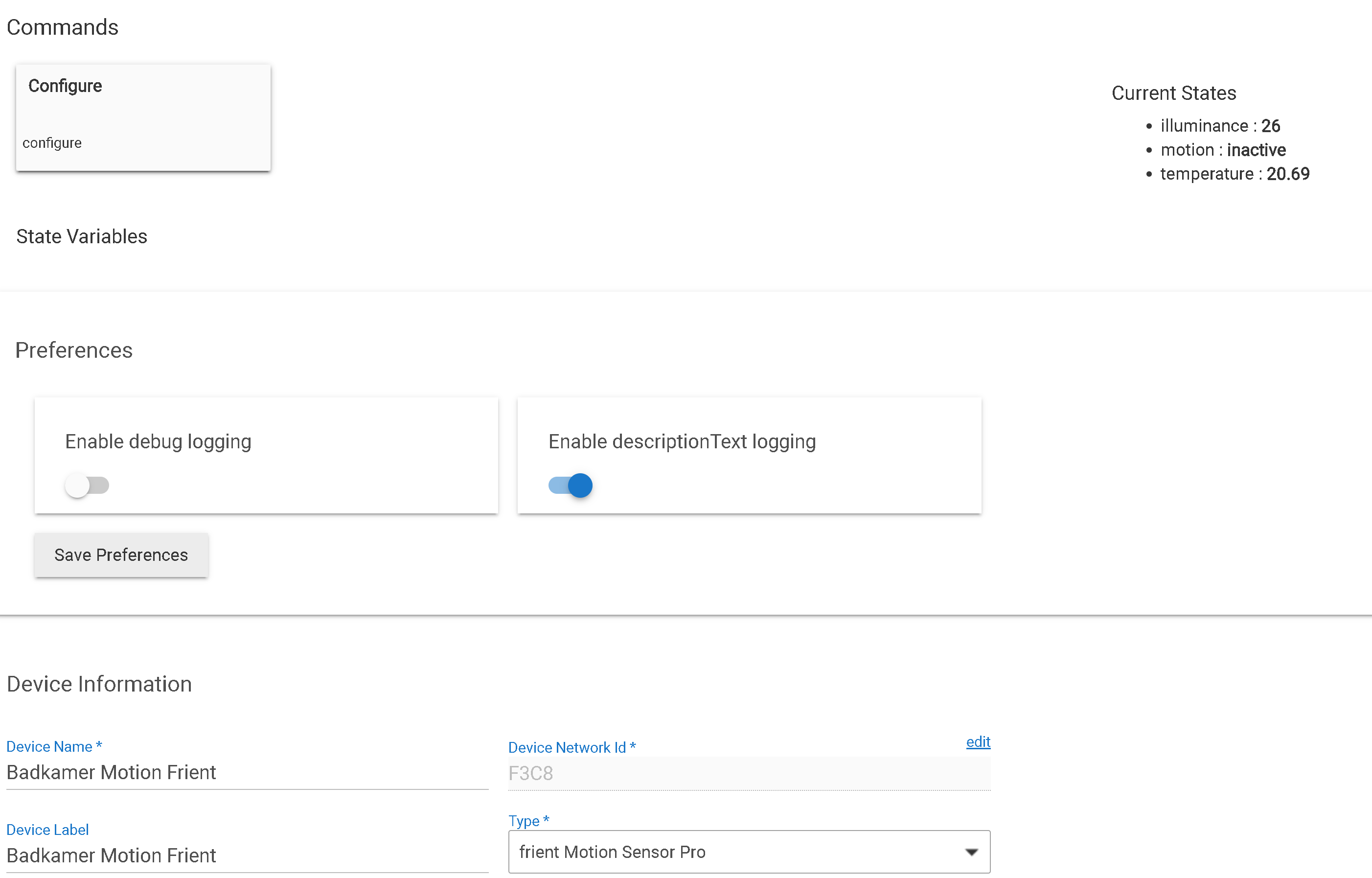

I'm almost perfectly happy with the Frient motion sensor and even the pro's...
almost, i'm missing it or i don't know how to get any battery readings.
Is there a way and if so, how?
If not, it's kinda a dealbreaker since i don't check every sensor every day.
Update:
I contacted Frient on Messenger since the motion senors don't share battery status.
As i understand, it's a hubitat thing...
so pls, @Hubitat_Staff add this (small) thing to it so it's really a usefull sensor.
