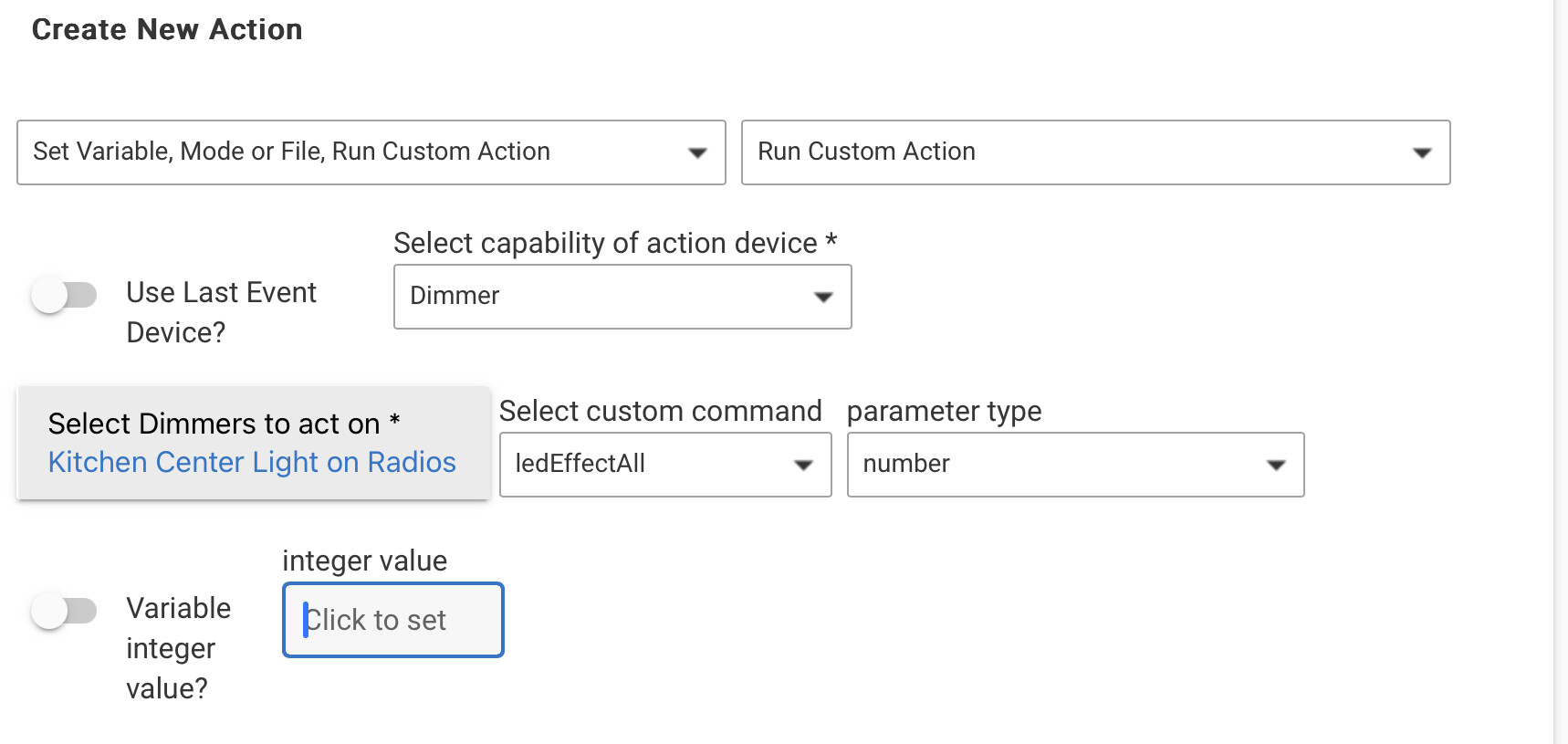

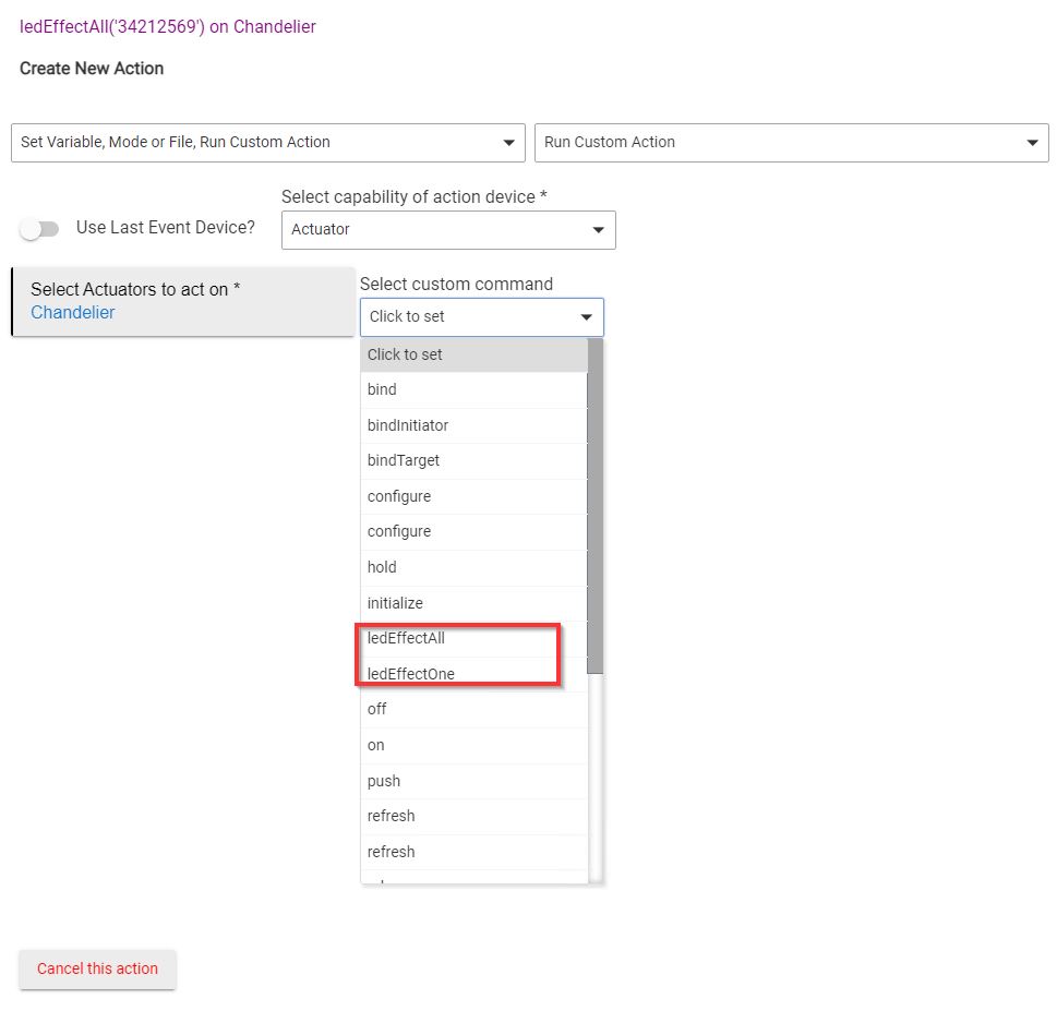

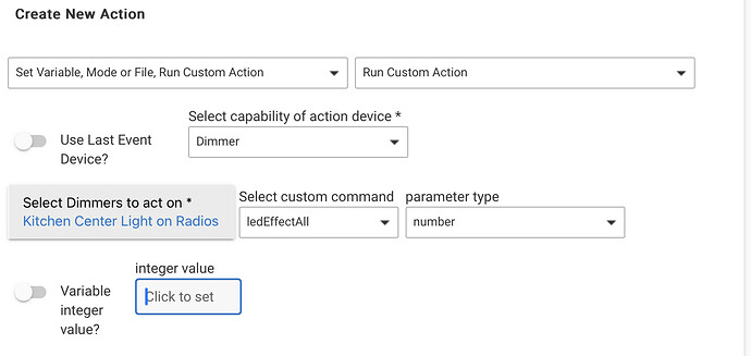

You replied very quickly, sorry I took so long. I created a rule in RM, run custom action, actuator (Like the reds), choose device, but I don't have the additional parameter options you appear to have.

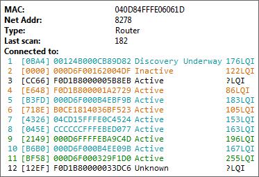

Am now reading through the Inovelli threads.. Seems like 2 big issues - LQI/Pairing/routing problems and binding issues.
I had no issues with any initial pairings, and overall performance was perfectly fine for all my switches (in terms of responsiveness once installed etc).
But the binding craziness derailed me before I could take a good look at LQI stuff -- I did take a couple quick glances at my ZB routing table and the numbers were not good, but I decided that as long as performance was OK, I'd just roll with it.
My ZB mesh was in really good shape before I added these, so I was not depending on them to do any heavy-lifting in terms of being "must-have" repeaters in my mesh or anything like that.
I just hope that they don't drag other stuff down if they do try to route, but time will tell -- Eric & team is keenly aware of those issues too, so hopefully they can make progress in that realm also.

You’re almost there - only need another step:
You will need to add each of the parameters one at a time.
