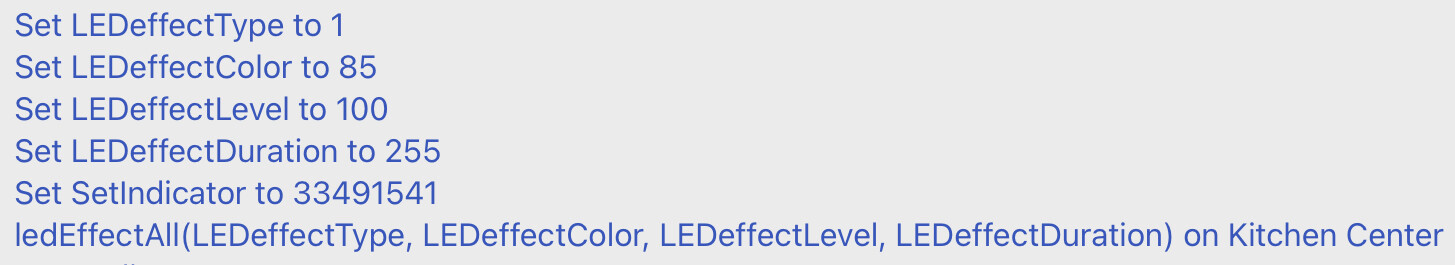

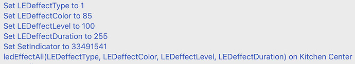

From Rule Machine, the “ledEffectAll()” custom action will be required. The following is how I set it up - I set the values in variables first, but this is not required.

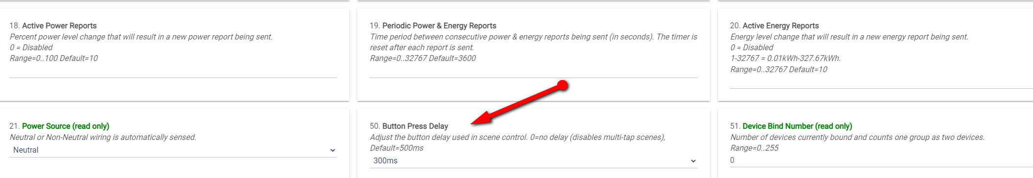

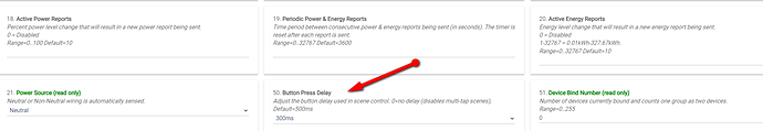

I read the manual ! We need to set button press delay, it defaults to 0 and makes multi taps not work. set it to your "quickness" at tapping, I used 300ms.

Hello @Sebastien, I just received my Blues and I've been trying to replicate my alarm arm and disarmed led effects I used on my reds when I stumbled upon your comment. Can you shed any more light on how to accomplish sending custom LED effects? When I choose Actuator and custom command I only have the ledEffectAll and ledEffectOne. I am using the Inovelli Dimmer 2-in-1 Blue Series VZM31-SN driver code. Any help would be appreciated.
I setup mine in Rule Machine, using the Run Custom Command, then chose “ledEffectAll()” with the 4 parameters as described. Where are you getting stuck?
