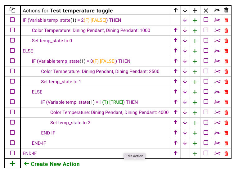

One functionality I'd love to incorporate is the ability to use the Config button to toggle between several temperatures for the lights.
The objective would be to have the lights stay at the same level, but rotate between 1000k, 2500k, and 4000k for each press of the config button.

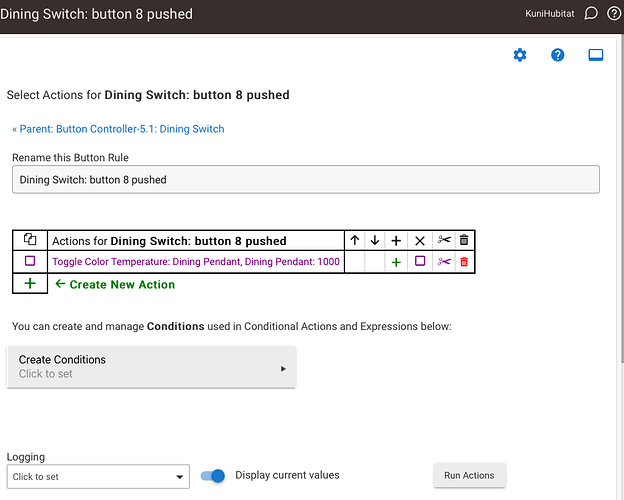

Use the Button Controller app to set it up - it will work well (I was doing something similar with one of my Blues before I had to take all mine offline).
The thing to watch out for is that Inovelli uses a unique button mapping structure that doesn't align one-for-one with the UI in Button Controller, so some translation is necessary as you build the corresponding button rules.

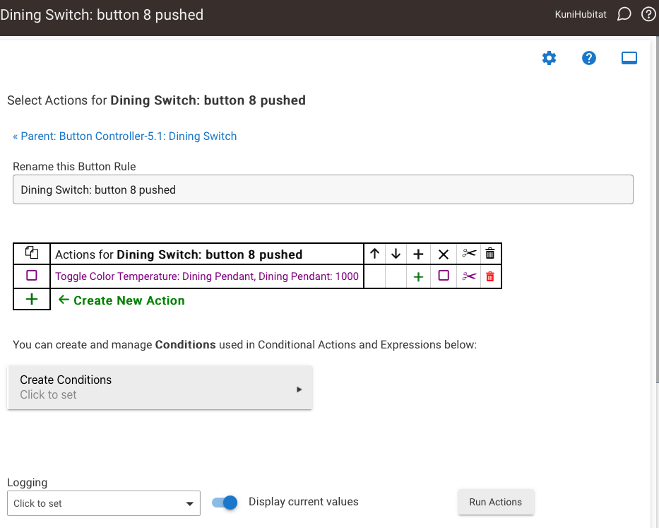

I was able to get it set up to toggle between one temperature (1000k) and off. Is there a way to set it to rotate between three temps and not have an off state?

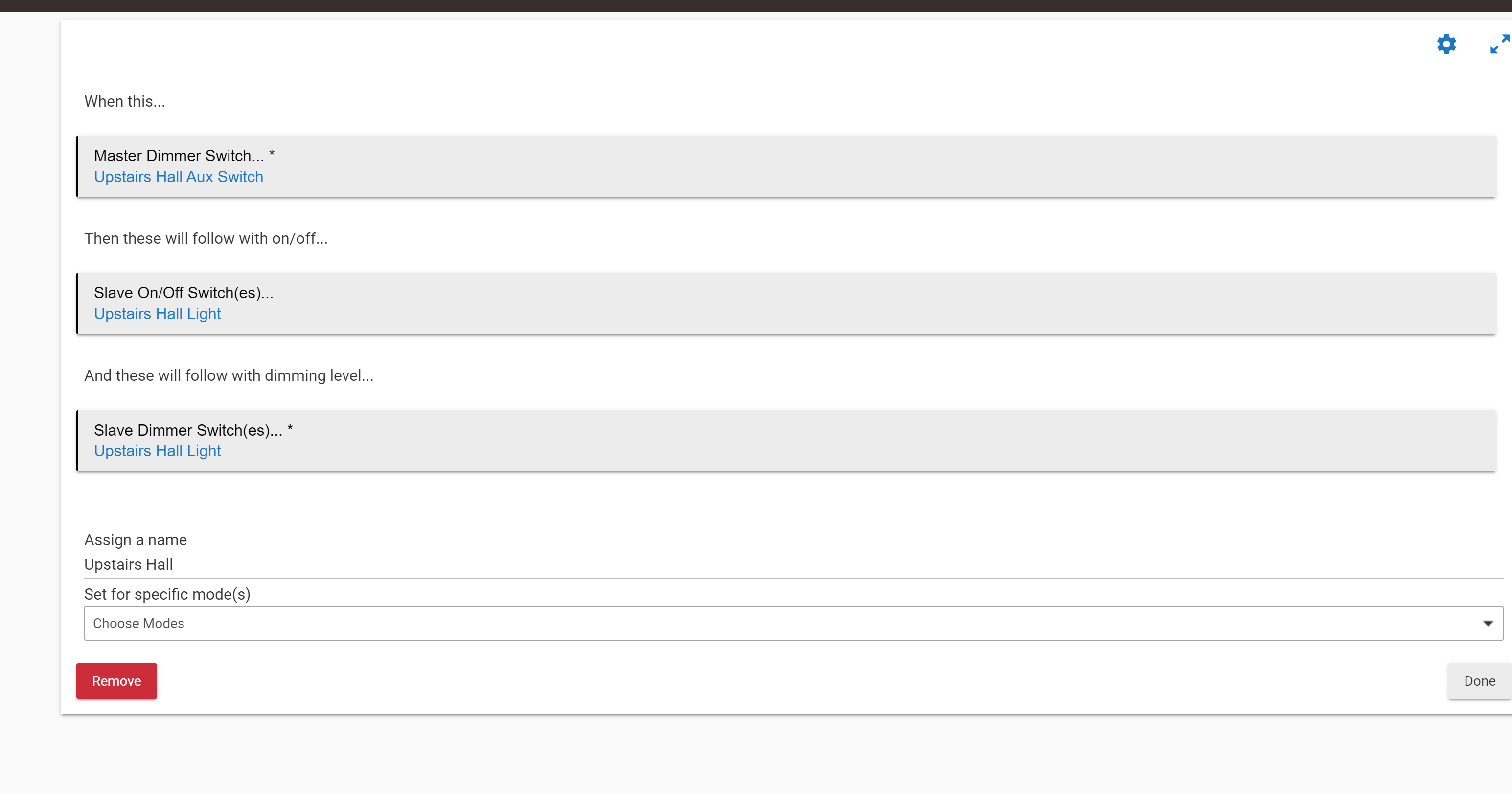

this is what i had.. 3 way or is it 4 way.. with 3 switches for the same light. unfortunately the 3rd location had no neutral in the box and was wired such that depending on the other switchs configuration did not have power at times.. So i put a regular dimmer and extension in the two locations that did work normally and for the 3rd wonky location using this switch
its pricy but it has 2 2032 batteries and the seem to last about 2 yrs depending on use and it looks like a regular switch..
obviously thats not hooked up to anything and i just use an app called dim with me to have the non wired aux switch control the main..

Ah, OK, I better understand what you're trying to do... That's hard because what you're seeking is to have a single-tap to do multiple different things -- that's unfortunately not possible programmaticallyy.
You can either use a unique tap sequence per color (e.g. 2-tap = 2.5K, 3-tap = 4K, etc) or you may be able to get creative with hold/release... Program the hold to cycle through the desired colors every 1-2 seconds or so, and then program the release to use the color shown when released.
I don't know exactly how you'd set that up, but I'm pretty sure it's possible to do.

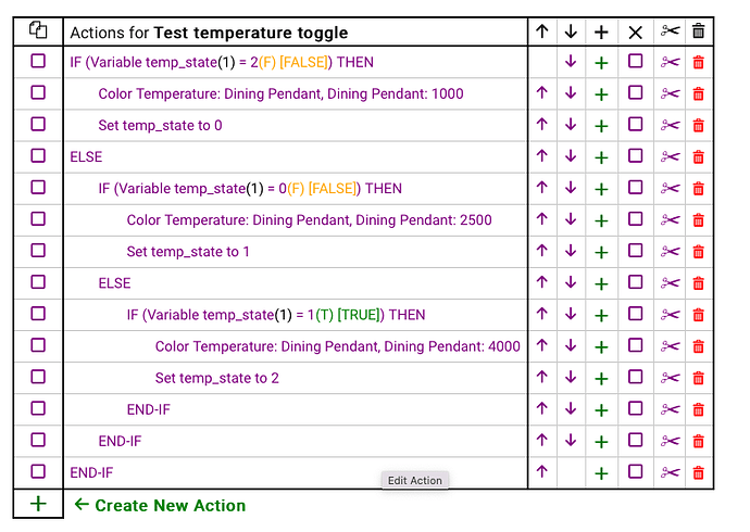

couldn't a variable be set, that increments with each press, eventually resetting the variable to the beginning value, and set rules that look at each variable and respond to it?
Good call -- yeah, I bet you are correct! I forget about something like that... Yeah, I'd think that could work too... I've long intended to get smarter on using variables -- I don't use many yet, but they are a powerful tool.
Thanks!
Yeah, I think this is the right way to approach it.
Unfortunately, there are no elif statements that I've seen. This seems to be working in theory:
Thanks for the advice!
Edit (update): This is working beautifully!
Thanks for update - glad to hear it's working well!

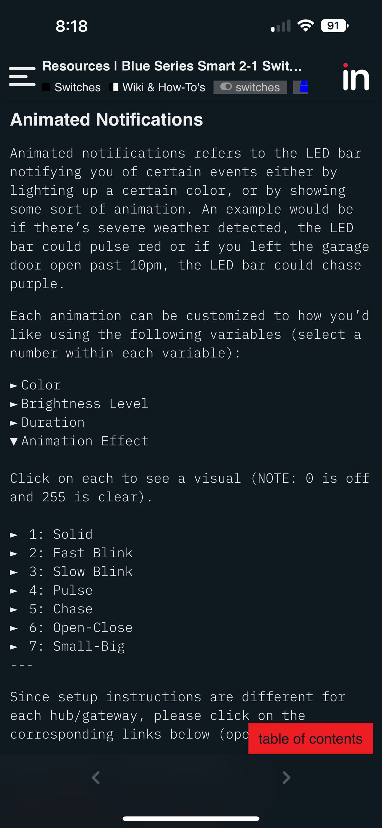

Is there a reference for the led effects somewhere?
@user32 …I went to the inovelli site and the documents for the blue 2-1. They have since added more led effects via a firmware update on the switch which adds about 10 more. Tho idk where there is anything stating what they are.
Some are self-explanatory (solid, fast blink, slow blink, etc.), but most make some sense based on the name (pulse fades in and out, chase makes it look like the LEDs keep going up back down). Some of the new ones barely make sense at all (I guess "siren" just blinks an LED or two towards both ends of the bar?), but I suppose I can see what they meant. :slight_smile:
Considering there are now something around 19 possibilities, I'd say your best bet is just to try them and see for yourself. If you're using Inovelli's driver, you can do this by manipulating the "Type" parameter on the "SetLedAll" command. Maybe they'll update the manual with more examples when the firmware updates calm down (they've been testing/releasing a few since initial release).
