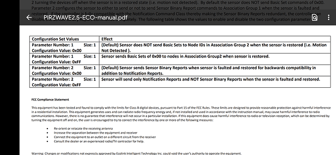

Looks like there may need some configuration changes to the device. Not sure if this would have happened on paring? @bcopeland could you assist? I believe it's the basic motion sensor driver used.
