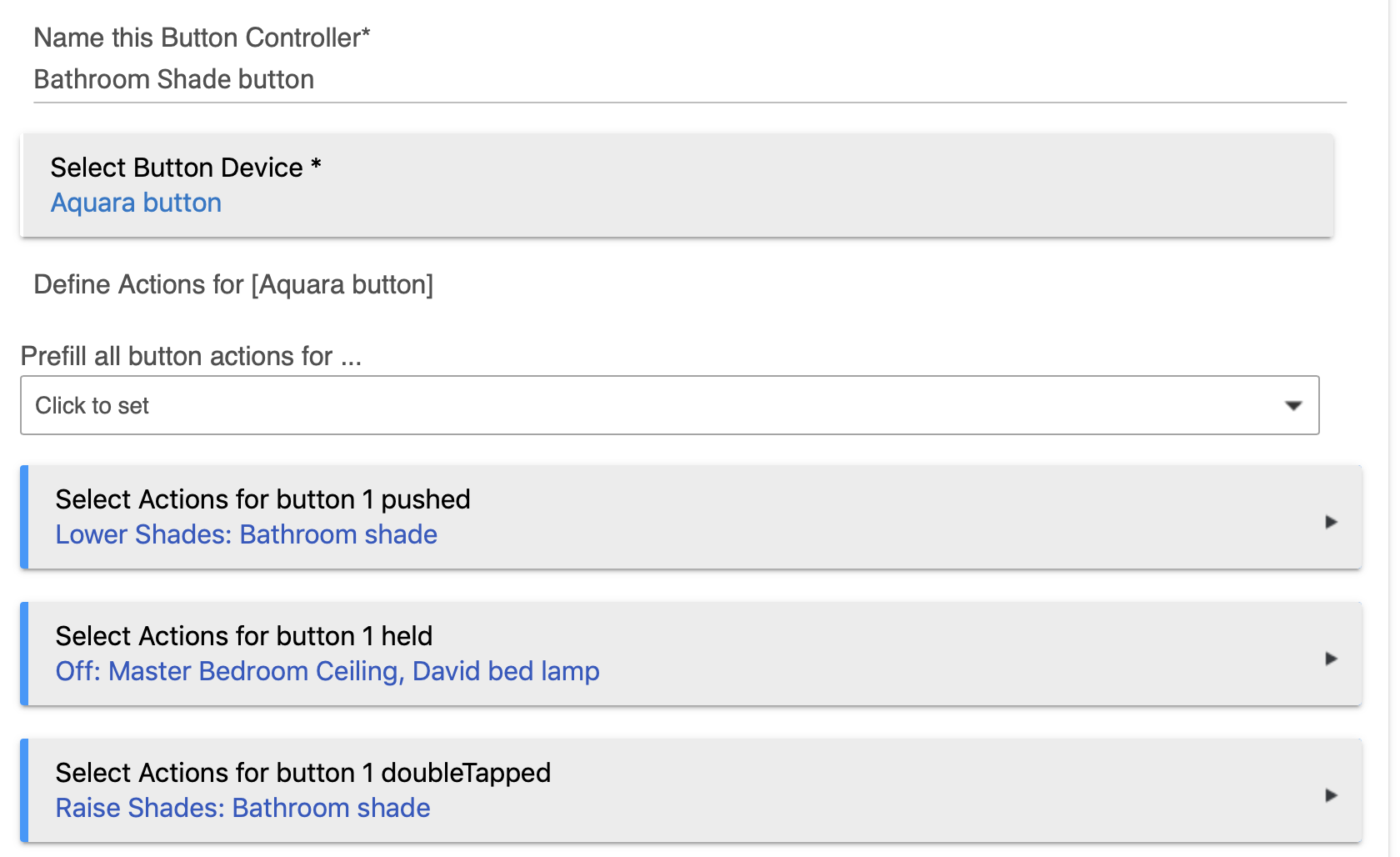

@TomG are you using a rule with the Aqara button to control your Ikea Shades? What device driver are you using? I have the Aqara button and want it to do exactly what you did but not having any luck with it? Thanks
I'm using the Button Controller. button 1 (push once) lower shade. button 1 doubleTapped raise shade, hold button down briefly do something else (turn off lights in my case).
I'm using this driver:
https://raw.githubusercontent.com/markus-li/Hubitat/release/drivers/expanded/zigbee-xiaomi-aqara-opple-button-switch-remote-expanded.groovy
It's working well for me.
Hope this helps.
