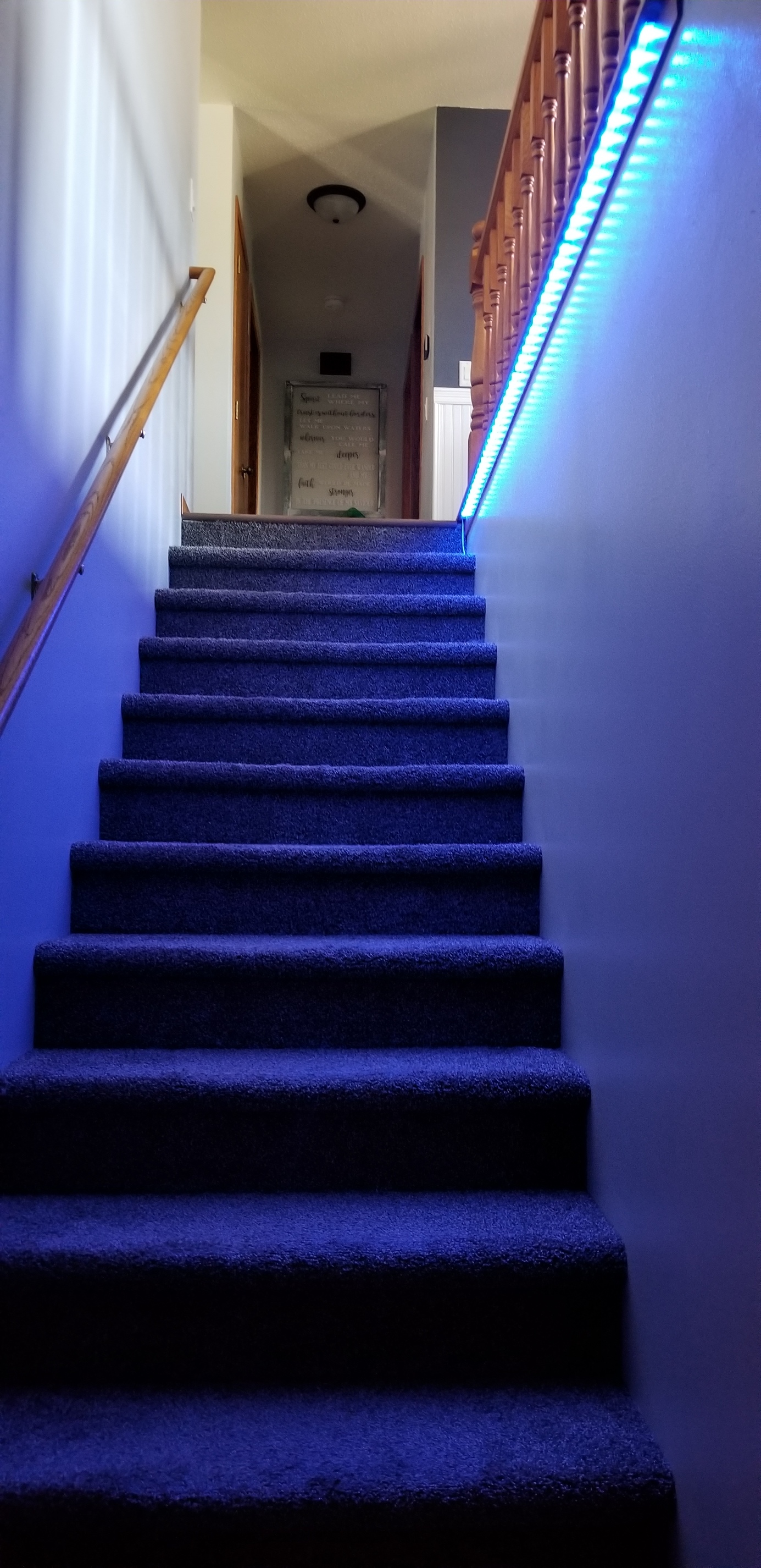

The rest of the house is more simple, just worth mentioning. Steps are lit with a sensor at the top and bottom. The bottom sensor turns on the basement living room lights when you reach it. The lights remain on if my office lights are on or the tv is on. Otherwise they turn off when motion stops. Same weith the spare bedrooms.

Well, my steps are lit. I have a motion sensor on both ends. My intention is for it to turn off when you reach the second sensor, etc, if the first sensor is active, but I haven't set down to figure out those rules and the timing of it all.

When it comes time to work on your stairway rules, remember the ' wait for conditions/events' actions. I've found this to be a simple and reliable way to sequence things. I've set up an automation to where I can tell Alexa to lock the door behind me on my way out. A virtual switch is turned on, then waits for the door to open and close before locking. If the door isn't opened in 30 seconds, the wait is cancelled, the actions are cancelled and the switch is reset.
In your case, motion sensor 1 is triggered turning light on, wait for motion sensor 2 to go active, then turn light off.
Great advice. I need to establish the range on the sensors. I think I'll have to have some sort of delay, but not sure what that'll be. The bottom sensor also turns on the basement lights when you're headed down and just about to the bottom, so I need to button it up and keep my rules efficient. It'll be a nice challenge. Right now they're just reaching out and working so that I can establish how we use them. I want to change the brightness and color of the steps according to time of day. Blue at night and maybe bright white during the day. or direction of travel. Going up could be a bit blinding and going down needs to be brighter because the basement is dark. So many things to think about with this project. I'm glad you brought that up. I hadn't thought about basing these rules on conditions in that way.
