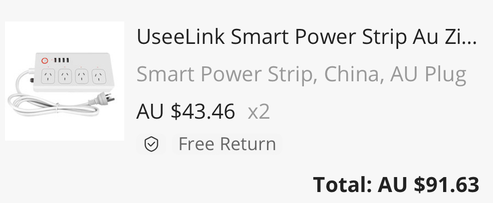

From HERE but it looks like they’re “out of stock” now.
The Power board appears to remember last used state for each Power outlet and the USB ports (USB's are ALL either ON or OFF, not switched individually)
Also the displayed price is twice what I paid….
