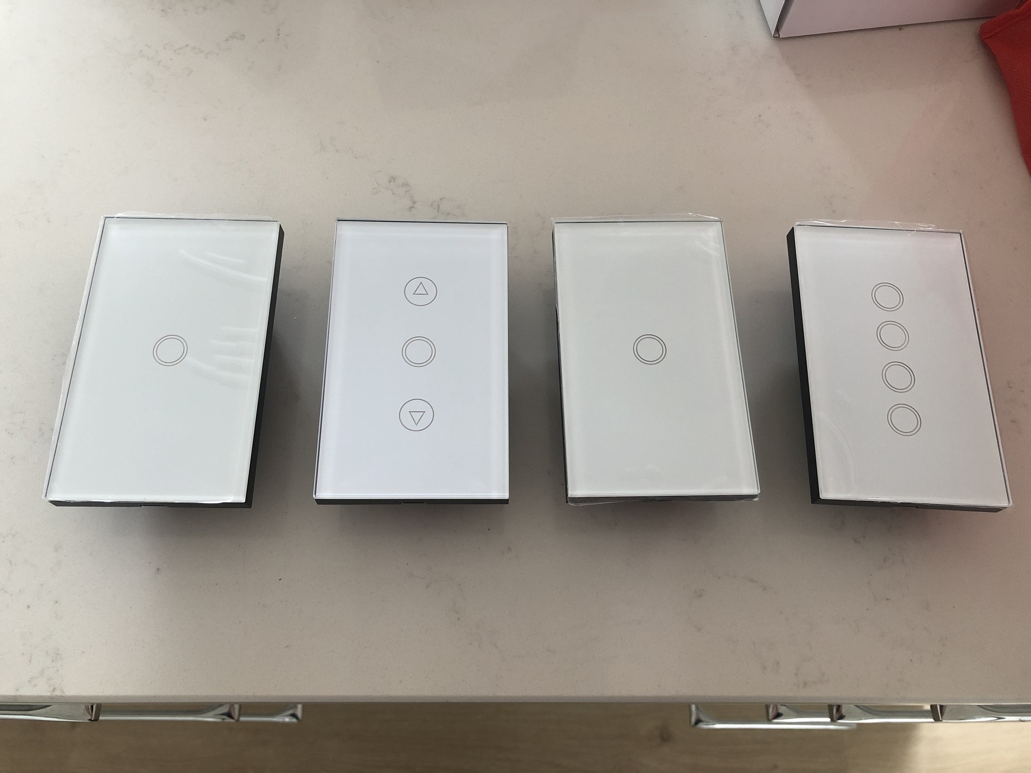

There are also some oddities with the Makegood labels on the light switches. Both the 1-gang and the 4-gang light switches have the same label on the back of them, complete with the same model number. I don't know if this is a mistake in their labelling process of their products or if this is an attempt to bypass certification of all their products (just certify one switch model and then use the same model number for all the different switch types so they don't have to send them all away for certification).
