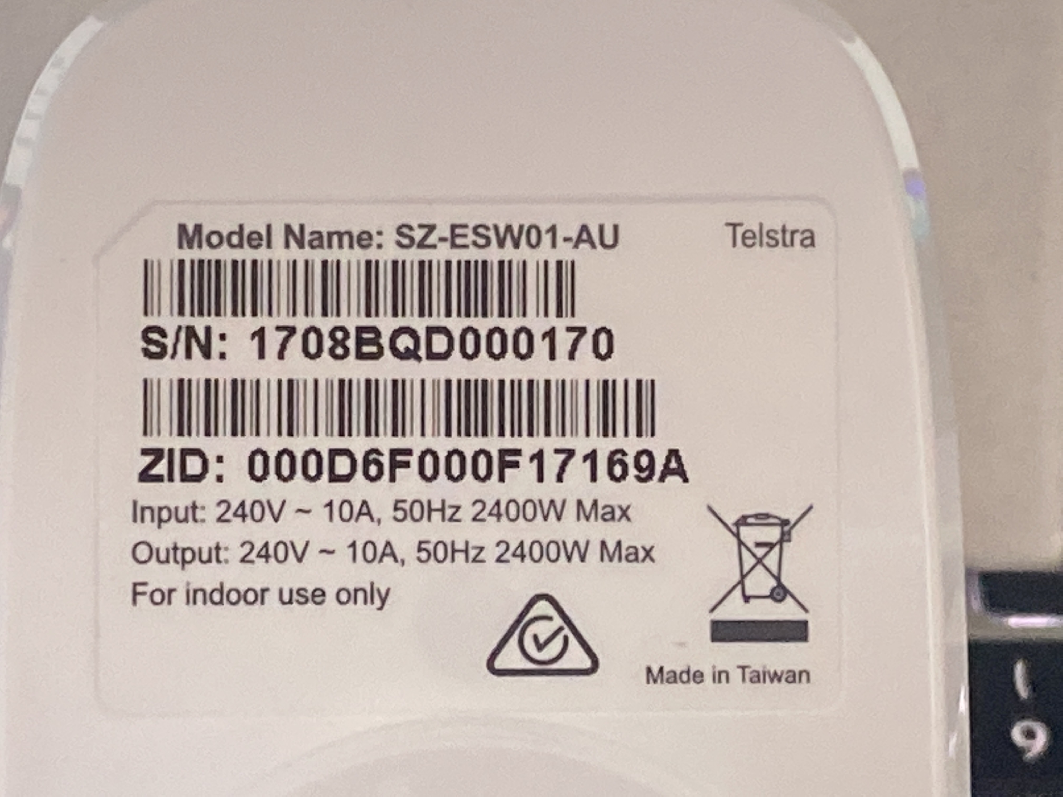

What are the power rating specifications of those Telstra zigbee outlets? The listing on eBay doesnβt provide any details.

Hey have you noticed how warm these "Telstra zigbee outlets" get ??
Rather toasty.
Somewhere I have a power meter so I'll plug one of the Telstra plugs into it and see what they're consuming, just being ON.
