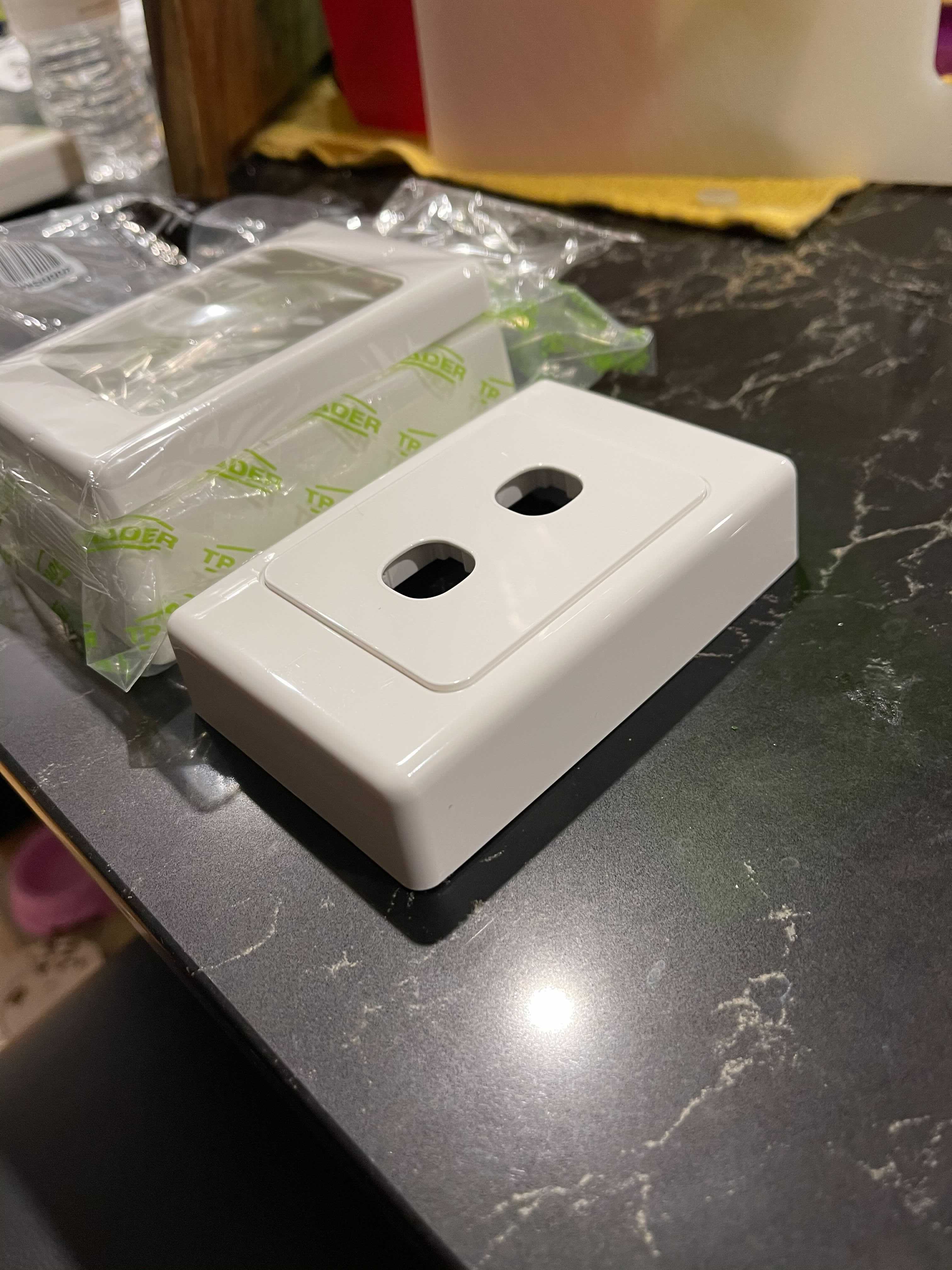

In a place where I needed two nano devices (dual switches or dimmers), and I couldn't go into the wall, I put another mounting block below with a blank plate. Or if it was a dumb switch, use the space behind.
The other option which I've thought about but haven't needed to do (yet) is to run just the wires to the switch mech (ie your 30BPL) down to the plate, then leave the nano dimmer up high in the ceiling or down low under the floor. Or in some less visible (ie not at eye height) boxes nearby. It's just two wires to the mechs, so not a big deal.
And I agree, multi-dimmers would be useful. But surface mount always has limitations.
This is an entirely valid approach, your sparky will usually put the nano into a junction box to keep insulation from causing overheating and other issues.
Me and my sparky ran in to this issue as well. What we ended up doing was putting in another flush box above or next to the existing (no hole through the wall though). We took out the sides of the flush boxes that were facing each other so in effect we got a flush box that was twice the size compared to a normal one but with only one single sized hole through the wall
Thanks SimonS and mattias. Those are both great solutions. Running wires from the switch isn't possible in a single brick internal walls or slab roof, but I will keep it in mind for the double brick external walls. The back-to-back boxes is probably what I'll go for if my plan below doesn't work out.
I've bought every mounting block Clipsal has for the C2000 series and have settled on swapping the switch plate for a 2000 series mounting block with wrapping cover. In the foreground is the 2000 series mounting block with enclosed cover, the background is the C2000 mounting block + face plate. The C2000 block is just too tall and didn't pass WAF. The 2000 mounting block was deemed acceptable.
The 2000 series mounting block should give me the extra 20mm I need to fit 2 Nano Dimmers. Remains to be seen if 2 30PBL mechs will fit as well.
