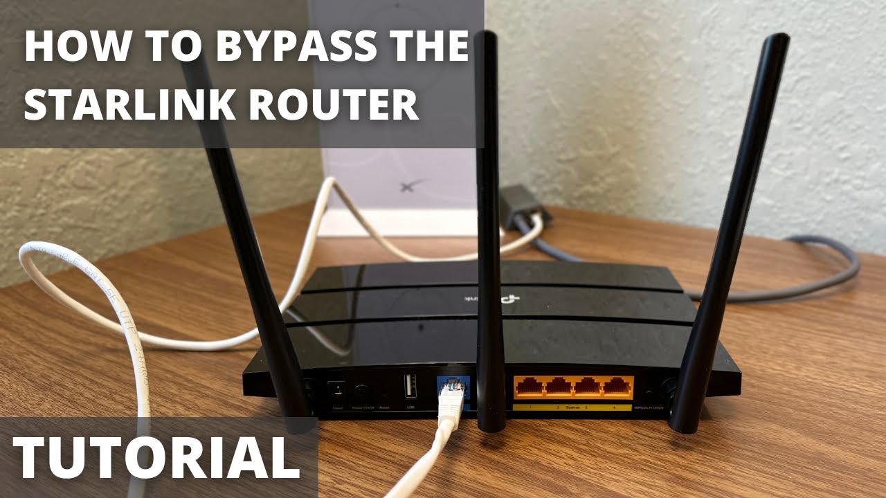

If you want to have a full network set up just buy a compatible router, and then go into your Starlink app, settings, and then bypass router. Then just plug in your ethernet adapter, and then an ethernet cable from your adapter to your router. Then, of course you can just plug-in all the devices you want.
See here :
You do have a router, that's how you're getting IP addresses assigned via WiFi. But the picture is getting clearer now. Sounds like you don't have a router that has a built-in network switch like @WarlockWeary posted above.

Buy a router like @WarlockWeary posted above and plug that directly into the ethernet connection from Starlink if that's possible for your setup.
