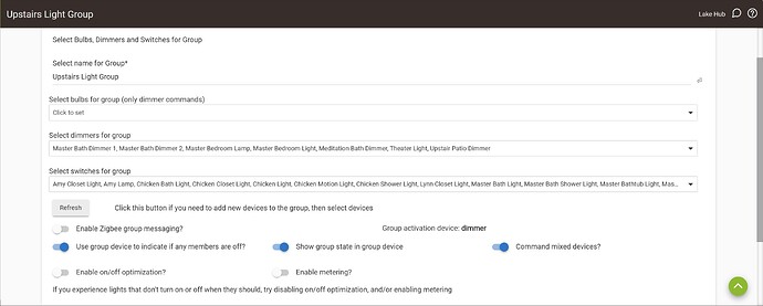

This is the setting I used for the group lighting.
With the above setting, when it doesn't turn on/off the first time, I hit the group on/off the button the 2nd or 3rd time and it will eventually turn them all on/off.

Enable metering, try it at 300 ms to start with.

I try the 300 ms, it makes a slight different but overall I am still missing light here and there.

You could try going higher, like 500 ms

Changing it to 500 ms help to improve the lights on/off. I am able to import the groups to room lighting. I am stuck on how to activate the room lighting function. I notice it create a light group activator device but pushing the on or off button didn't activate the light.
