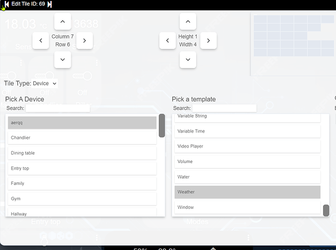

Hub = C8 pro

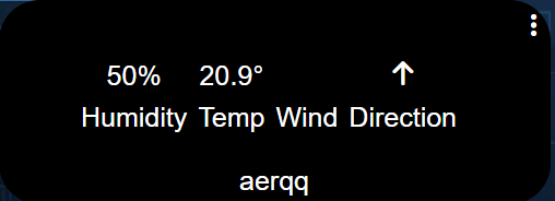

for weather template, How do i remove "wind direction". My sensor doesn't provide that and dont want to display it.

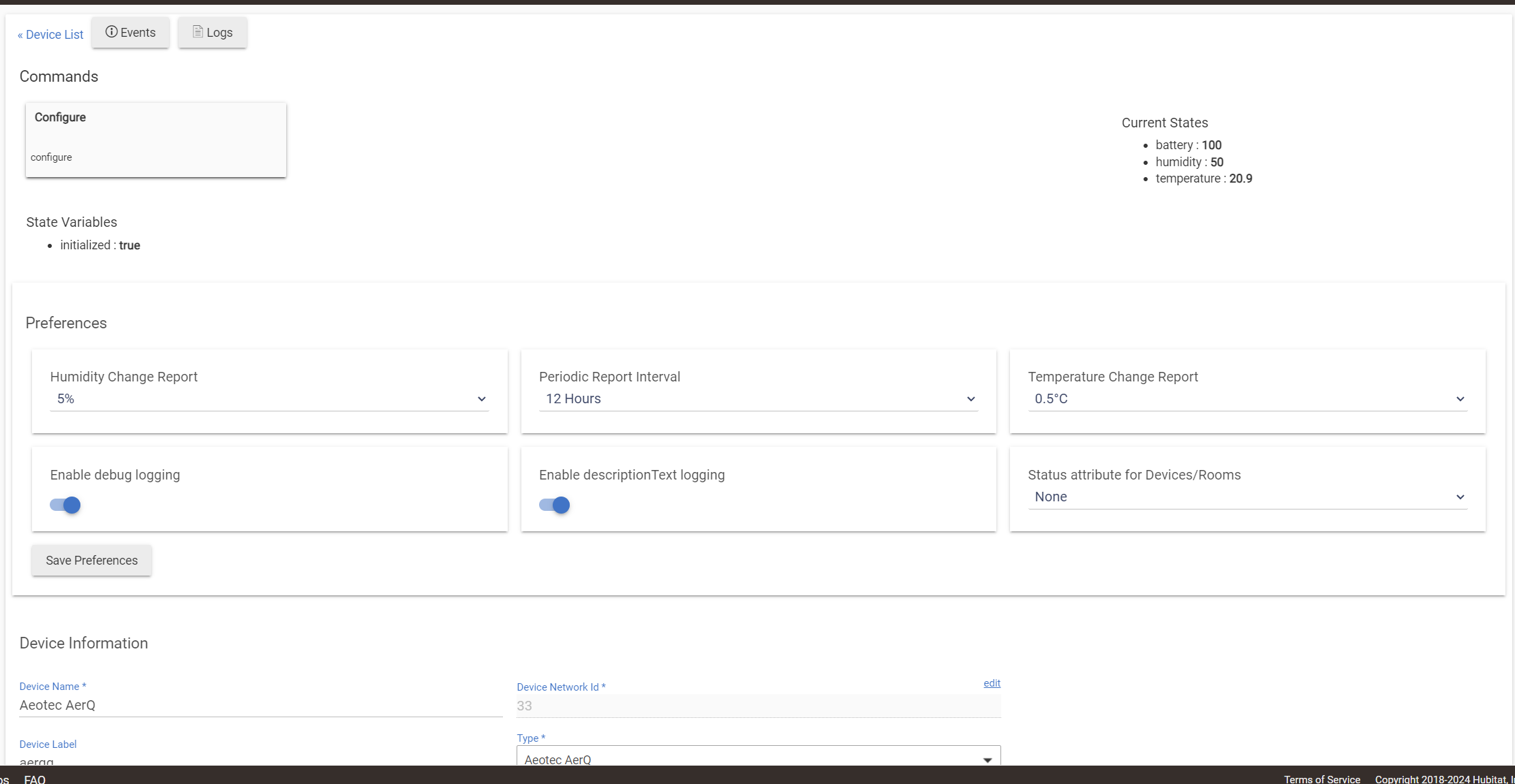

I don't think Hubitat has an attribute for mould (or mold for those in the USA). I don't think dewpoint is a supported attribute either, but maybe I am wrong about that. I am not aware of a template for dashboards that out of the box (default) has all the proper attributes. Similarly, the driver for this device probably (my non-developer self speaking here) would probably require a new attribute for these non-standard device types, and the driver would need updating as well.
For now, the easiest thing to do would be to use the "Attribute" tile, and put individual tiles for each of the things you want to list, and that are currently available (temp/humidity) or maybe the multi-sensor tile would be a closer match.
I am going to tag @gopher.ny here for the dashboard, but @bcopeland the Z-wave specialist should probably look at the driver as well.
