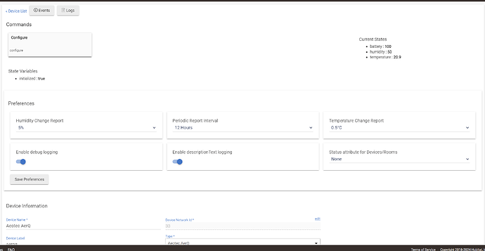

But in device details, i only see temperature and humidity.
how come i dont see mould and dew values?

This has been discussed previously, and the reasoning is that it is simply a value calculated based on temperature and humidity, which is all the sensor really measures:

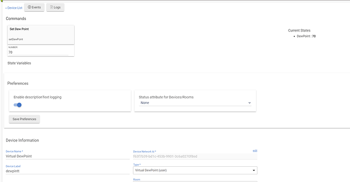

i used the following app and virtual device.
I can only see the following
how i get the graph that he has?
Not sure if the driver could be made to report whatever the device is reporting for this.
But FWIW there’s no way that little sensor is “measuring” mold. So I’m not sure what the point would even be.
If a space is hot and very humid, the conditions are right for mold to grow. Monitor the temp/humidity and control that, if needed, to prevent mold growth.
Indeed. Temperature and humidity are used to calculate a dew-point. The sensor has a dew-point cutoff to calculate whether ambient conditions favor mold formation.
I explained all that in this post from the the thread that @anitesh.a.kumar linked to:
He used HubiGraph. You can use WebCoRE. And note that he used an app that calculates dew-point.
Yeah. Granted I have since migrated over to [Release] Quick Chart - Chart your data, quickly and easily
And for the dew calculator I use the code I posted in that post you reference.
