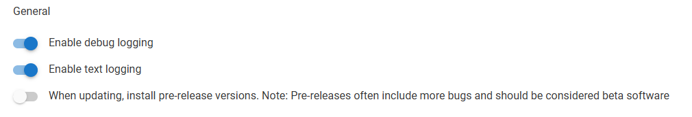

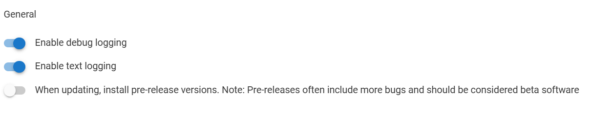

There is an option in the settings which seems to indicate there is support for it:

I think it's:
"betaVersion": "xx.xx.xx"
"betaLocation": "http......"
that's what you put in the sample :wink: hubitatpackagemanager/sampleManifest.json at main · HubitatCommunity/hubitatpackagemanager · GitHub
Thanks I knew I saw it somewhere before, that was probably it. I was only looking at the actual docs and could not find it.

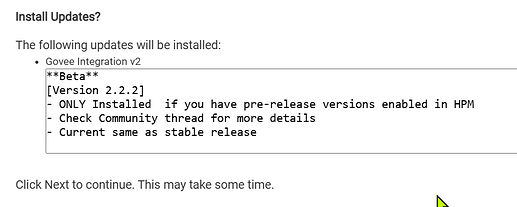

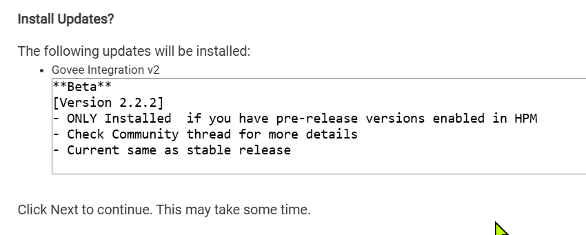

The changes made are if you add a tag for betaReleaseNotes you can now display different notes based on what is being installed.
Here is an example of what i mean so there is no confusion.
  "minimumHEVersion": "2.3.2",
  "dateReleased": "2022-09-13",
  "releaseNotes": "stable Release note information",
  "betaReleaseNotes": "**Beta**\n[Version 2.2.2]\n- ONLY Installed  if you have pre-release versions enabled in HPM\n- Check Community thread for more details\n- Current same as stable release",

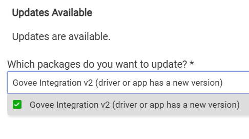

Lastly and the item I need to test more is the option to update based on bundle version change. Not sure of a good way to show it right now. It did trigger based on version change, but i didn't see it download it and install it. I need to verify that before i can say it is 100%. i am not 100% sure it failed because as you pointed out above there are some strange things with bundles that don't exactly match the other stuff's behaviors.
I just confirmed, it does appear based on logging and further reviewing of the logs that it did update the Bundle. Woot.

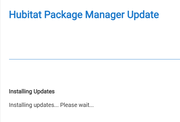

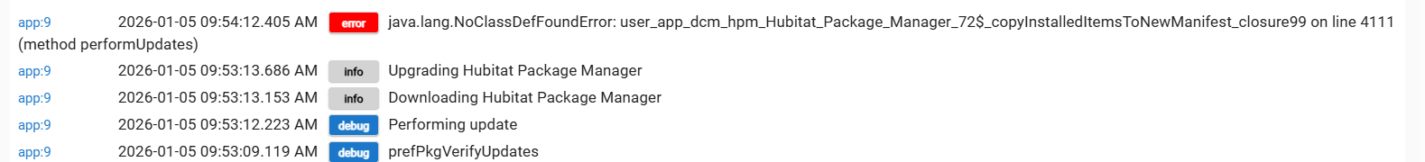

Oops...appears to be stuck during update, same on C8-Pro, C7, & C8:
26-01-05-4730
That happens often, the app is trying to update itself so depending on what code gets moved around it can break itself... Just close it out and then go back, it should be updated. If not run a repair on HPM.
Logs...OK, I'll give that a try.
New feature isn't working for me, same on C8-Pro and C7. Did an HPM repair of itself to make sure HPM was on the newest code:
26-01-05-4735
