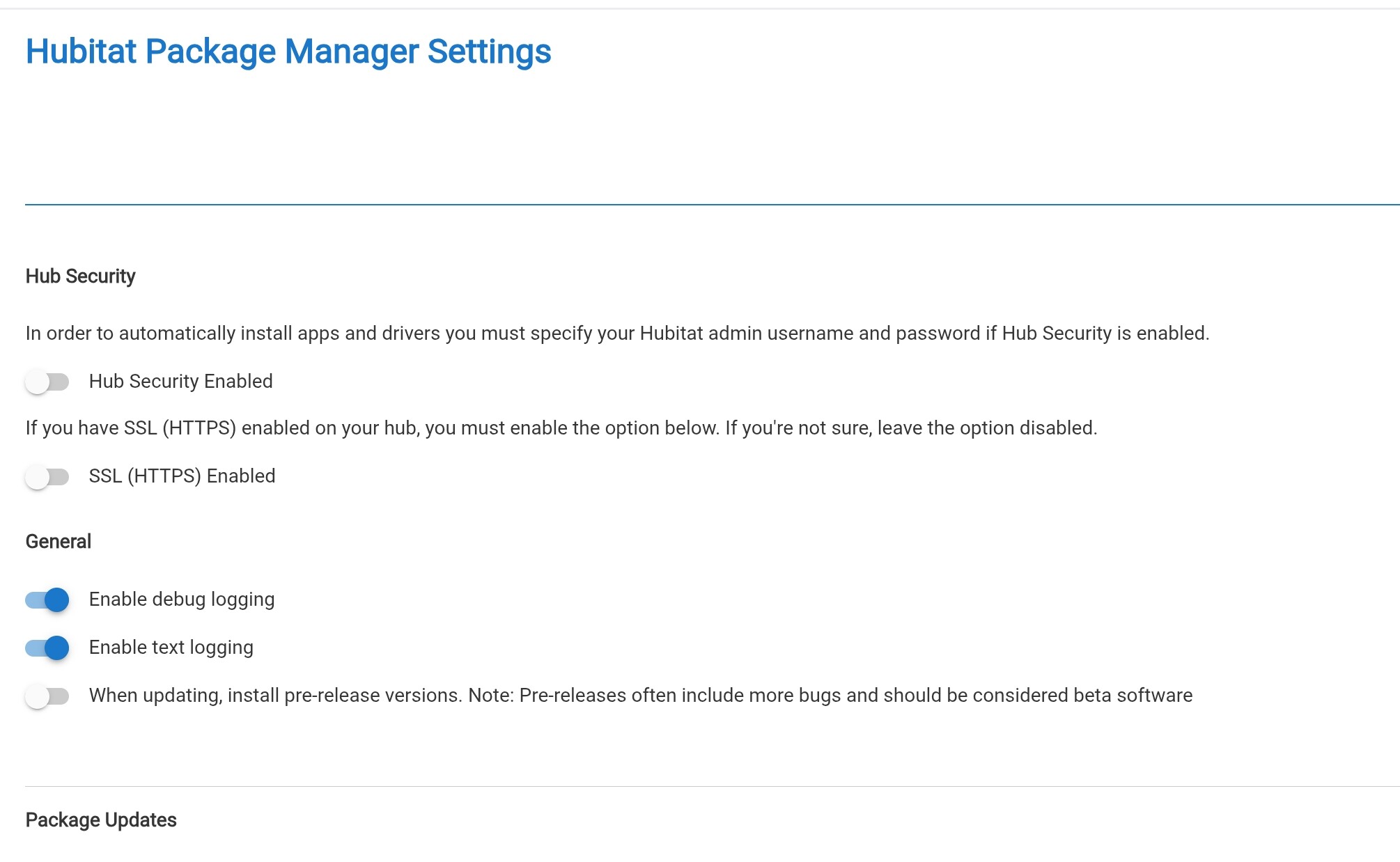

With "pre-release" disabled, as you show, I Installed Govee v2 as if it were the first time. It installed correctly.
I then ran Update and it (correctly in my opinion) found no update.
If I then enabled "pre-release", and clicked Update, I was presented with an update and saw the Beta release notes. The install of the Beta went correctly.

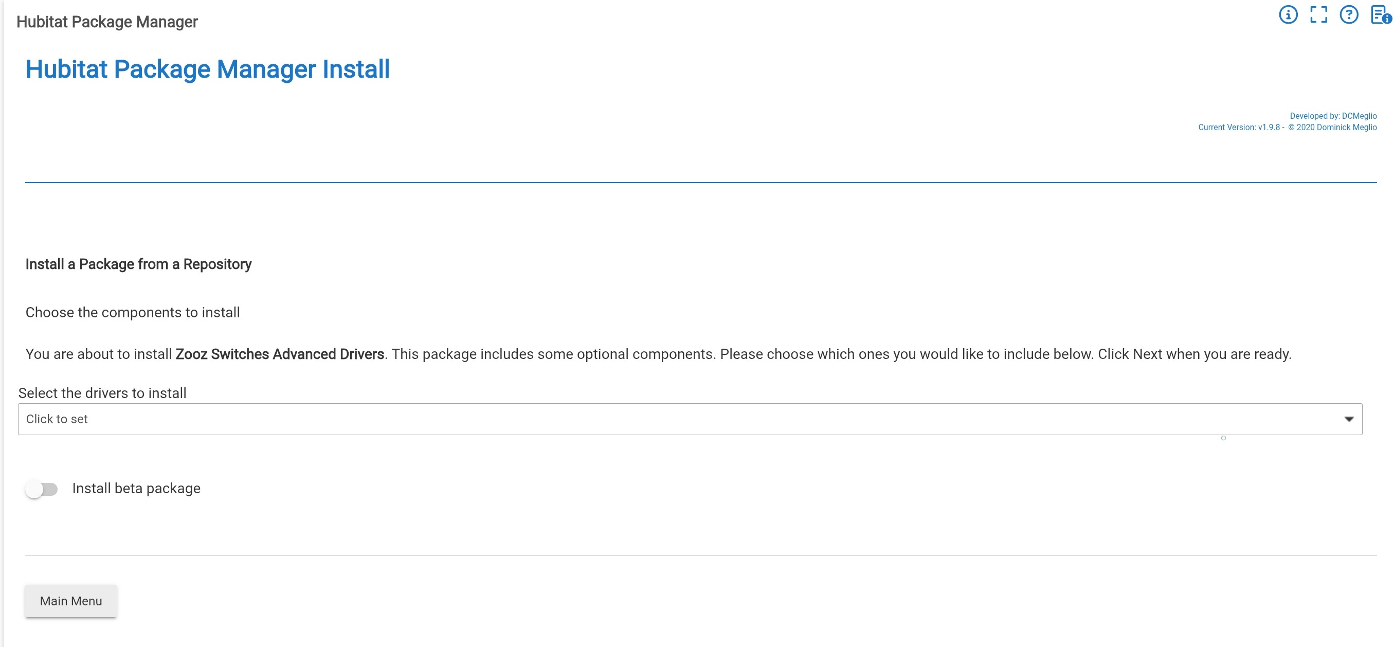

Only during installs you will see a toggle to install beta. This will tell the install flow you want to install the Beta option for the package if avalaible. Below you scan see the example when you go to the selection page for what drivers to select to install. This was added simply because you may want to install a new package and try a new beta feature out. Now you don't have to install it, Update the setting, and then Update it. You can just install and go straight to beta.

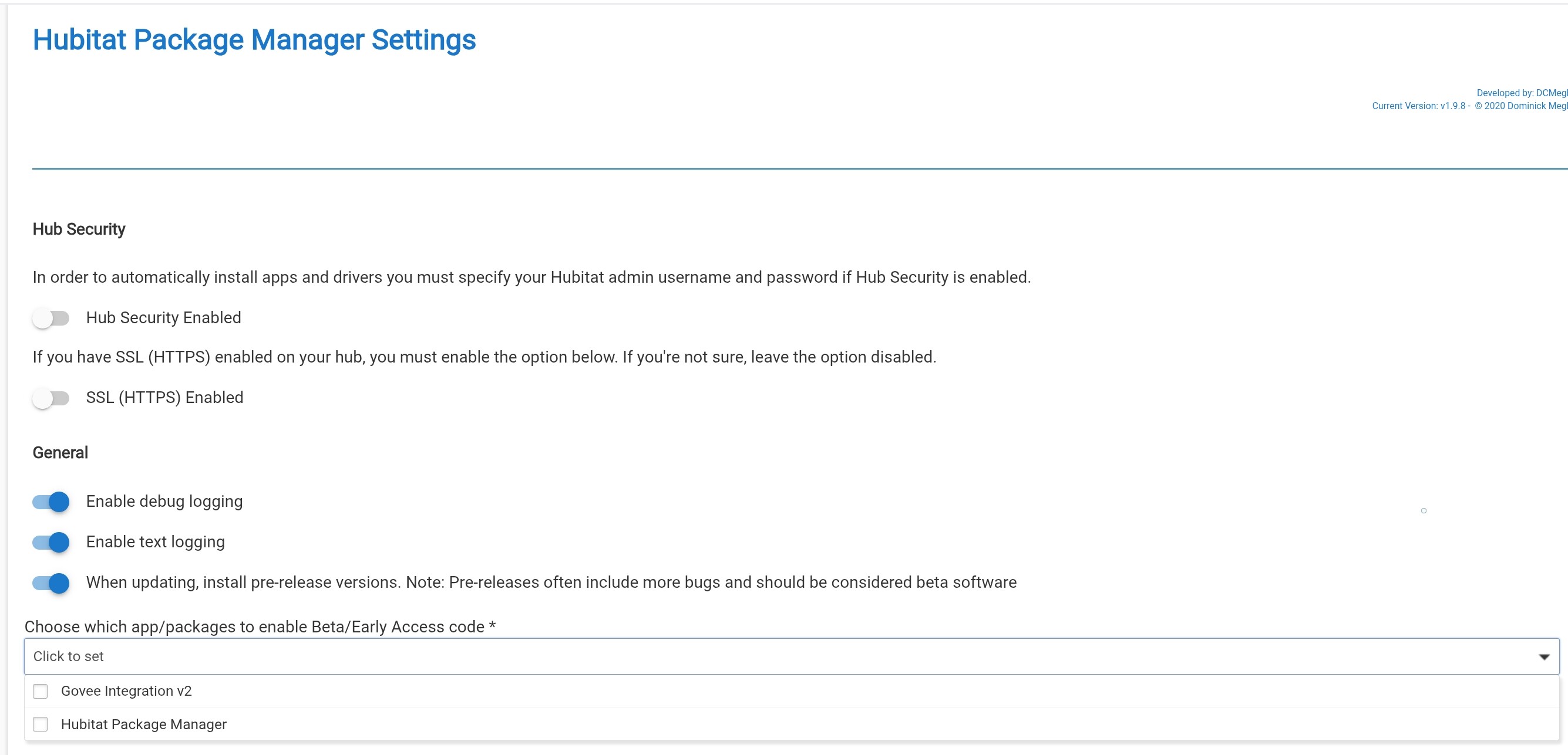

The option in the preferences will still be there as shown here. Similar to before there is a toggle to enable installing Beta. Once it is selected another option appears to select the package/service/app you want to be part of the feature.
Here is what it will look like after the option is enabled.
If you install a package and hav PM isntall the beta, it will update the toggle on the setting page to "on" if it isn't already and it will add the package to the selected packages for beta install.
