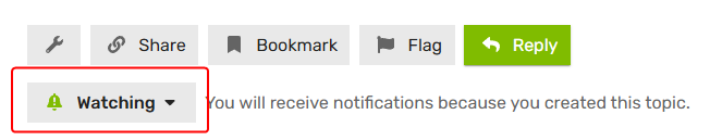

:eye_in_speech_bubble: Set this topic to Watching, to be alerted of new beta updates

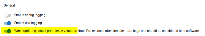

:eight_spoked_asterisk: How to get beta versions from HPM:
  • In HPM, go to settings and turn on pre-release versions
  • Run an update in HPM to get the beta version
  • For further Beta updates you may need to run Repair to get the latest code
  • Beta version can be confirmed in the View Apps and Drivers page in HPM

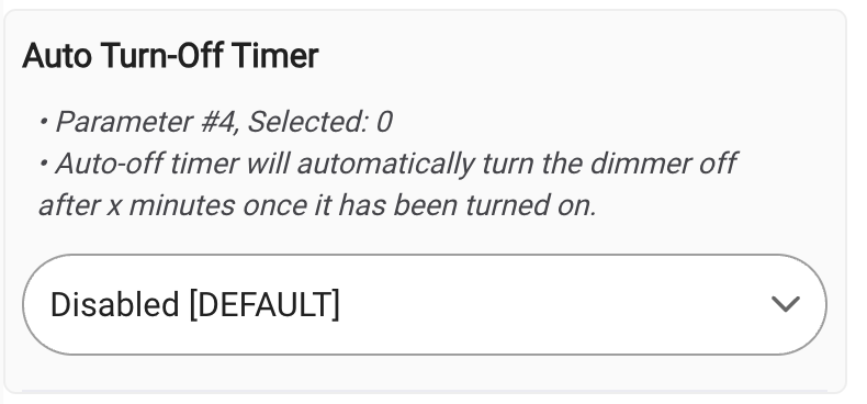

For the ZEN 22, I don't see parameter #3. Does the following smartly take care of both 3 and 4?
I've also noticed that the preferences are in different, seemingly random order between the ZEN22 and ZEN72. One seems to "sort" in order of parameter and the other one "sorts" using the Windows number sorting - 1, 2, 22, 23, 3, 3x, etc.
Yes I will be adding it, thanks for reminding me. I assume when you use that driver none of the settings are presented? That will get fixed when I add it officially.
Yes, when you set it to Disabled in the back end it disables it via the other hidden setting.
They should display in the order I have them in the code, and settings that are identical (or very close) across multiple devices are all the same entry in my list. So they should be in the same order. There are a few settings which are in the 2x but not the 7x and visa-versa but I try to group them together by function similar to how the Zooz docs groups them.
What model and post a screenshot of the one that seems to be sorting lexicographically (1, 2, 22, 23, 3, 3x). There is a possibility when I am moving the data around in different Maps it is getting sorted by the settings number somehow. Used to always work fine but maybe something has changed with HE back end.

This turns out to be an ID-10-T issue. :wink: There is no sorting issue, just a perception issue.

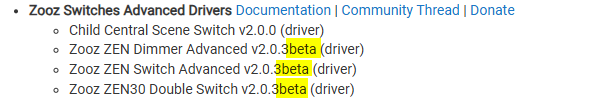

If you are already running the beta do a REPAIR on the Zooz Switches Advanced Drivers package to get the newest code. If you want to get started on the beta see instructions in the main post.

How does everyone like all the descriptions that were added?

Love the descriptions - they are hugely useful.
Whenever I get a new Zooz device, I always go through their Advanced Settings documentation for it and scribble down my own "Param / Size / Value" chart for my desired settings for its #1 thru #x params.
The descriptions in the driver then make it super easy to compare my chart to the device settings as I enter them -- it's very helpful -- thank you!
