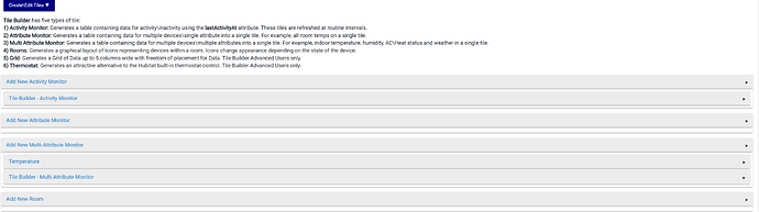

It is covered in the documentation for Attribute Monitor\Activity Monitor. But here is the short version.
Authorize the Tile Builder Storage Device to the Dashboard. (Only needs to be done once)
Repeat for each tile.
Add a new tile with Template Attribute
On the right pick the tile from the list of attributes.
Re-size the tile to your needs.

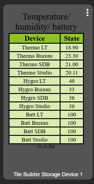

everything is perfect now :slight_smile:

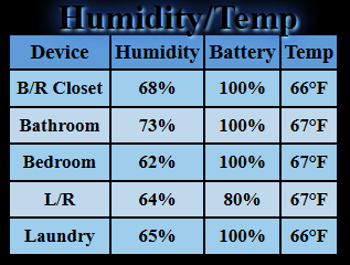

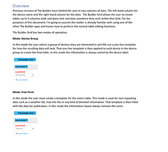

Your title says temperature, humidity, battery. If you want to display all three you would need to use the Grid module.
But good start. Lots more to go.
Wow thanks so much again :slight_smile:
I ll try this one for sure
Amazing :sun_with_face::pray:
Yes, grid is highly recommended.

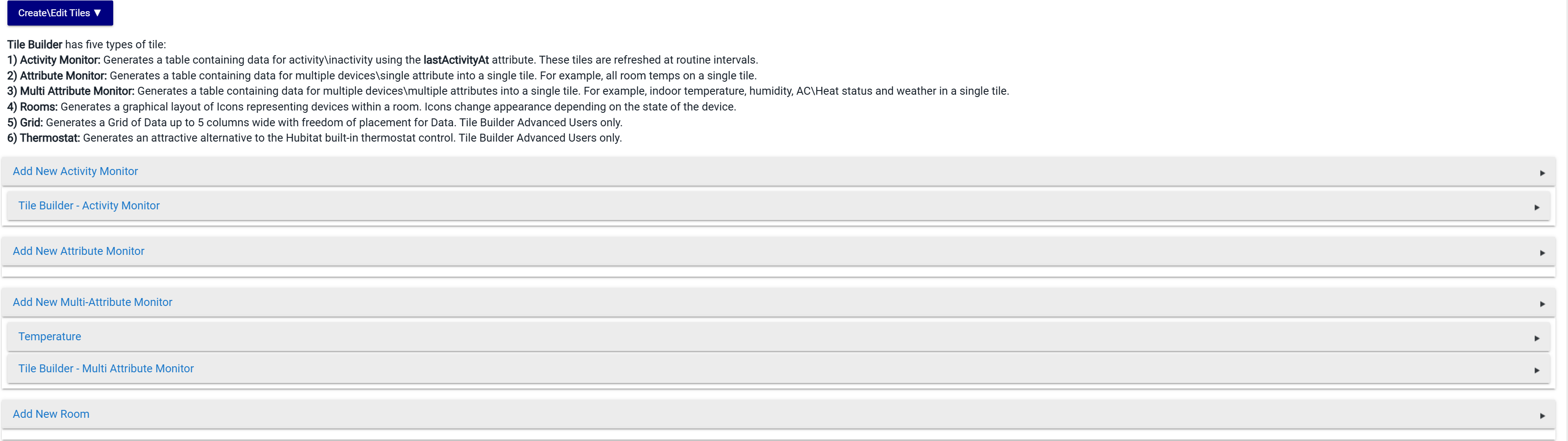

@CAZ I am trying to find out how to create the grid. I found the help doc
but the thing is that I cannot find any info on how to start creating it. I do not see the create grid option
Maybe there is an info I haven't got yet ?
thanks a lot
all the best
Yiannis
I forgot about that. It appears you do not have Tile Builder Advanced. It is only unlocked via a small "donation" to the author. If you are interested, head over to the Tile Builder thread.
Edit: Actually, you do it right in the app. Open the "Licensing" section.

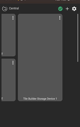

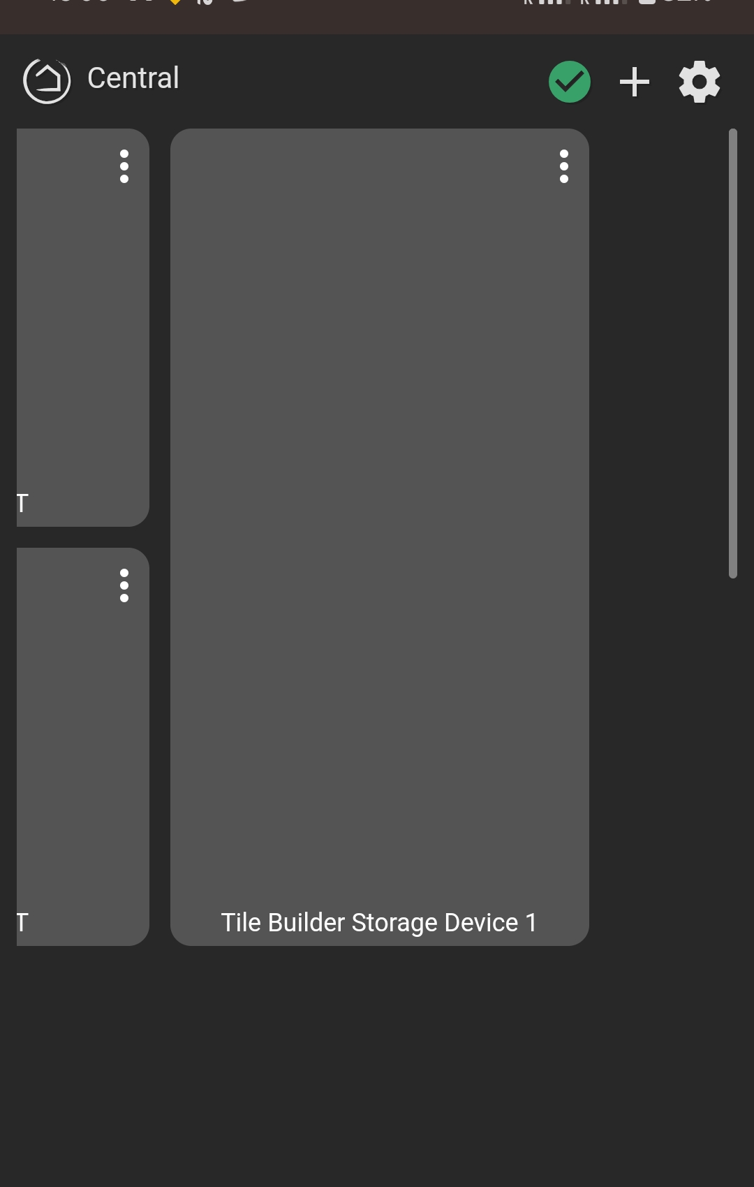

Hi everyone
As I am away from home I tried to connect to remote hub and everything works fine but the tile that I created lately.
I cannot see the numbers.
Do you know if I have to do sth in particular ?
Thanks so much.
All the best
Yiannis
If you want Tile Builder tiles to be accessible via the App you must either keep the tile size under 1Kb, use a Cloud Endpoint or use a VPN.
