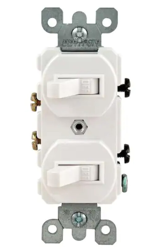

Any chance they ran more than two wires to the existing wall switch? :thinking:
If so, you could use something like this with a Zen16 to trigger with one switch and disable with the other.
Another option (if not enough low voltage wires) would be to use the existing physical switch as as the emergency disable switch, and an RF button controller device (Z-Wave, Zigbee, Lutron, etc…) as the manual trigger to turn on/off the fireplace.
