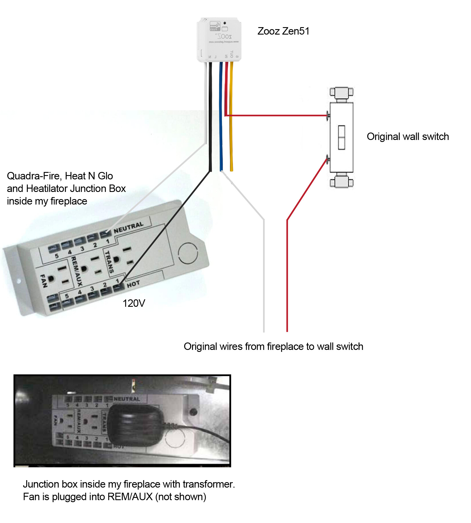

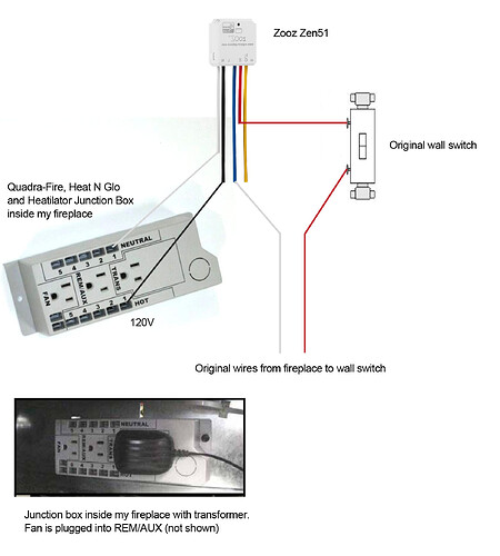

How do I control a low voltage fireplace using an AC powered smart switch
Here is my plan. I realize that the wall switch will not be synchronized with the ON/OFF of the smart switch (Zen51). But this design allows me to turn off the fireplace when not in use or if there is a problem with the smart switch. One problem with this design is that I cannot MANUALLY turn on the fireplace, overriding the smart switch. Maybe there is a better solution to allow that.
