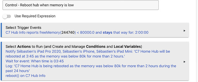

Here’s how I do it. I have it wait until 3:45am as I would rather avoid rebooting it at the middle of the day, but this is just a personal preference.

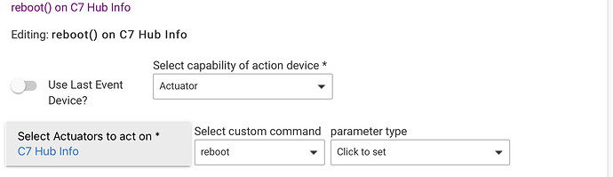

The “reboot()” on C7 Hub Info is a “Run Custom Command” on the “C7 Hub Info” device.
It’s that last bit I can’t do and what I’m looking for. When I select run custom command, it demands a capability rather than just let me select a device.
Select “Actuator” and it should show the Hub Info device. Here’s how it’s setup for me (it will likely look a bit different for you as I am on the next Beta version) :

Thanks I’ll take look when I get home. I’d have never guessed actuator
Yea, most devices have that capability and hence it works most of the time.
