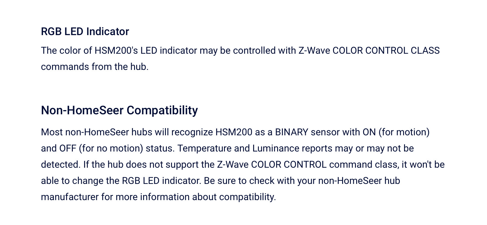

I was thinking that might be the issue based on what I was able to find on Homeseer’s website.
It’s not entirely clear to me how Zwave JS might be impacting it but I feel like the issue is related
