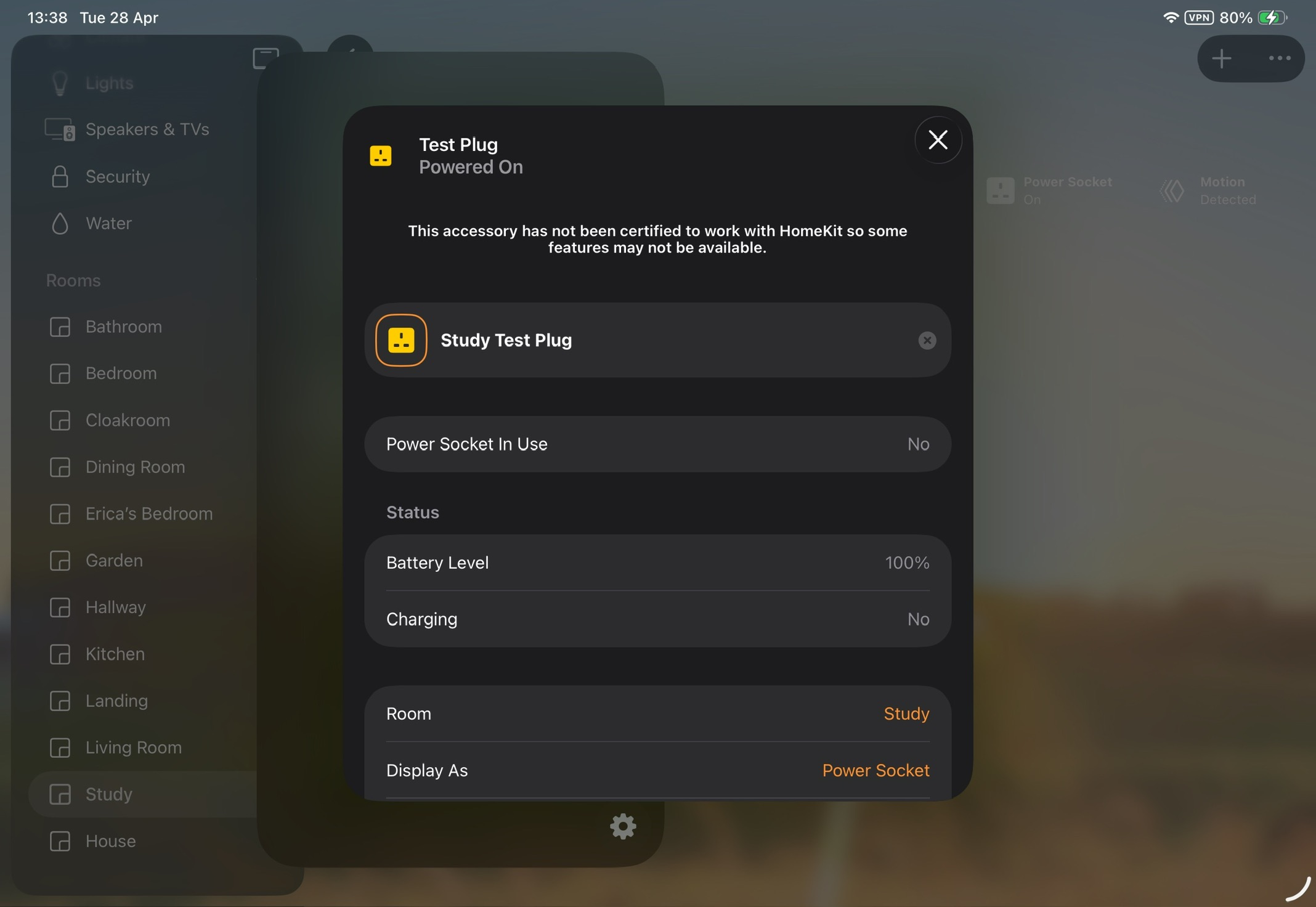

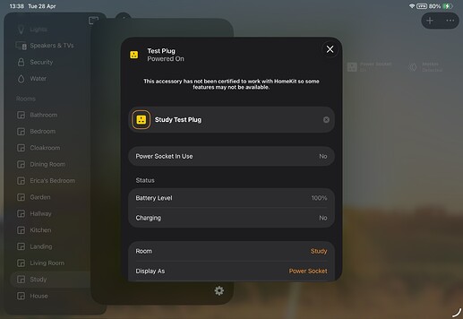

Hey folks, just wondering if there's a means by which battery charging status can be kept up to date in HomeKit? Taking my Test Plug as an example, it has an internal battery, and it reports as charging in Hubitat. However, this "charging" status never makes it to HomeKit, where it always reports "Charging: No".

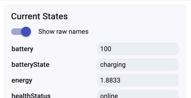

The driver is providing batteryState in Current States like this:
Is there another means of doing this such that the HomeKit Bridge integration will carry it over?

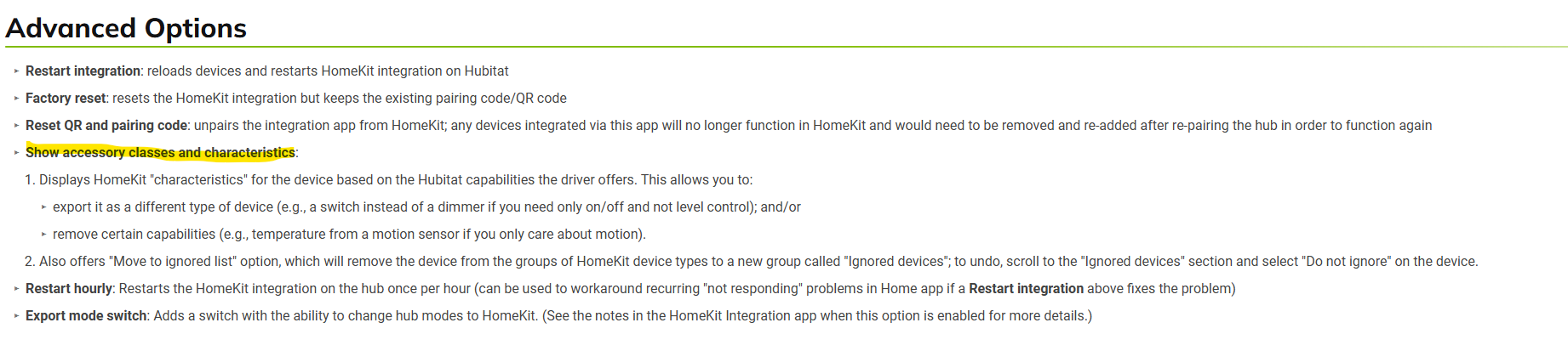

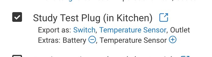

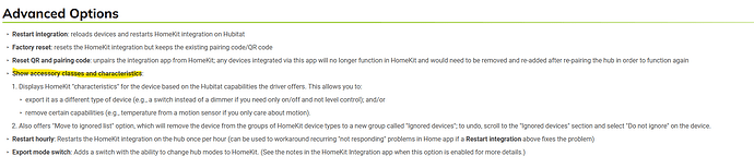

In HomeKit Bridge, see if that device has an option for that under Advanced Options --> Show accessory classes and characteristics.
Not for the charging status, sadly.
I could add something to the driver, if I knew what I should be adding! :slight_smile:
