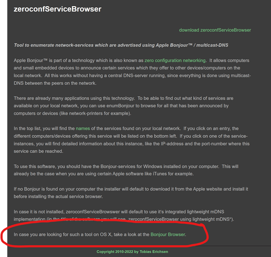

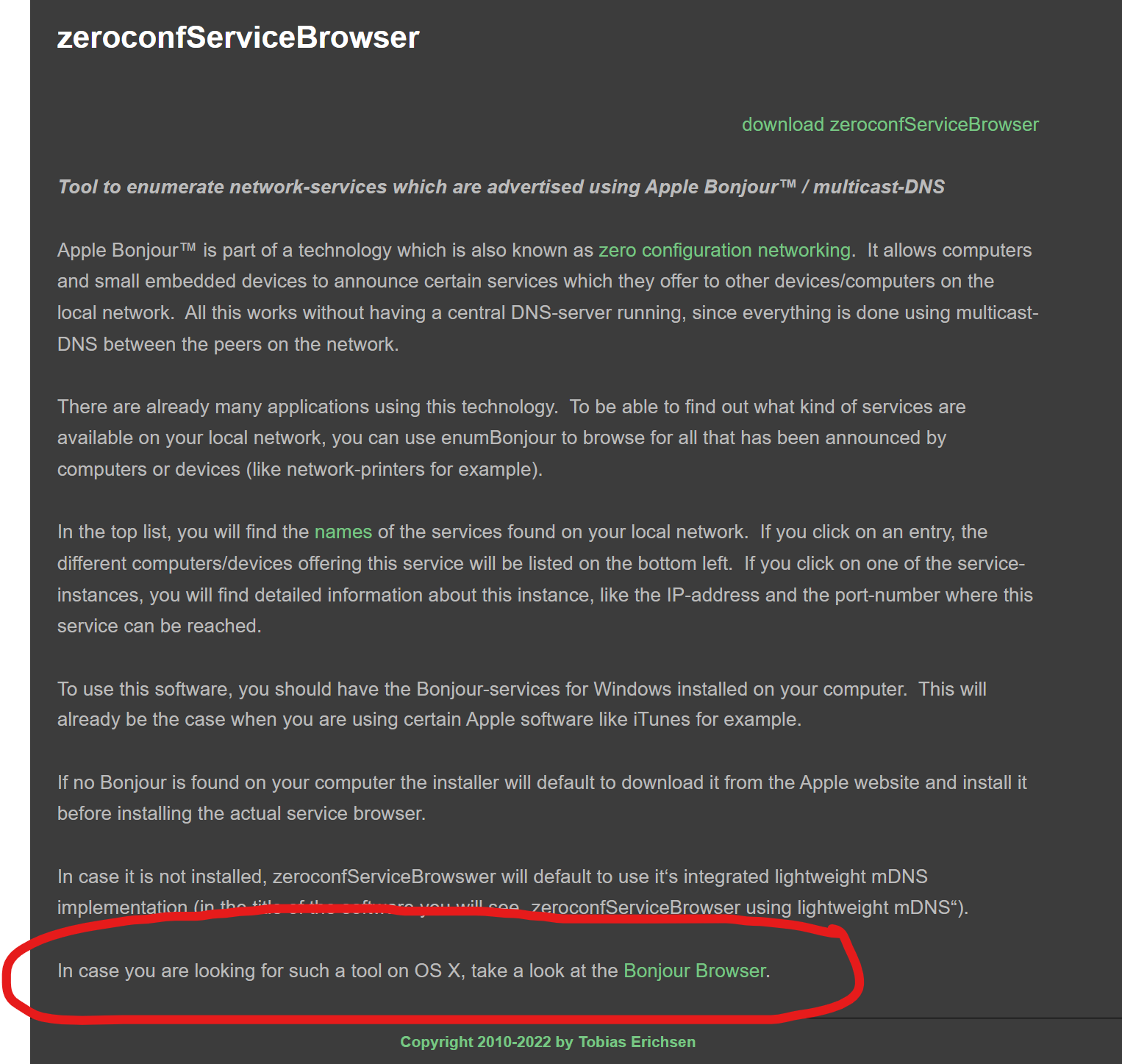

You would want to look for the "hap" section and then look to see if the hub shows up in there. This would tell you if the mDNS broadcast is at least making it to your PC.
(Sadly) I don't have many friends with a windows machine. Thought of going there myself. I will ask around to see if someone can visit me and try the software. I did look on the router (search and doc search) for mDNS settings and did not find a mention of it for my WiFi 6E capable router.
I have done Airprint from iPhones and iMac - which use Bonjour (a mDNS implementation - if I read the comments). So the router supports that. And AirDrop for that matter (no pun intended).
