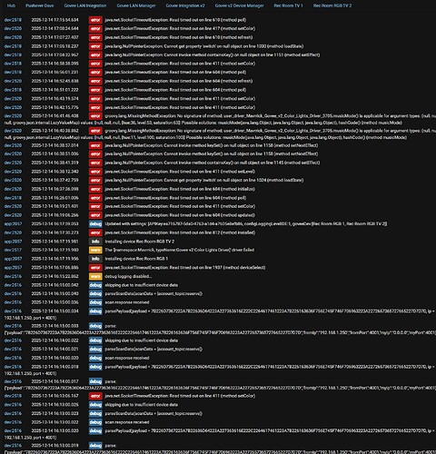

Atleast the errors in the logging provided are related to the installed Google Home app and the Govee LAN Integration. Both of which are built in apps.

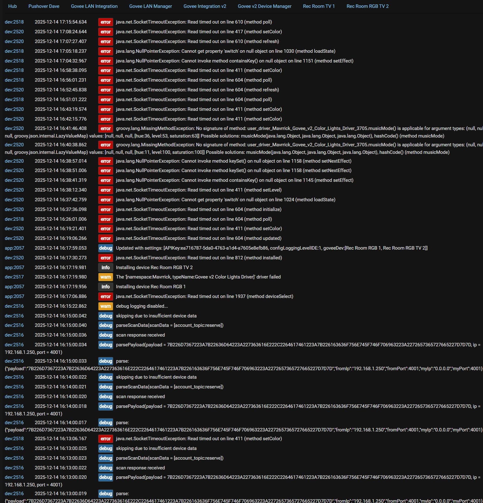

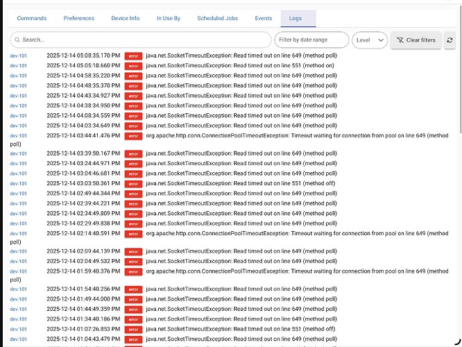

For some reason I noticed all my Govee lights are really slow. Ex I have Govee RGB strip light come on when motion is detected. Before there was a 1 or 2 second delay. But now it’s like a 30 second delay. Just started happening a day or two ago. I’m also seeing a lot of errors in the logs. I didn’t change anything, did a hub reboot some thing. I do have 14 Govee light strips. Maybe I should make some of these lights lan only maybe it will take off the load.

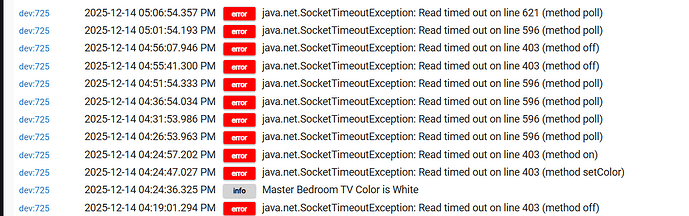

The timeout errors are related to not being able to establish a connection to the Govee Cloud API Server. As i suggested above i would suggest reaching out to Govee Support and explain you are seeing timeout errors. It looks like they started again just after 12pm.

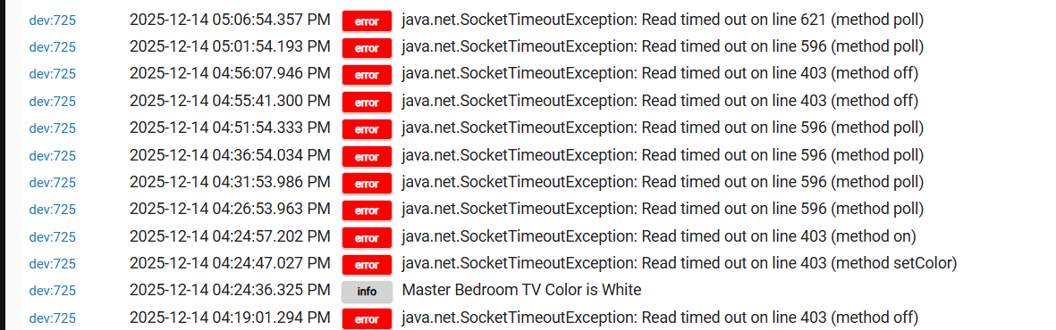

It started with me 12 hours ago my non-lan API TV lights are very slow and seeing the same timeout errors in my logs also. I hope Govee is only having a performance issue and not making breaking changes.
It’s good to know I’m not the only user having issues. This seems to be a Govee server issue. Like you said hopefully they didn’t change anything to give us users a headache.

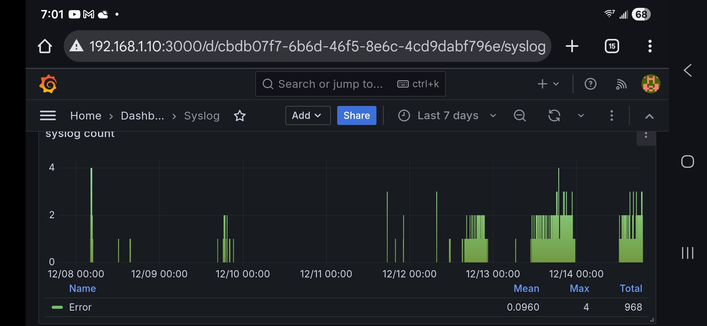

Unfortunately we know for a fact Govee made changes to their Developer API because of the change that broke the SetEffect command. Since that change we have seen sporadic instances of these timeout events. I have been tracking it in my log server showing when devices start to get timeouts. It has been coming and going almost daily since that change. Prior i would get an occasional timeout here and there over several months.

That is filtered on Timeout being in the logged error.
That really is a possibility. I have seen that before for apps. A new call or process is introduced and it induces a unexpected load and then the app can't respond fast enough and the connection is considered timed out. Since the call was actually recieved though it process just really slow. @Sodfather experience would tend to lean to that being the case.

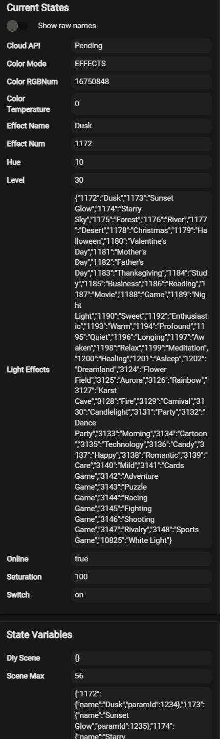

Searched but didn't find a list of Effects in either.

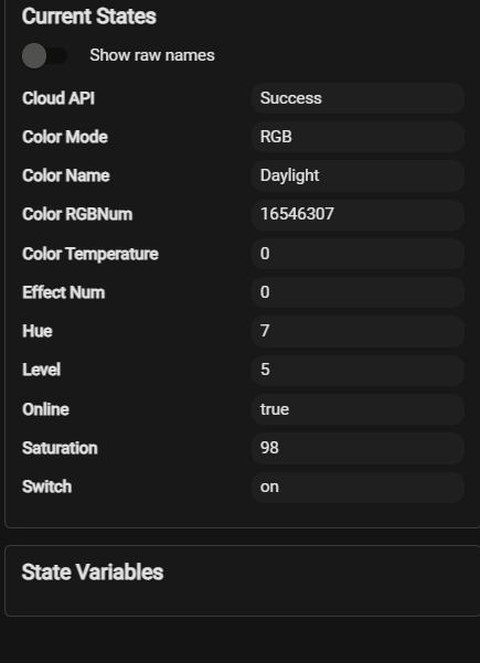

One bulb has very little States and it's identical twin goes on forever?
Govee v2 Color Lights Driver. Bulbs are H6008.
There are many driver ver to choose from but that was the automatic choice.
Some of those states are populated by the cloud API. So if it is timing out that may be why it is failing to populate those states.

And the logs, Oy vey, the logs. :slight_smile:
It looks like things have been better since a little after 9pm eastern or about 1 hour ago.
