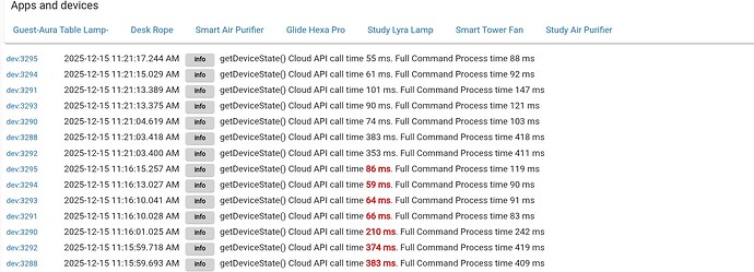

I have a new build with the Govee_Cloud_API library updated to use a 60 second timeout value instead of the default 10 seconds timeout that is used when not specified. It also has logging to show how long the calls are actually taking. Here is an example of the logging. I added color coding to show when a call gets over 10 seconds for the API Call part of the action. Below you can see the response with the color coding before i adjusted the value to trigger the color.
If we see the issue pop up again, I will publish it so users can see what is going on. The first time wouuld be specifically the time between sending the call/post to the API and getting the response. The second time value is to complete the whole routine in hubitat. That would mean not only getting the response from the api but also any post processing after the response is recieved.

I just updated the bundle file with the retry logic to include the api call timing code changes. I also adjusted it so that when a call takes over 10 seconds it will be logged as a warning instead of info to help it stand out since it is a problem.

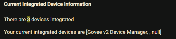

Just poking around as I play with some new-to-me bulbs.
I guess this should show the 2 bulbs I just added?

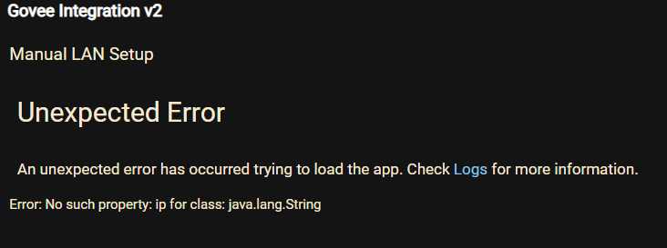

Clicked Manual Lan Setup
Why are you using Manual LAN Setup? Do you have a Govee API key? Do those devices support LAN API
I have an API key and the H6008 bulbs say they are not LAN devices.
I was just clicking on the app and exploring.
Just mentioning in case some of these clicks should be handled. Prevent dummies like me thinking something was wrong. :wink:
This first error I thought would show my 2 bulbs not ,,null though.
yea.. with no LAN API Devices that will fail, and you are right in that it could be written to prevent that behavior. I will look into that.
