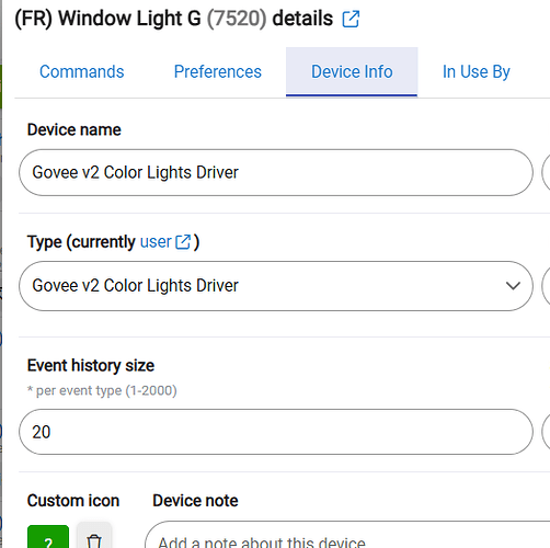

It's a Curtain_Light H70B1

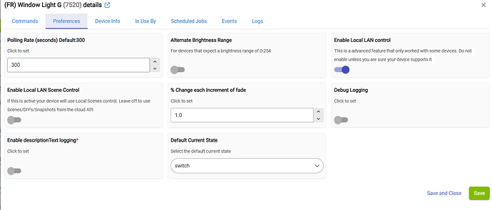

Im using LAN control but cloud for scenes, I did try local scenes as well but was the same.
Curtain lights and Net lights have issues with there scenes using the LAN API. In the preference leave LAN Control on, but turn off the option for "Local Lan Scene Control". It is a known issue with those devices.
Those two devices are the reason that option exists.
Lastly go back into you Light effects show app and adjust the scene selection as well
Woops after a second look at your settings it is that way. Try turning on debug and sending me the log output when it fails.
You need to verify that the light effects show app selection is valid. Go back into it and verify each scene is selected as expected and then click done or next until you are out of it to make sure the setting are valid to the state of your device configuration.
