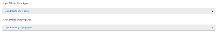

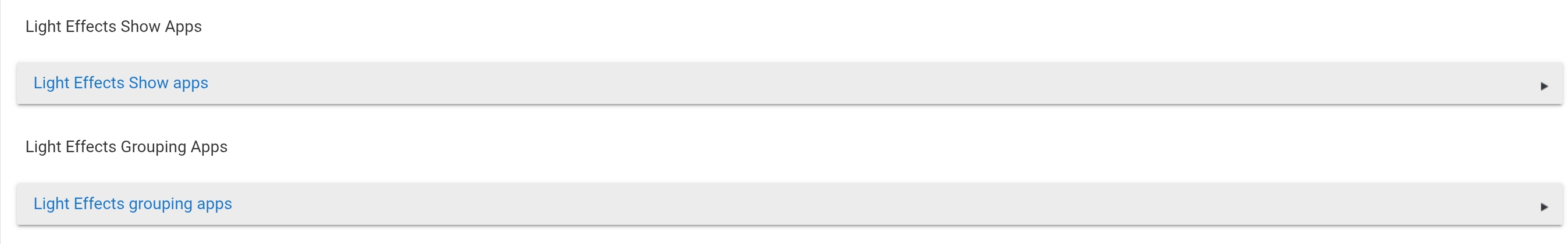

Once you open the Light Effects Tool click on the button for the "Light Effects Show Apps" to create your first app.

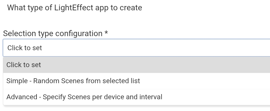

The next field to populate is related to the type of effect you want to use. Select "Simple" if you want to simply specify a list of scenes to use and then let the app random choose a new scene to use. Use Advanced if you are using multiple devices with multiple scenes and want them to have scenes that stay to gether when being processed.

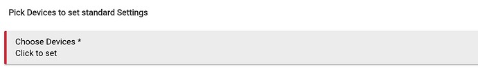

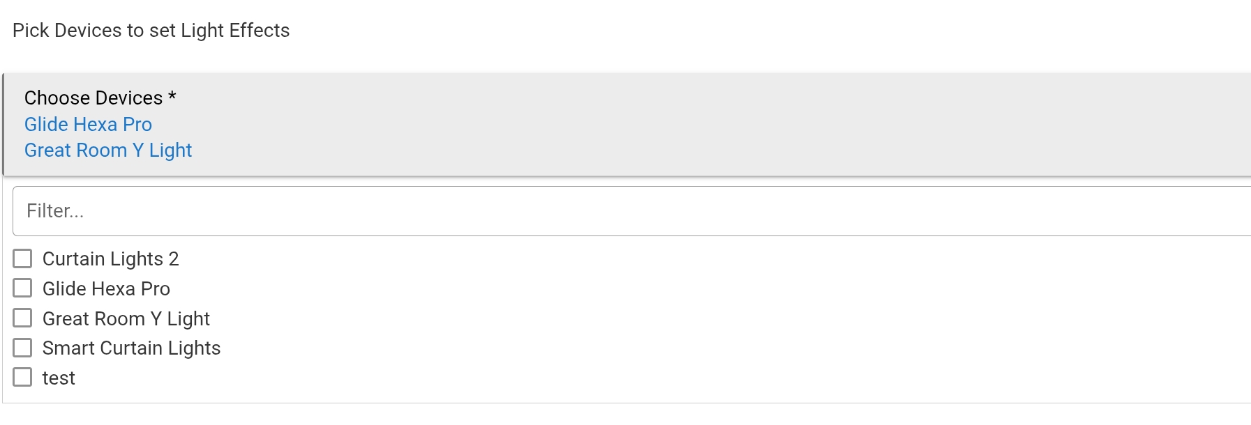

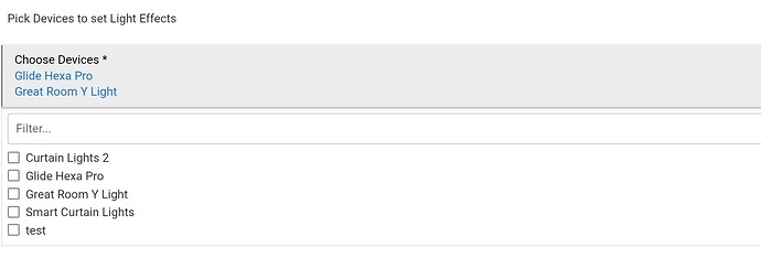

Now click on the option to "Choose Devices" and select all of the devices that will be involved with your light Effects. You can see this below.
Only devices that suppot the lightEffects Capability will appear here.

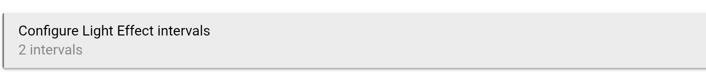

Now click on the button "Configure Light Effect intervals" to select the effects for the devices aind interval configuration you selected above.

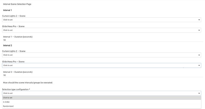

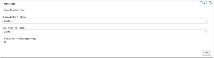

This will load a new app page as shown below. This page is heavily impacted by if you selected to setup a Simple or Advanced configuration type on the previous page.

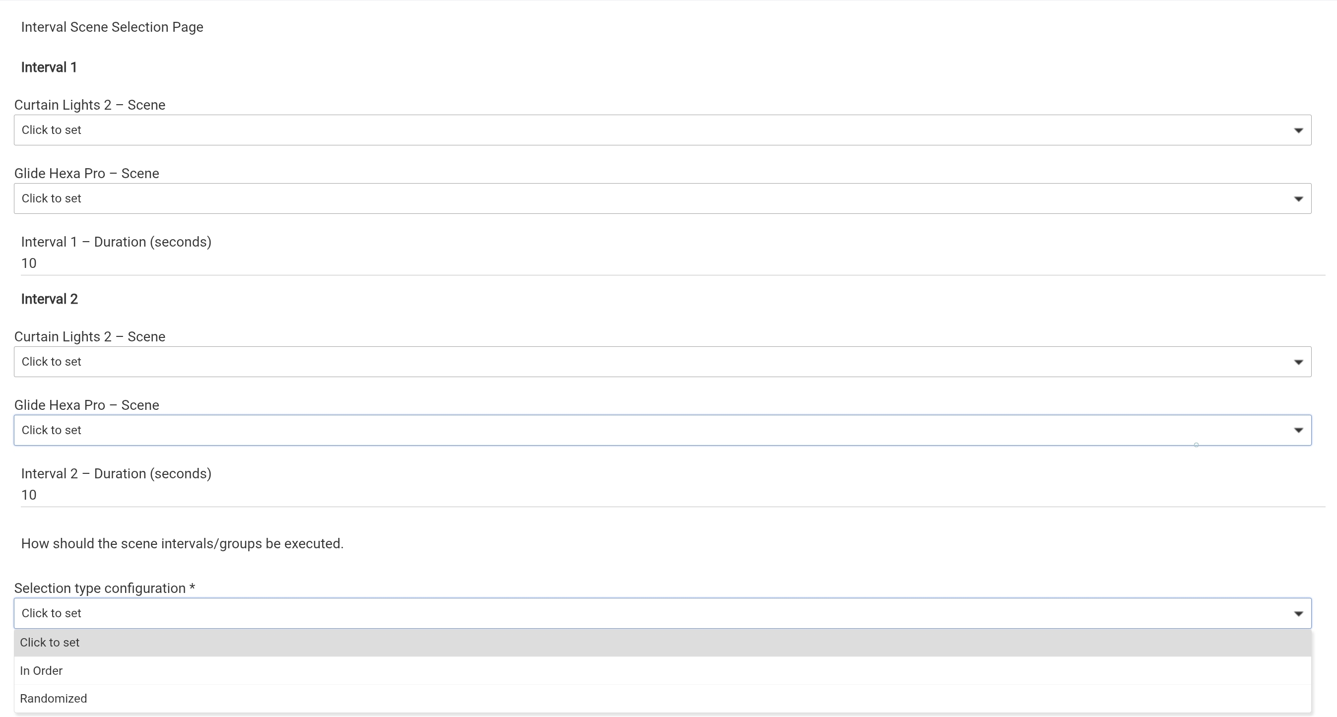

Here is what the simple selection displays. you have the option to select a list of scenes for each device and set a interval time between scene rotations. You don't have the option to specify what sceens happen on what interval. It is randomized.
Here is what the Advanced selection displays. With Advanced you can set specific scenes to specific intervals for specific Devices. This essentially is linking them together. At the bottom you have option you can adjust to control the order the interval groupings are executed. They can be done in order, or randomized, but kepping the scenes of a interval together.
Regardless of if you use Simple or Advanced all fields on that page need to be populated.

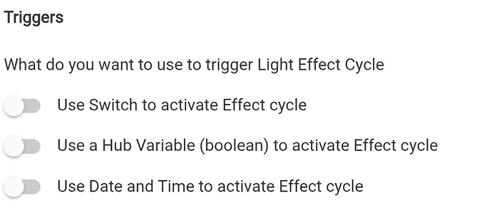

Fill out the fields and click on next to return to the main setup page. Now scroll down so you can setup your triggers. You can trigger either with a Virtual Switch, a Boolean Hub Variable, or use a Date Time option.
As you would expect the Switch and Hub Variable options are fairly straight forward. When activated you will have a option to link the app to a switch or Hub Varibable. When they either switch to On or True the app is activated. When switch to off or False the scene is dactivated.

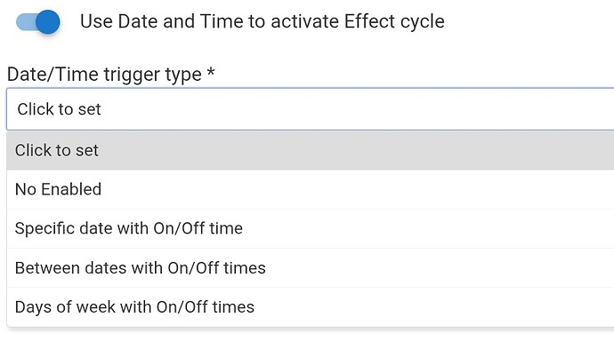

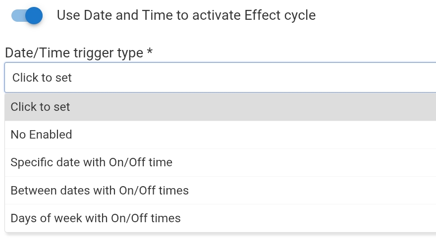

There are various options when you select to use Date and Time as shown in the image below
All of these options are fairly self explanitory related to dates or specific days of the week.. The time options will be either a specific time, sunset, or sunrise with a offset. Make sure you fill in all of the values as needed.

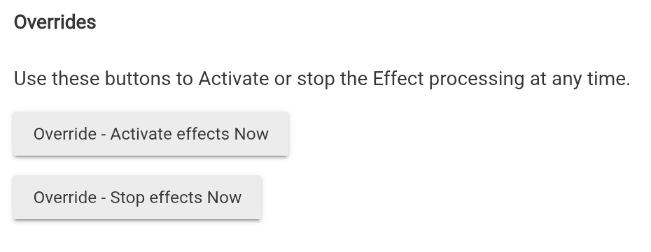

Lastly we have overrides to Activate, or Deactivate a from the app. These overrides are to allow you to either immeidately activate the scene as configured above or turn it off a active show app at any time

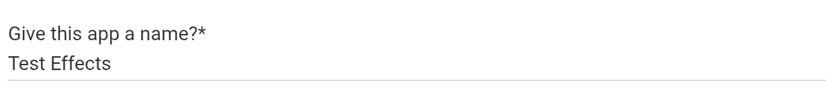

Once you open the Light Effects Tool click on the button for the "Light Effects grouping Apps" to create your first app.

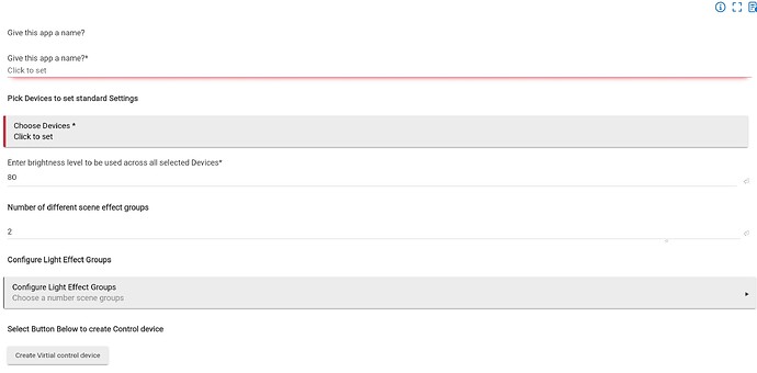

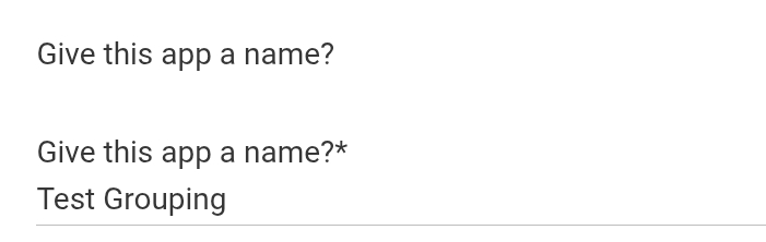

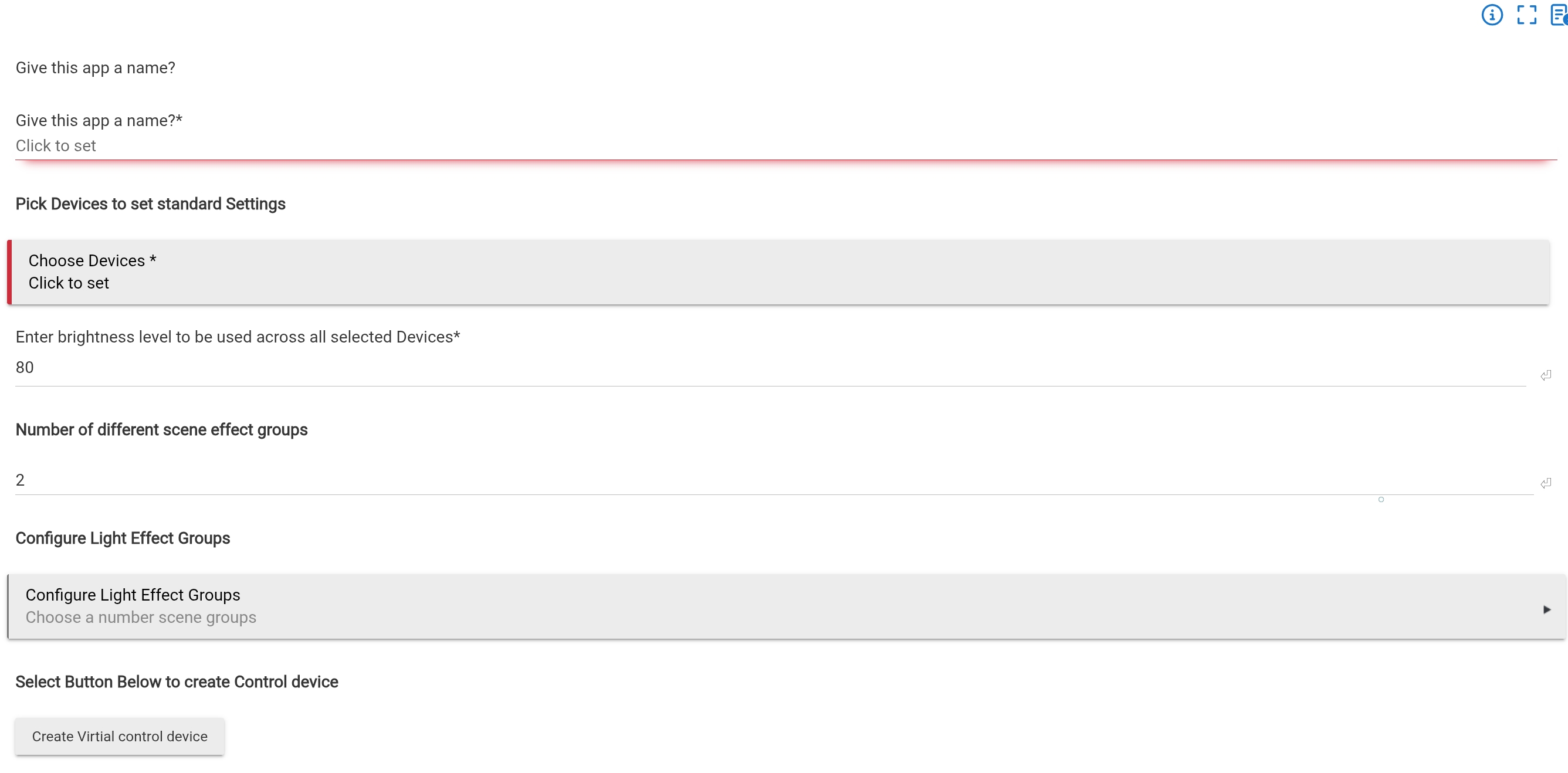

This will load you into the inital setup page with a variety of otpions. First give your new Grouping app a name. Here you you can see i specified it to be "Test Grouping"
Now click on the button to "Chose Deices" for the grouping app. This wil list any devices in your environment that support the Light Effects Capability. You shoud select any devices that you want to have as part of this custom scene list.

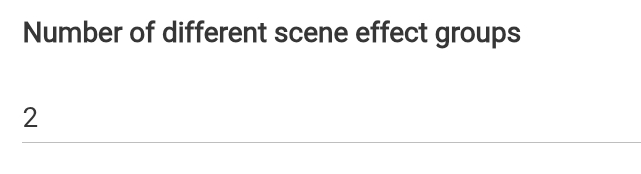

Now set the number of custom Scenes you want to configure. It will default to 2, but you can specify as many as you want. Just keeep in mind the higher the number the configuration will be involved.
capture_temp

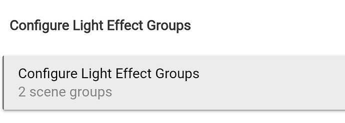

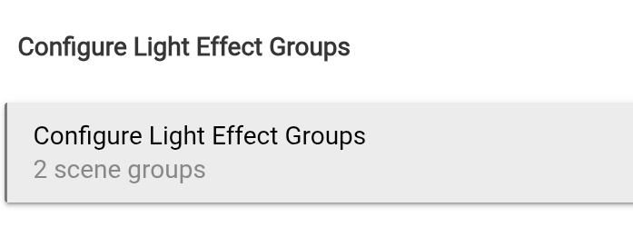

Once that value is set click on the button to "Configure Light Effect Groups"

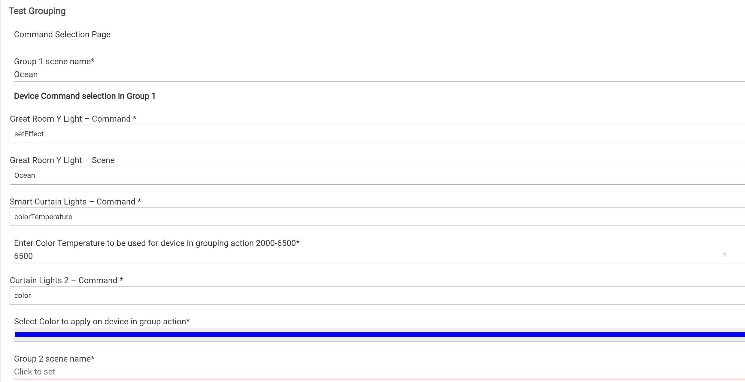

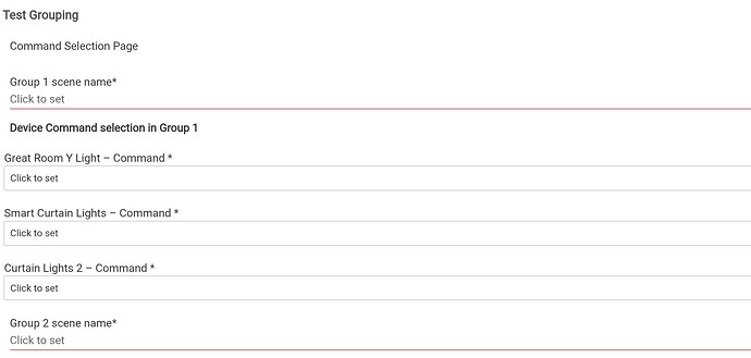

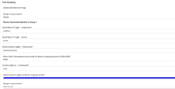

This will load a new page were you will setup each new custom scene and the scenes, color temp, or color that will be called on each device as part of the custom scene. Here is what that page will look like when you first open it up.
You will have a field to populate with a Name for each custom scene, and then a command option for each device. These options will be replicated for the quanity of custom scenes you entered. My current rule was set to 2 so I only have to fill in 2 scenes. Here you can see what happens when you specify the command. Set Effect allow me to select a scene the supported lightEffect for the device. Color Temp give me a field that i can populate a value between 2000 and 6500. Color give me a option to use the color picker to select a color to set the device to. The reason for Color Temp and Color are that you may decide that you don't have a good maching light Effect on a given device and instead chose to have a static color to make it match better.

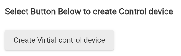

After you have populated all of the interations for custom scenes click on Next in the Lower right corner to return to the main setup page for the app. Now it is time to click on the Create Device button shown below.
capture_temp

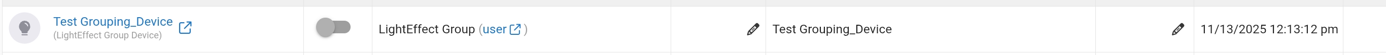

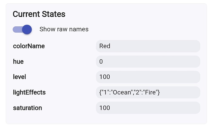

That should of created a child and then click on done in the lower right Corner to ensure all settings are saved. Now open up the device tab in the Hubitat UI. You should fid a new device with the name of the Light Effects Grouping app you had just created and using the Light Effect grouping driver as shown below

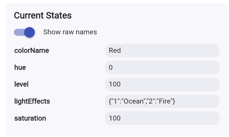

If you open up this device now will see it has a lightEffects Attribute populated witht he scenes you created from the parent app. As shown below
This virtual device will allow you to pass commands to the parent app for all options specified. Now you can turn on/off, set brightness, and set effects for all of the devices that are part of the group. When you set effects with this virtual device, it will apply the scenes you setup in the grouping app.

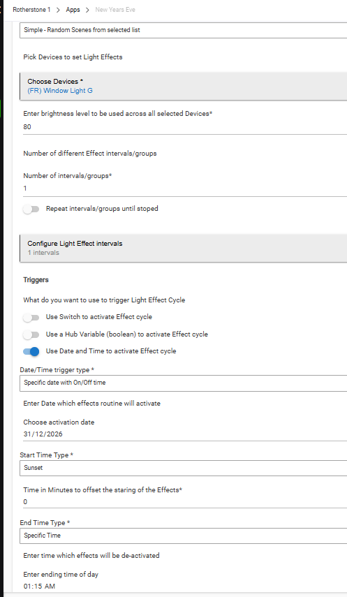

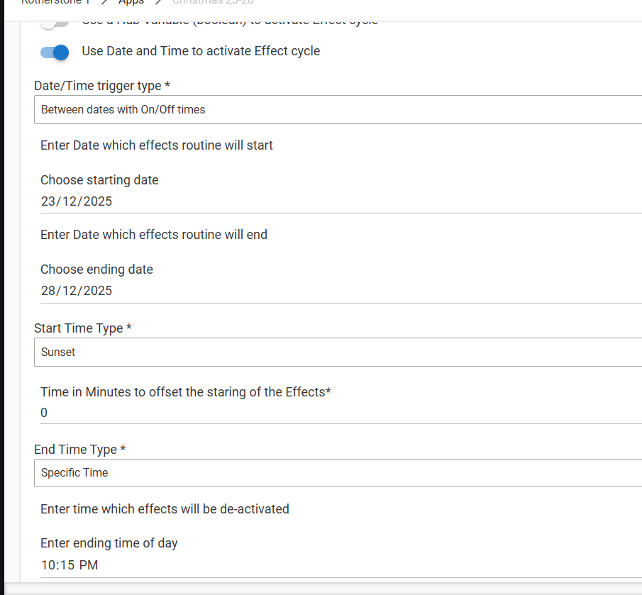

@mavrrick58 Would this be correct for new years eve to do a single effect all night until 1:15 AM?
will this just automatically happen?
Looks right to me.
Yep

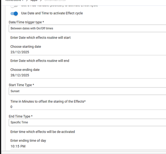

So i have this but i think it means it will turn on at the 1st date and time and go off at the end date and time? Is that right? wanted it to turn on and off between those dates.

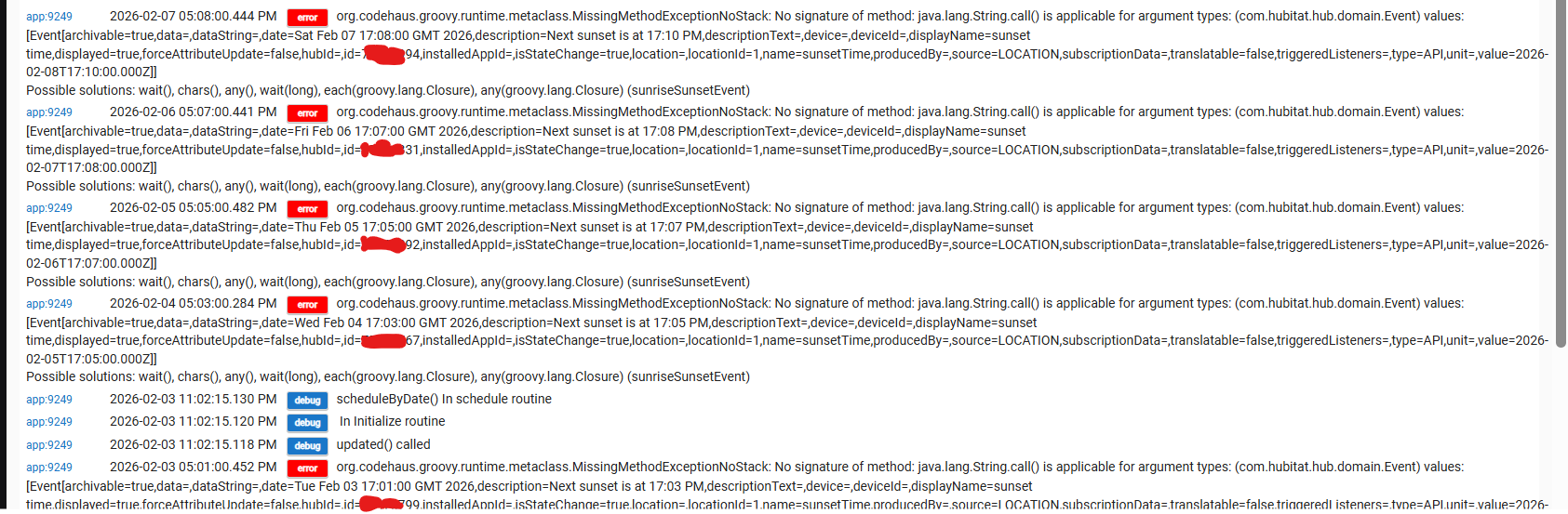

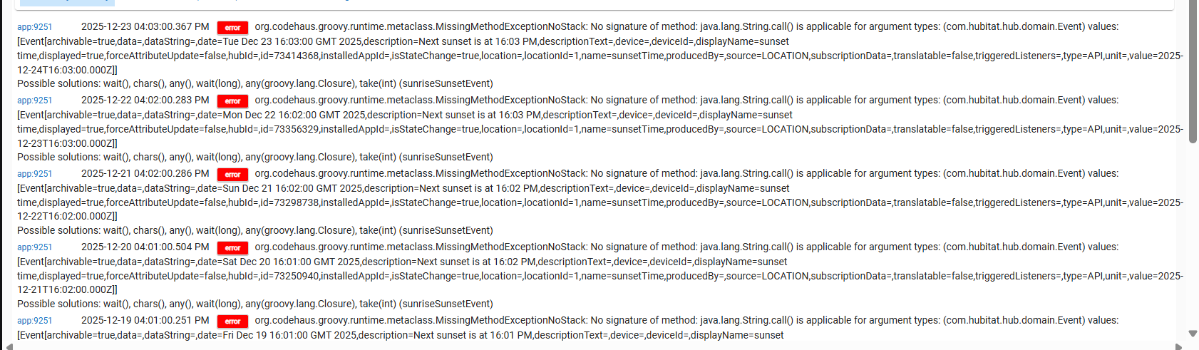

Also getting errors in the logs for another of the child apps
The date range is for the date range you want the rule to apply. The time values are the activate and deactivate times on each day in the date range specified. It will turn on and off each day in the date range.
I need to clean that up. That error isn't really doing anything. It is a unhandled event for sunset.
That's what i expected but don't think the off is working then, ill turn on debug and check.
turning on debug and saving while a event is in play, would that wipe the off?
It's currently ON from the trigger.
Currently the way the scheduler works is when you update the app it clears scheduled jobs. Then it schedules the next start and end cycle.
The logic doesn't handle if it is in the middle of a cycle. Currently you would need to trigger the off with the deactivate override if needed. I can look at adding a enhancement for this condition.

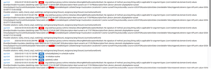

Seeing lots of errors in the logs like this?
That is something i have been meaning to fix. Simply put when i was working on the logic to use Sunset and Sunrise i setup a subscription to them, but ended up never using it. I have removed that from the active logic and you should be able to update the app to prevent those errors from occuring any more.
