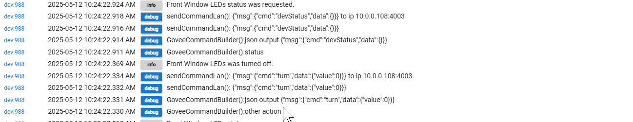

So what the logs are showing is indicating that the Hub is trying to send the command via UDP as it should. UDP is the protocol used by Govee for it's LAN API and it is a fire and forget protocol. Unfortunately that means once it leaves the hub there isn't much else that can be done from a hub perspective.
That said the recent hub firmware changes in 2.4.1 allowed me to fully implement the LAN API including it's method for retrieving status updates as well. Prior to this current version we just made the assumption that the device status updated. Now the hub submits the command and then follows the submissions with a request for the device status. That explains why you don't have the flip flop happening as you noticed with your comment about the different behavior.
Does your hub also run on the 10.0.0.x network. The device status update needs to be able to use multicasting and if your gear is on multiple networks it may have issues.

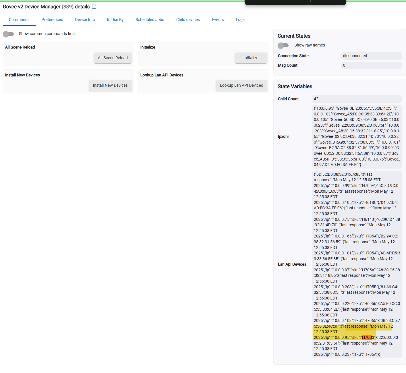

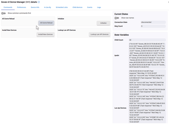

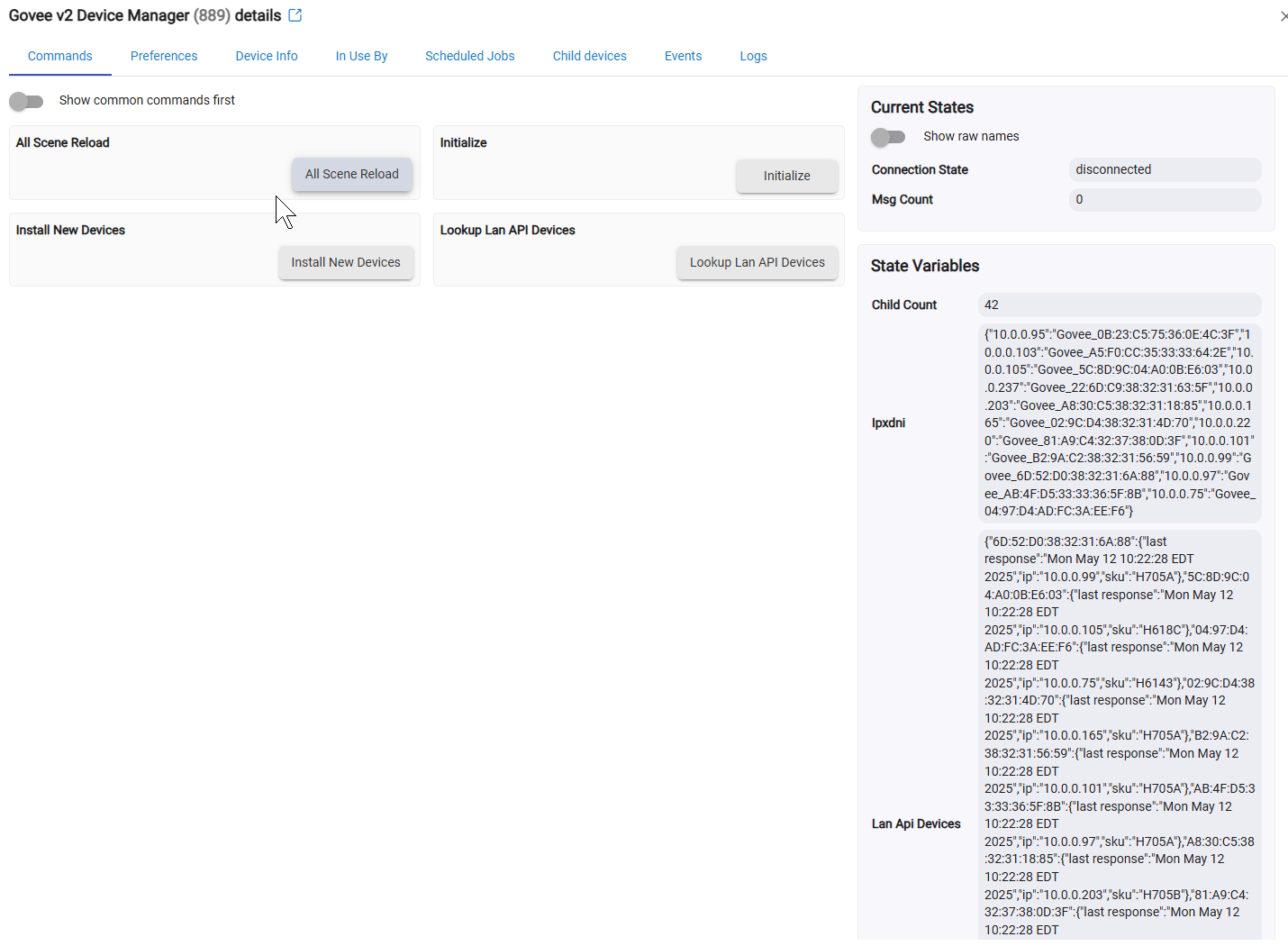

you may also want to open up the Govee Device Manager device and look at it's state values. Do you see the device in question listed under the state value "lanApiDevices". If you do, does it show with the same timestamp as the other devices detected.

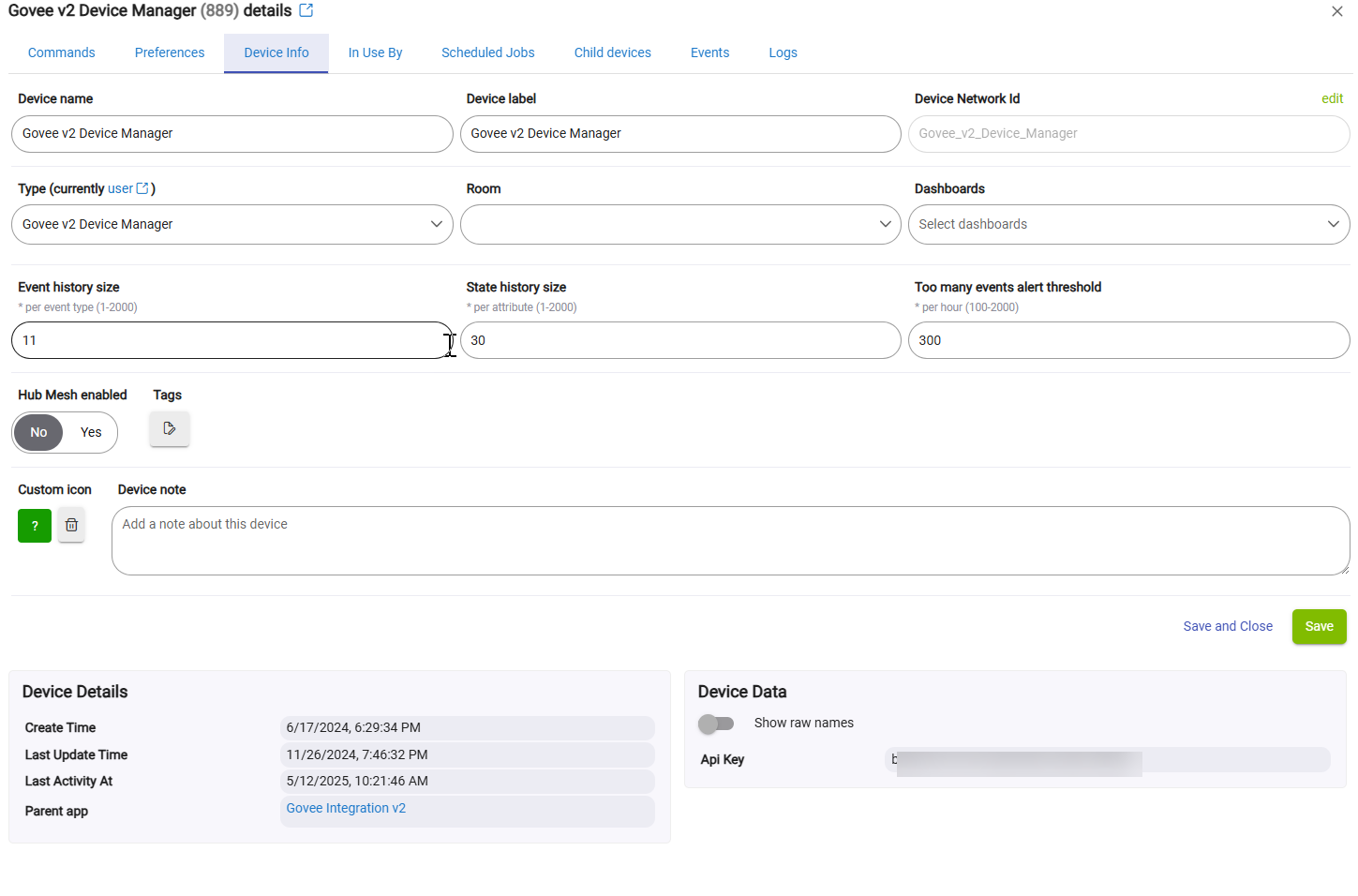

To get a more complete picture can you adjust your filter to capture the devices you are testing with as well as the "Govee Device Manager" device then set that devices to enable debug logging. The Govee Device manager device is what is listening for all of the device status updates from your network. That would give us the whole picture of what is going out and what is coming back in.
I did not see it in the LANAPI device list at first
Tested, same behaviors.
Govee Device Manager doesnt seem to be triggering any logs when issuing command to the offending device. Debugging is on. Only information from the offending device shows up in logs. Even when going to look directly at the Govee Device Manager log. Empty.
I hit Loopup lan API devices and it showed up

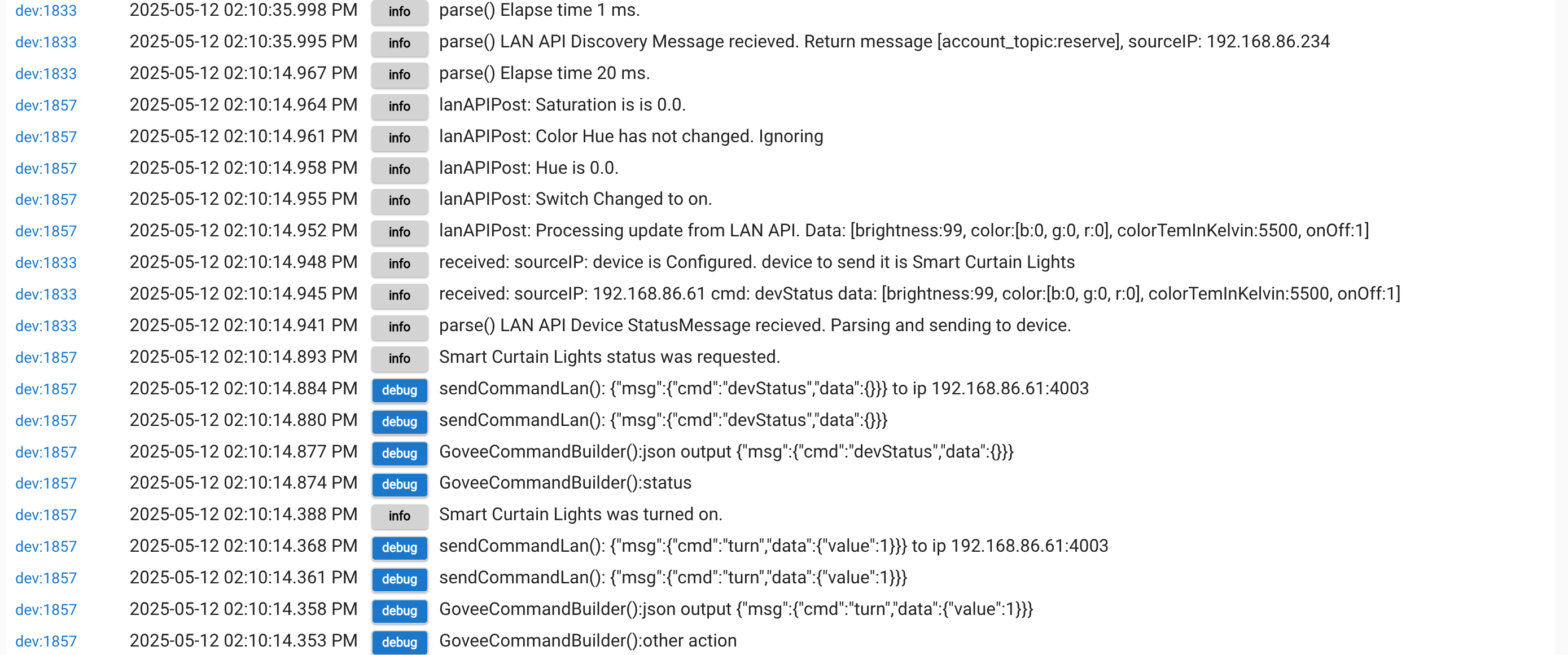

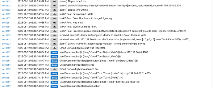

Below is an example of what you should see if you turn on debug logging for the Govee Device manager and the device you are trying to test with.
You can see at the bottom the devices start by issuing the command to set turn the light on. Then immediately following the same devices calls the devices to retrieve devstatus update.. Then above that you can see the incoming messages into the Govee Device manager. The Govee Device manager driver identifies it as a Dev Status message and you see what is passed and then what device is getting the update. Lastly you see the devices post the new status's.

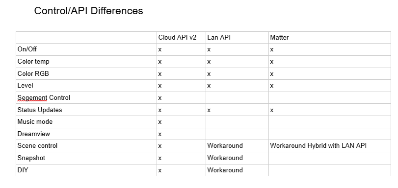

Just got my first Matter enabled Govee strip. All my other Govee strips (non-Matter) have worked great through HE using just the regular LAN control. Is there really any reason for me to use the Matter integration, or just keep doing the LAN control thing?

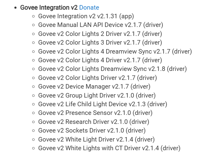

After Hubitat 2.4.1 firmware and the upgrades that came with it, It probably doesn't matter really. The below table is what I have in the Govee Integration v2 documentation.
One potential pro/con could be that the LAN API uses UDP so if your network is stretched thin you may run the risk of occasionally missing commands. I think matter uses TCP which should do better validation of send/receive. That said the most recent updates with the LAN API will in a way validate if the change was actually made.
If you deploy the driver through the normal method, but then enable local control you get the best of both the LAN API and Cloud API. Simply put it default to LAN API for all the functions it supports and then will use Cloud API when a function requires it.

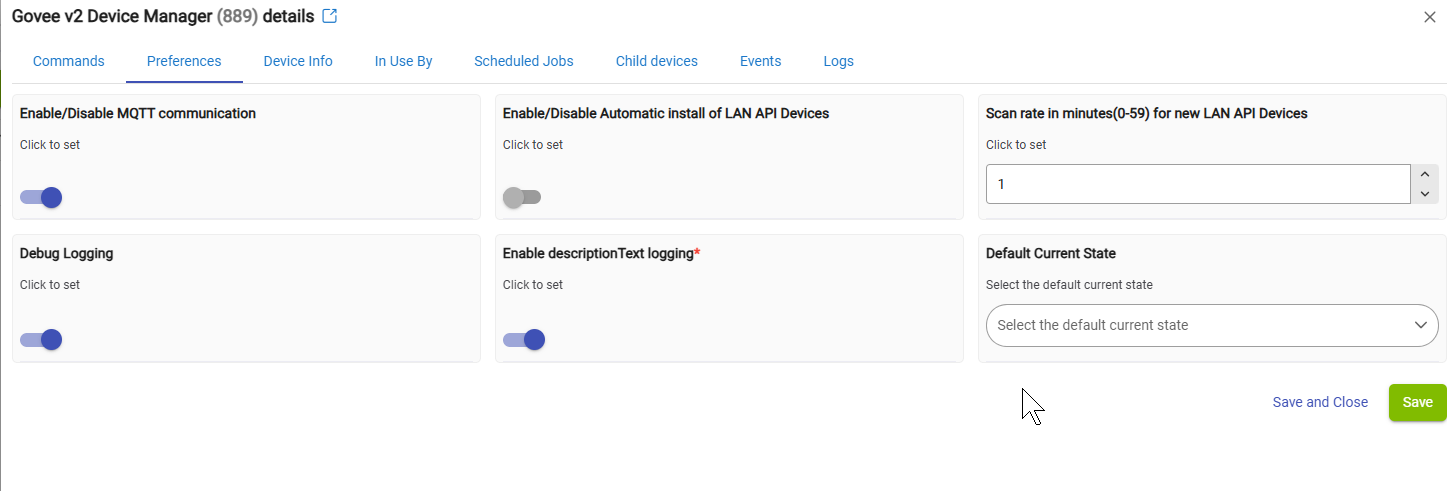

When you set the "Govee Device Manager" device to enable logging you should see allot of logs start to flow in with it. That device receives all updates for all Govee Devices that use the LAN API. It also fairly regularly sends out a scan of the network to look for new Govee LAN API devices, or update existing ones if the IP has changed.
Please make sure the Debug is turned on for the "Govee Device manager" device and the problematic one and then open up live logging and filter based on those two devices. Then run through trying to create the problems and send me all the logs. If you need to feel free to send me a DM with it.

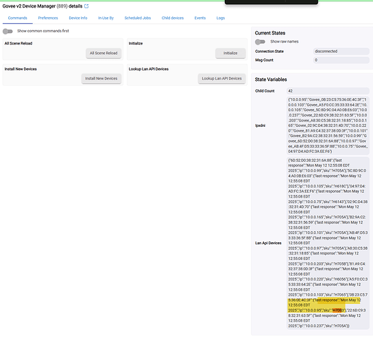

What could be a interesting search to is once the Debug Logging is turned on for the "Govee Device manager" go to the logging page and simply search for the device id of the problem device.
You would see something like this.
My Govee Device manager is set to scan every 1 min. You can see here that the results for this device are returned consistently every min. If you compare the interval for these responses to what you have your Govee Device manager preferences for "Scan rate in minutes(0-59) for new LAN API Devices" it should match pretty closely. If it doesn't then you are loosing commands being sent to the device. You may want to add another Eero at that point.

Does the devices appear in the "Lan API Devices" state values for the "Govee Device Manager" device as shown in one of the images above?

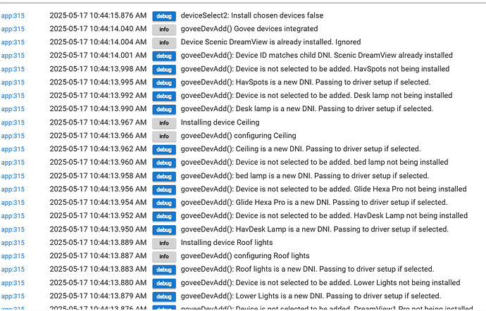

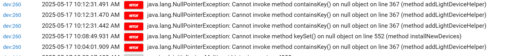

Can't get the v2 working on my end, would appreciate any help! :smiley:
Context: I did see I had v1 from a while ago, but I don't think I was actually using it. I've since uninstalled v1. I've also tried reinstalling v2. My HPM is up-to-date as of today. I haven't touched the LAN API at all, assuming common light stuff would be supported natively/cloud.

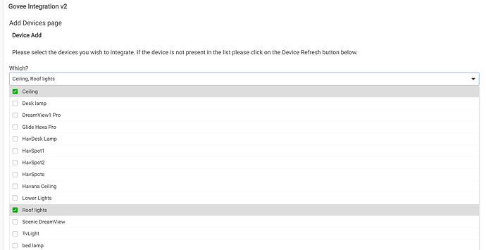

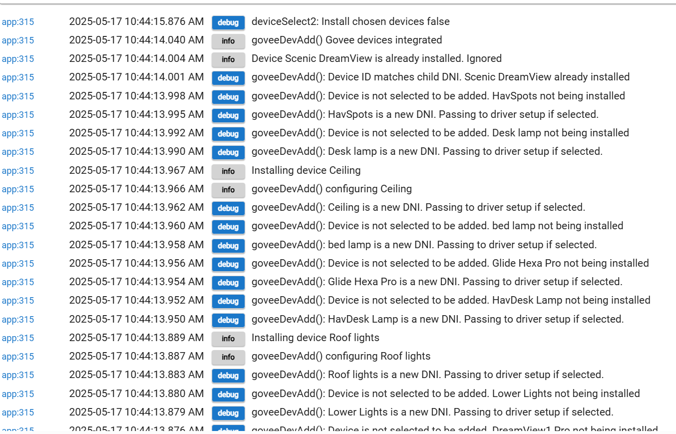

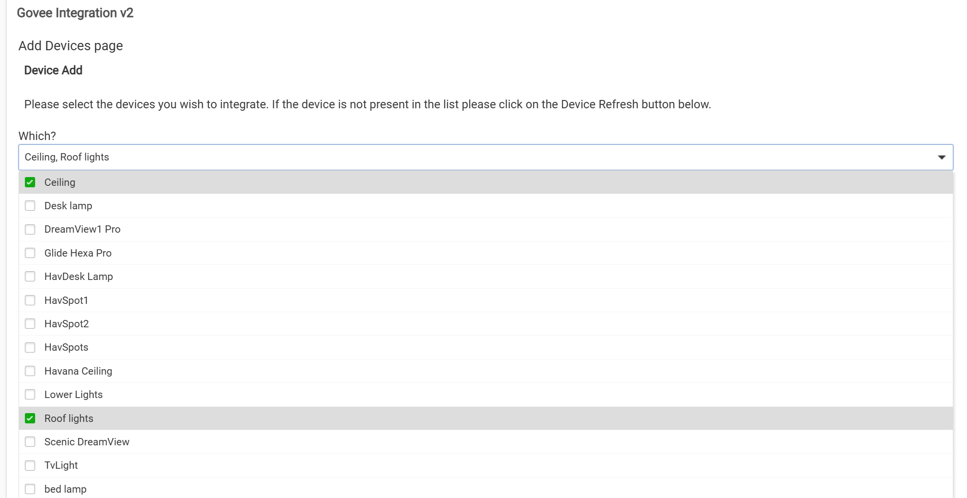

I can see all my devices, which is about a dozen various bulbs, spotlights, permanent outdoor lights, dreamview, all standard stuff I'd say. I select one or two of them to install.

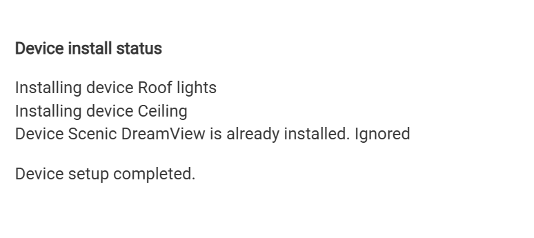

It says 'device installing' and seems to proceed without error. However, they never show up in the Device Manager/child view. Looking into the logs, I do see this error:
java.lang.NullPointerException: Cannot invoke method containsKey() on null object on line 367 (method addLightDeviceHelper)
This seems like a hopefully simple issue, but for the life of me I can't figure out how to resolve. Any tips? Many thanks for the work, I sent a donation last evening before I even got to trying it out. :smiley:
