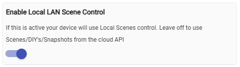

Can you confirm that this is the option you are referencing
When that is turned on the device driver references a local file to use to identify the command to be passed for the device via the LAN API. When it is turned off is the driver reverts to the cloud api for the Light Effect control. Since those are brand new devices and don't really have a Local LAN file generated it is likely that the driver is failing to find a the local file and then is just erroring out. I would be will bet some money you would find error messages in the live logging to that effect.

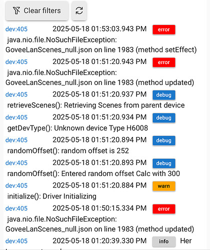

Yes that is the setting I’m referring to.

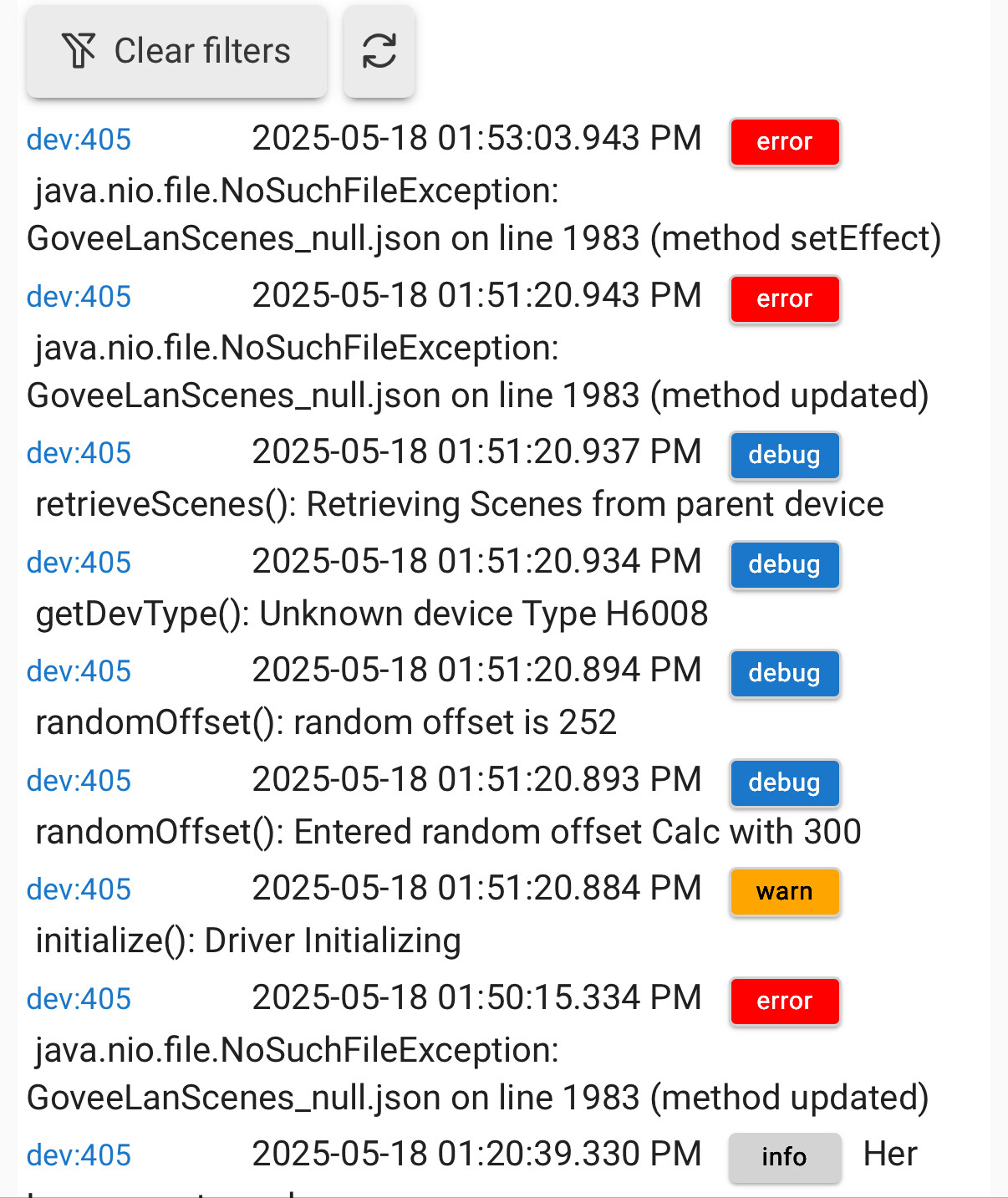

Yes the file that it inputs when the setting is turned on is GoveeLanScenes_null.json.

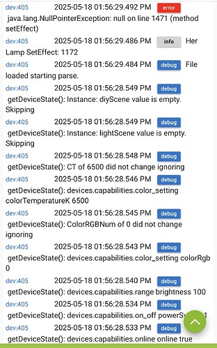

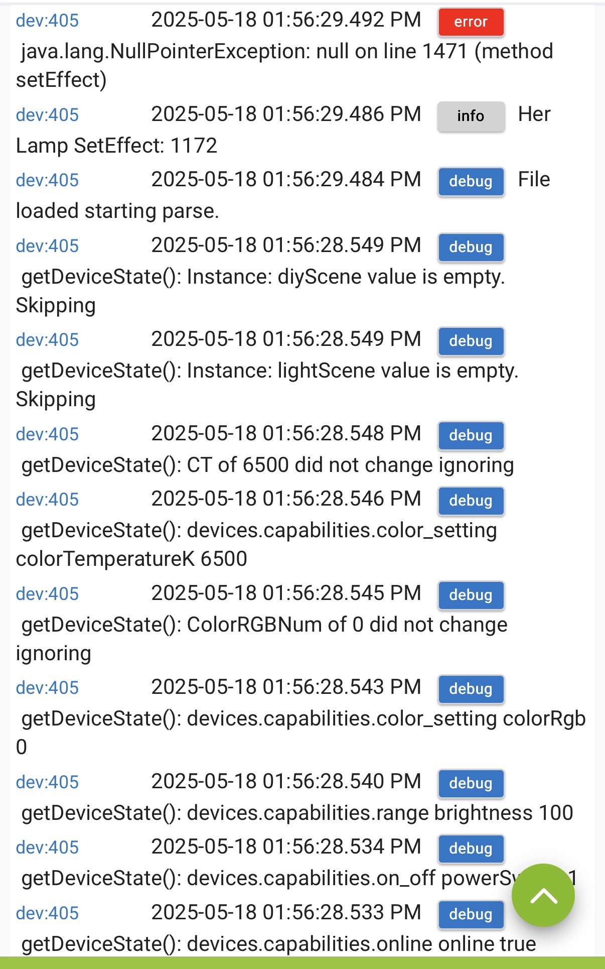

These are the logs when I try to run a scene with the GoveeLanScenes_null.json file.

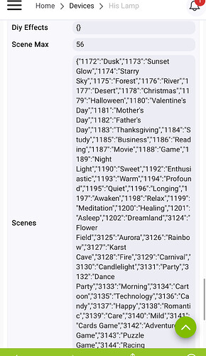

I followed the instructions you listed and the file name changed to GoveeLanScenes_H6008.json but unfortunately still do not work, after I pasted the new file name, saved and initialized. I don’t know if it helps but the scenes were listed in the state variables with either file name I used. They are listed but do not work when setting effect with either file name.
These are the logs I get when I try to set an effect using the new file name GoveeLanScenes_H6008.json

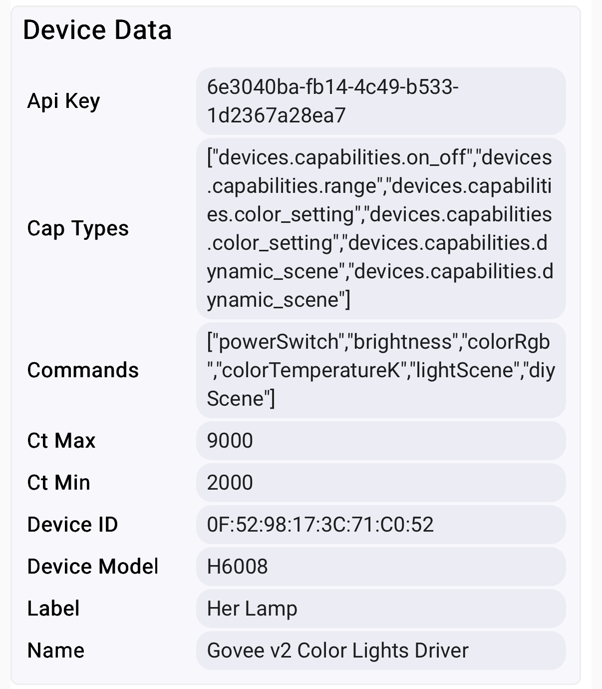

This is the device data section

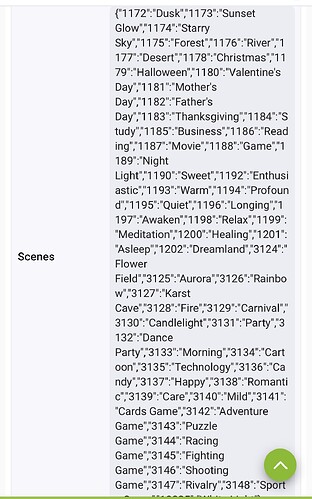

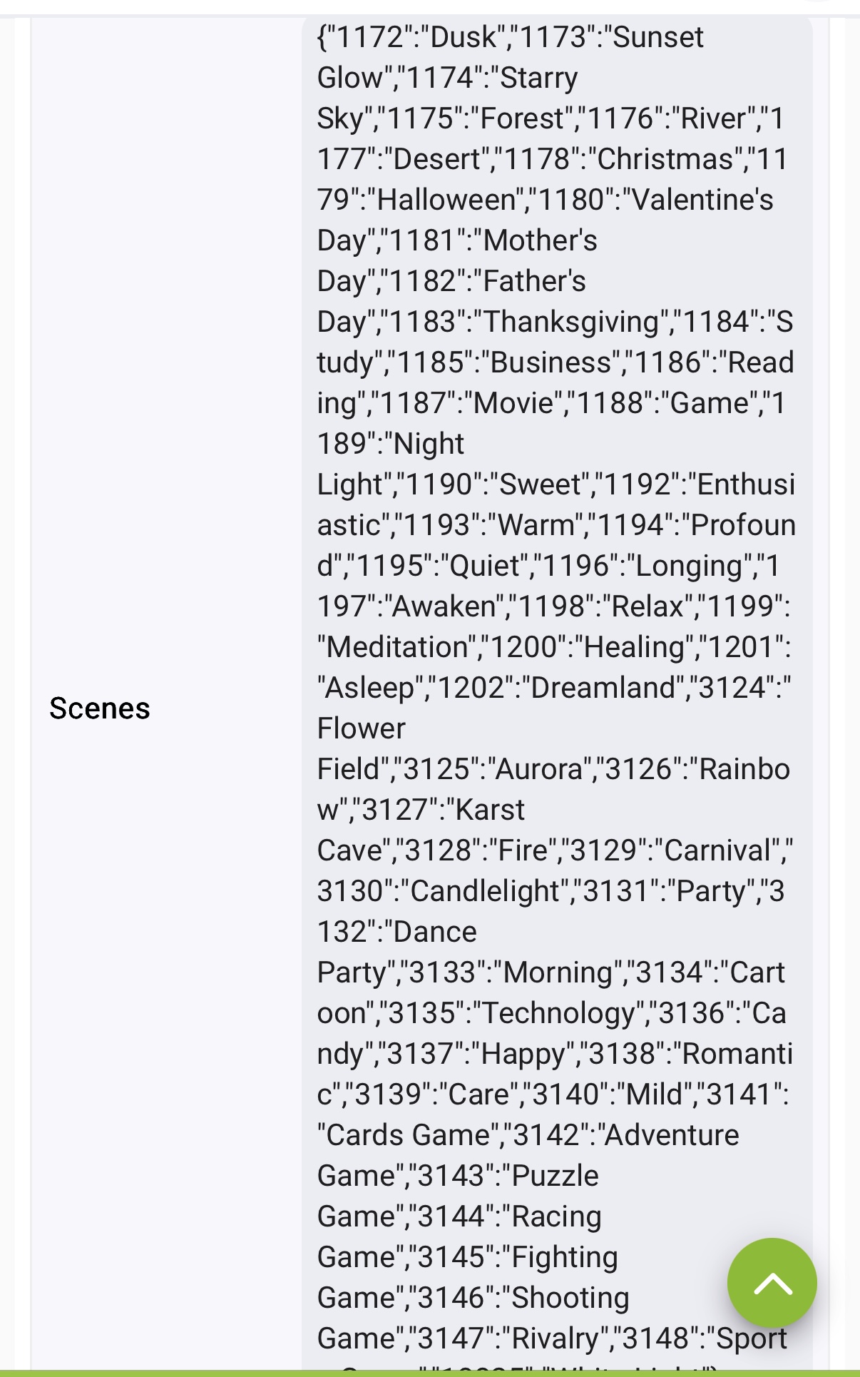

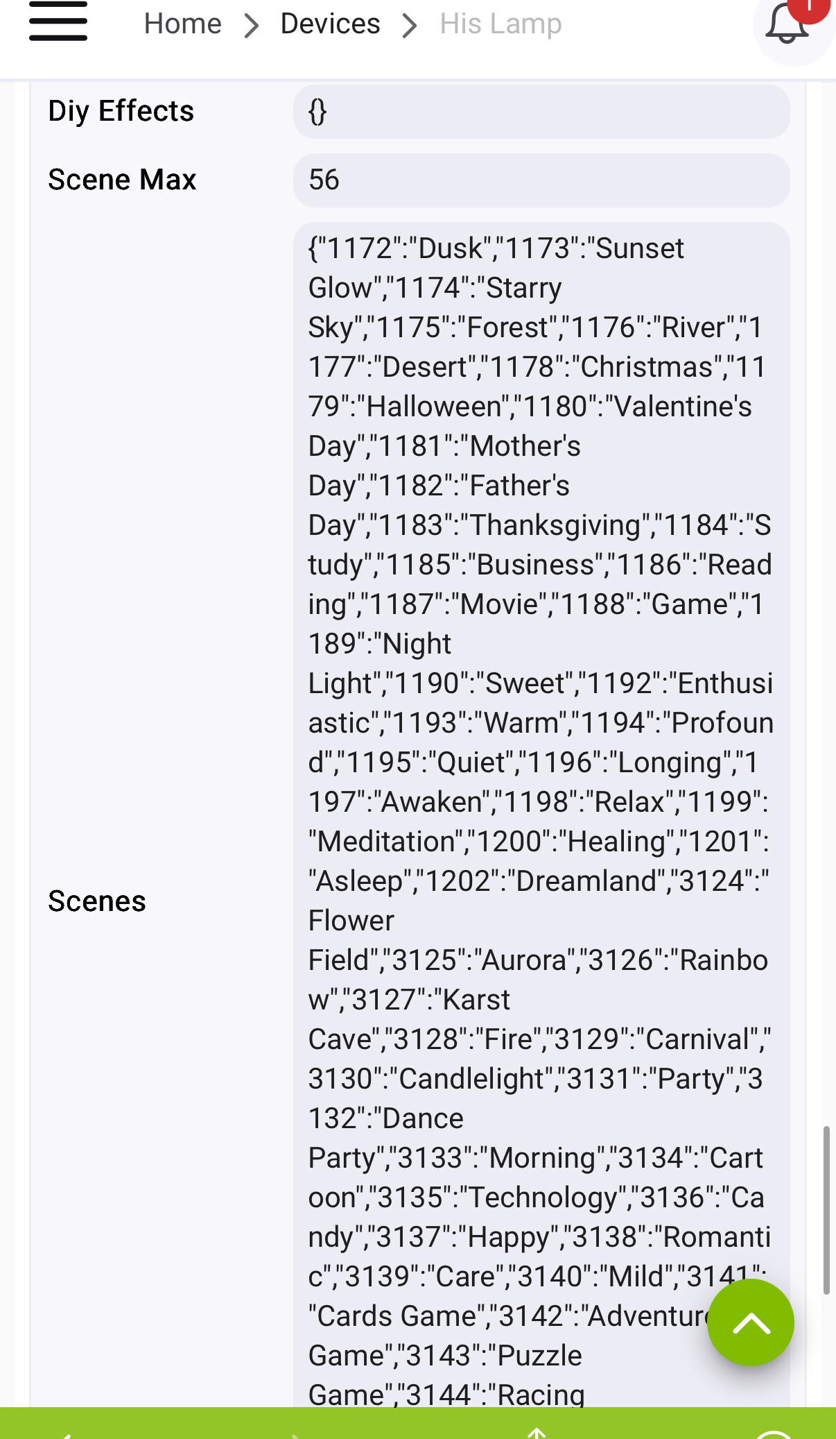

Here are the state values.
Yea, it’s nice to see lan control added. I have a Govee h6003 bulb that doesn’t support lan. I hope I’ve provided the correct info and enough to help get it sorted out. As for now, I’ll leave lan scene control off and continue to use the scenes through the cloud api
Those numbers for the scenes indicate that it still has the scene numbers from the Cloud API. The it would start at 100 and go up from there if it was using the generated Scene file.
I also see a few things that don't quite match up. Can you make sure you are running the latest version of the integration. Maybe just perform a repair in HPM to be sure you are on the most recent batch of code.

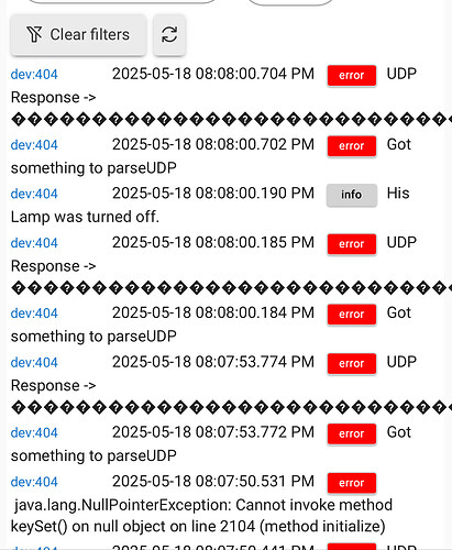

I did a hub reboot and still none of my Govee devices are working with lan enabled. This is the log

After that initial unmatch and rematch then repair all of my Govee devices stopped working (not just the H6008 bulbs) on the lan and those logs above are what it was logging. I started to try and figure out why so I did another unmatch and rematch and all of the Govee devices started working on the lan again but the original problem of the new H6008 bulbs not setting scenes on the lan is still happening.

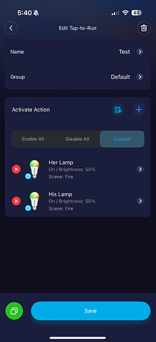

Not sure what device you are running, but it looks like Govee Moved the Tap-to-Run's and renamed them to be under short cuts. This means the documenation isn't 100% accurate anymore. Simply put to to create the tap-to-run/Shortcut card perform the fallowing.
  1. open the Govee Home app.
  2. Select the icon across the bottom second from the left next to the Home icon. That will put you in the shortcut/autorun screen.
  3. click on the icon in the upper right with the 3 squares and diamond
  4. Now select "Tap-to-Run" and you should see an option to create. Click on that and setup the action. You may need to specify a custom action as it looks like by default it just does on/off for the standard action.

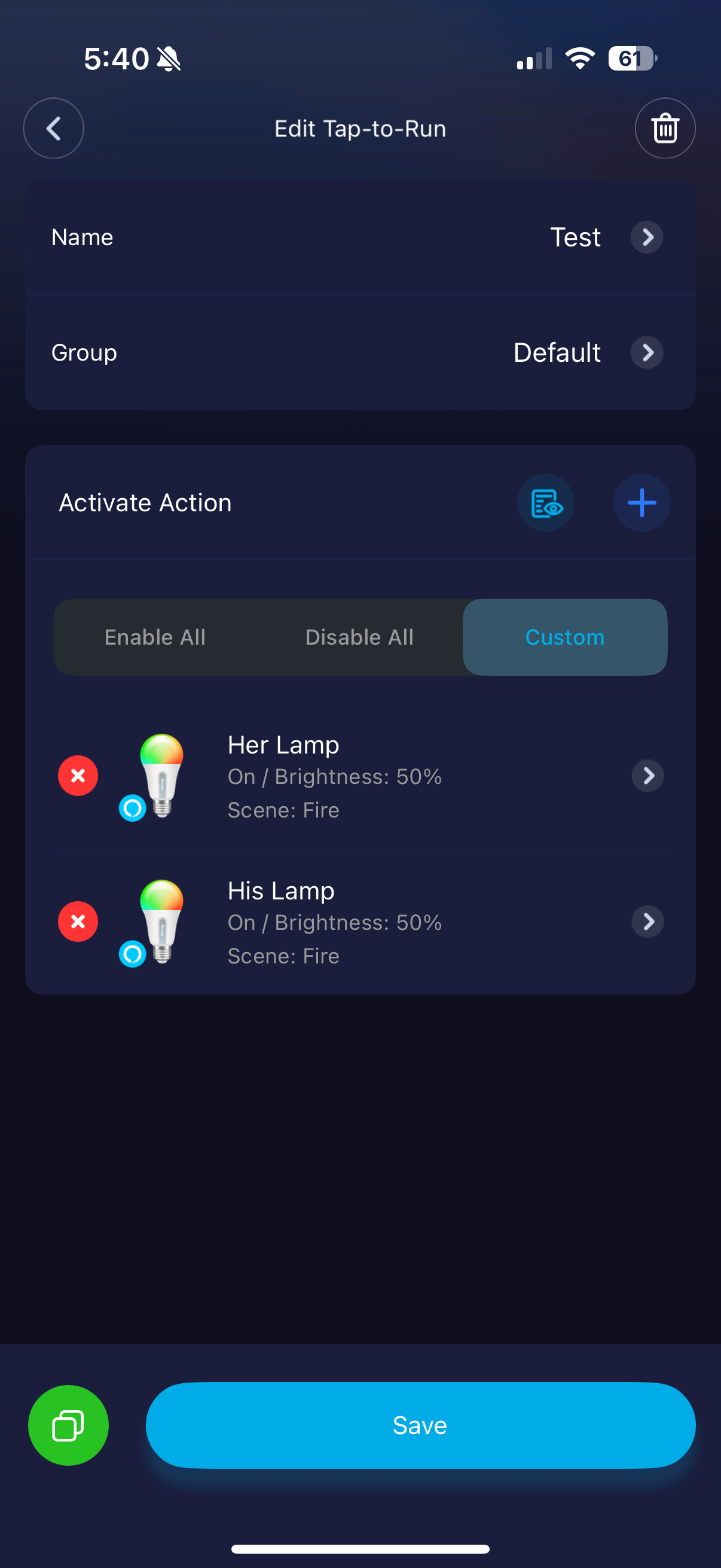

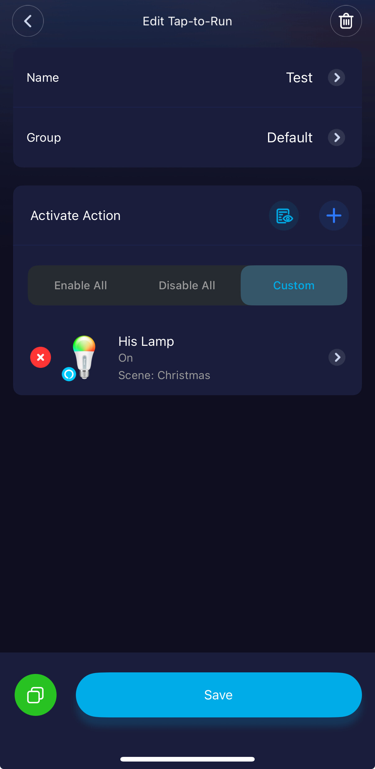

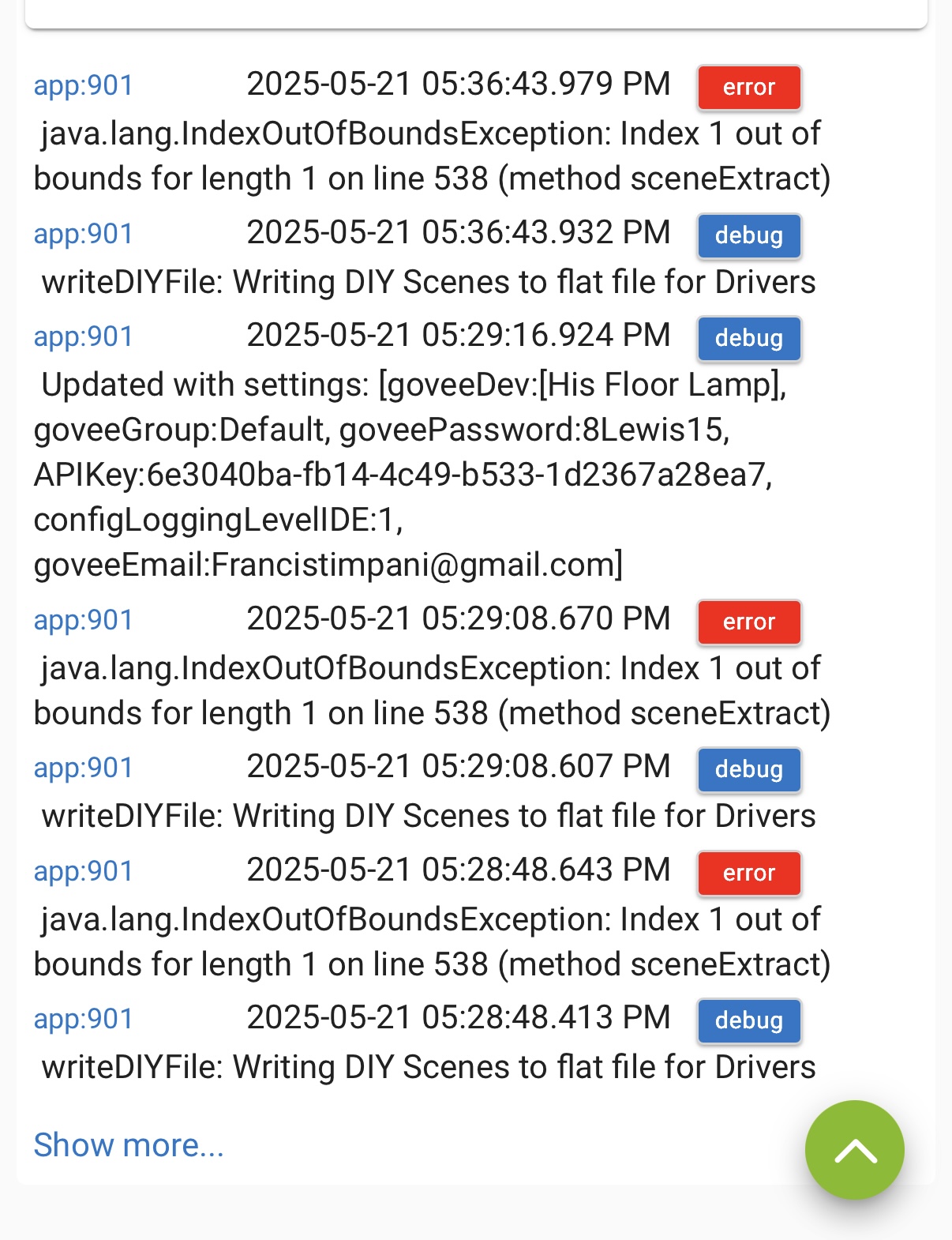

So, I created a tap-to-run in the Govee app with one of the Govee scenes.

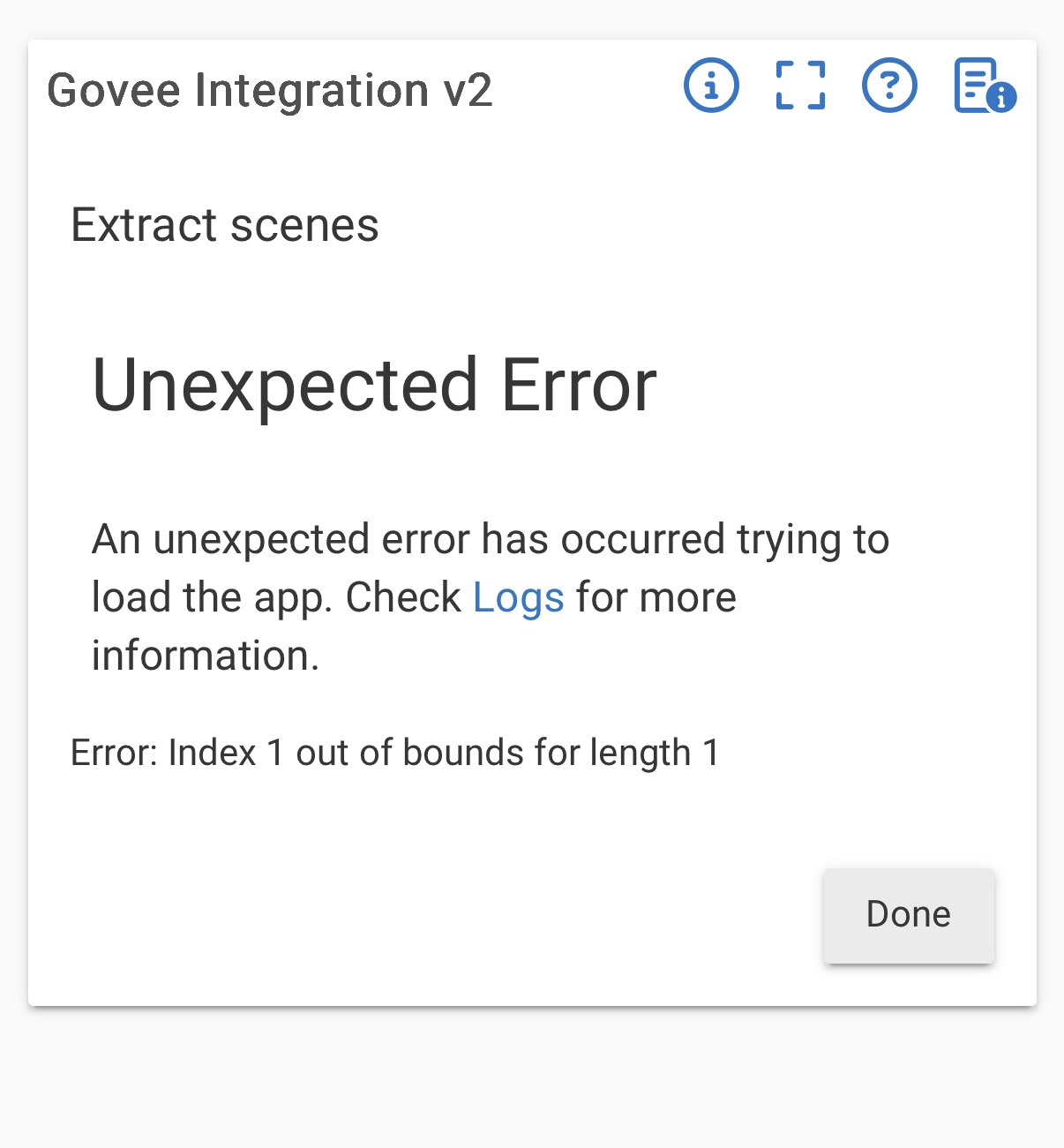

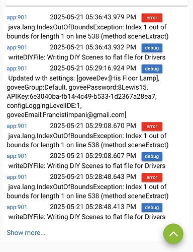

Both H6008 bulbs have lan scene control turned on in Hubitat currently. I went to Govee integration and to scene extract. I received an unexpected error, it did not find the scene from the tap-to-run.
This is the log it produced when I tried to extract the scene from tap-to-run in Hubitat.
I then turned off lan scene control in Hubitat (leaving regular lan control on) and attempted to extract the scenes again, same result as above.
I thenl created a DIY in the Govee app for the H6008 bulbs.
  • In Hubitat, if the lan scene control is off it will pull the DIY right over into Hubitat, even without using the scene extraction, just a scene load command and the DIY is there.
  • if the lan scene control is on, Hubitat will not pull the DIY over at all.
So, DIY’s kind of work as long as lan scene control is turned off and it pulls the DIY from the cloud api. If lan scene control is on it won’t pull the zDIY just as it won’t set a scene while the lan scene control is on.
But nothing changes with the scenes when I set a tap-to-run to a scene and try to extract it to Hubitat, it gives that error.
I hope this helps you diag and let me know what else you need to help further.

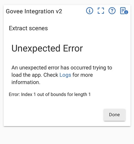

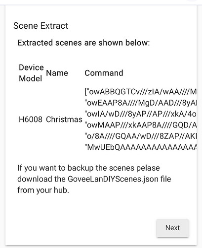

Update: I was able to get the Govee integration to extract a scene from tap-to-run for the H6008 bulbs but when I go to the device is in Hubitat I can’t get the tap-to-run to show anywhere. I press load scene, refresh the device but whatever tap-to-run that was just extracted doesn’t show in scenes or DIY’s.
I know I’m probably confusing you but it’s hard to explain

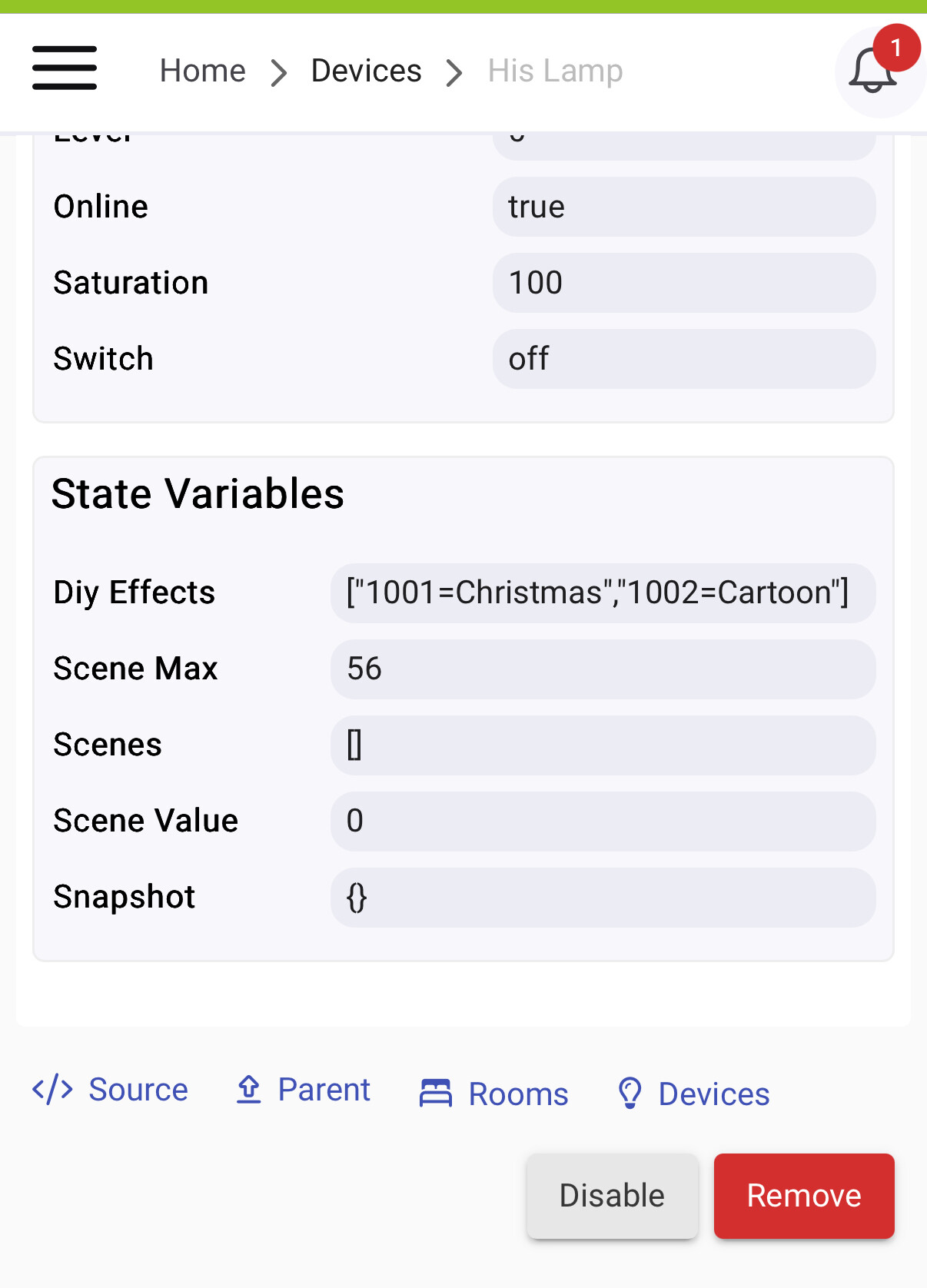

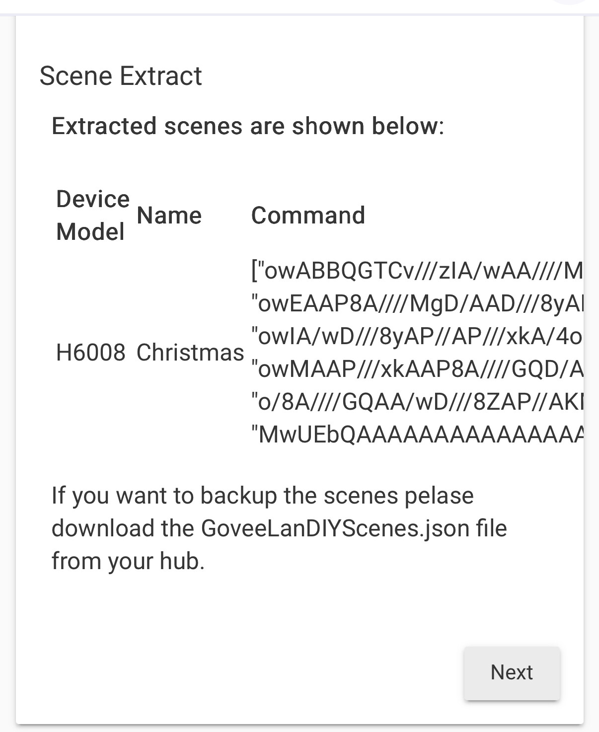

This what happens when I try to extract a tap-to-run I created in the Govee app that uses the Christmas scene. Hubitat it extracted it but I don’t see it in the state variables anywhere. The “1178 Christmas” scene is in the state variables but that has always been there and doesn’t work with lan scene control on. I’m not sure why I don’t see the tap-to-run Christmas scene under the DIY section or anywhere else.
If I use this GoveeLanScenes_null as the lan scene file name the tap-to-runs that I created show up under DIY but the Govee scenes disappear. The tap-to-runs work.
