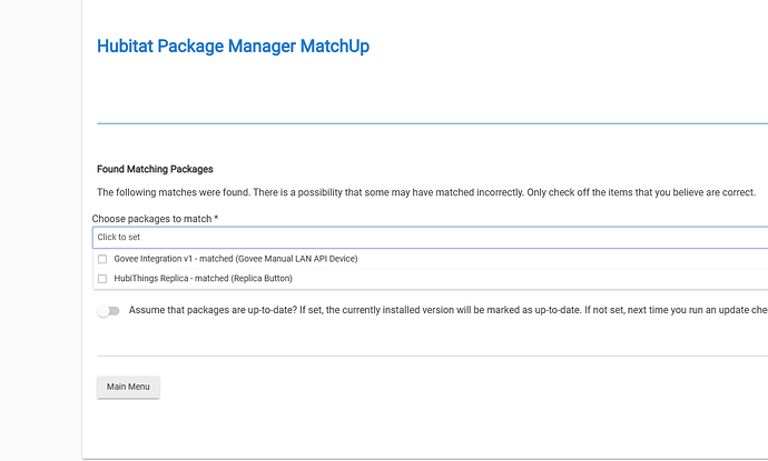

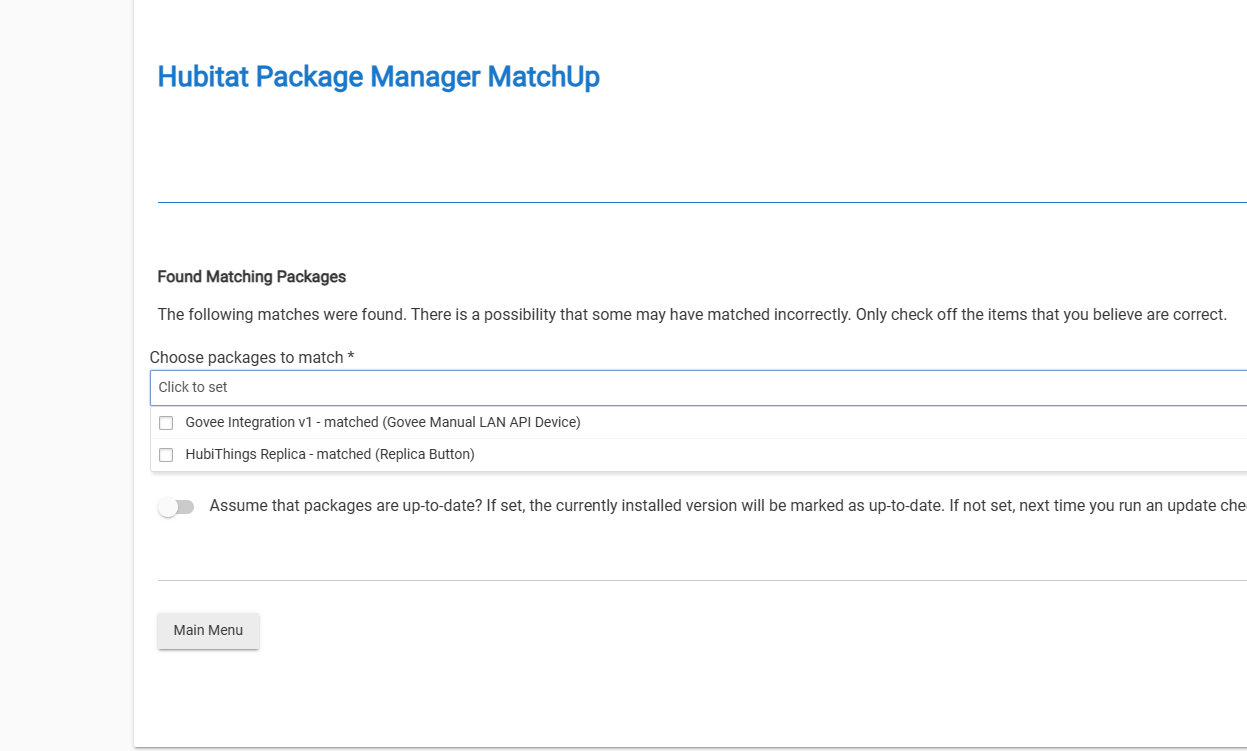

This has caused me to do a bit more digging and it does appear that for some reason the "Matchup" Function of HPM to the Govee Integration V2 doesn't seem to function. My guess is that it is some how related to everything being packaged in a bundle vs the app and drivers being their own objects.
I just completely cleaned off my dev hub and remove the Govee Integration from HPM. Then i did a clean install from my bundle file and tested the match up. What it found was what is shown below.
What it found was the Govee Manual Lan Driver which is part of the Govee V1 integration as well. Is that what you are seeing when you are saying it is matching to the Govee Integration V1.
Now the good news. Bundles are designed to be installed overtop of themselves. When a bundle is installed overtop itself it will simply overwrite the same objects. If you have Govee Integration v2 installed manually you can just install it again from HPM and it will overwrite the bundle that is present. You will not have any duplicate items show up. It also won't break your current install either.
